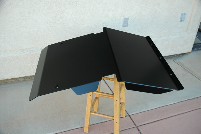

    Yes, no problems per se. With the auto, obviously you will need a cooler, be it in the radiator or a stand alone. There could be mounting bracket holes slightly off and the existing shroud may not fit. Nothing a little plastic cutting wont cure. IIRC one fellow just left the "clip on" strip at the bottom of the fan opening off, and all was well.
    It is not uncommon for folks to go with the shorter ones for better approach angle with a custom front skid. With an OE 4wd man trans radiator a custom skid plate can immediately slope back instead of dropping straight down a few inches first.

    All I have is the plan for the pictured skid.
