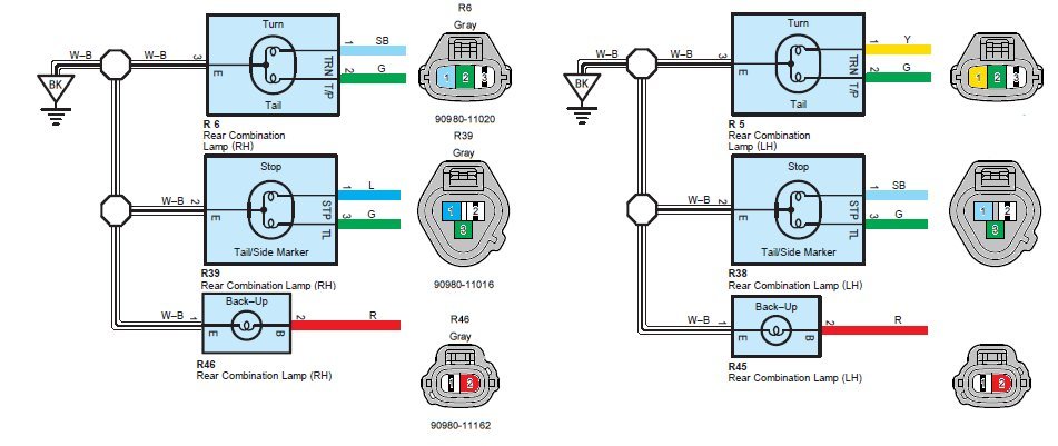

    Looking for instructions how to install one of these. There’s a red and a black wire which I assume red is power and black is ground. I also think I know that I need to tap into one of the reverse light bulb pair of wires but which is which? This bar came with zero instructions and an email to Tacoma Lifestyle fell on deaf ears.
    Any help appreciated!

    Thank you!
