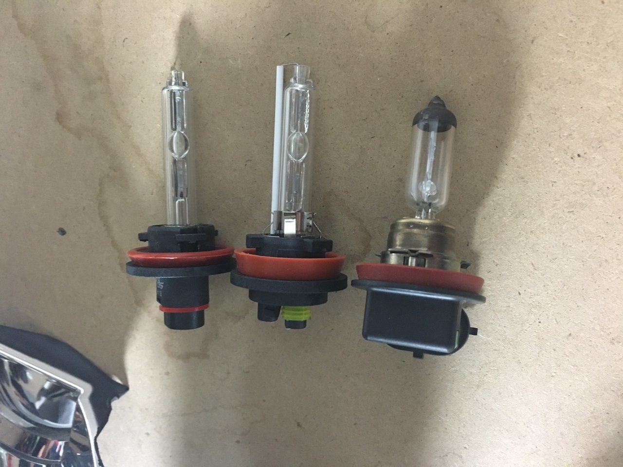

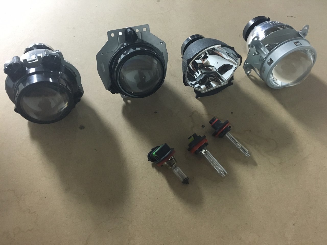

    We grabbed a few different styles of Halogen H11 projectors like what the '16 has as well as a few styles of H11B HID bulbs to test out. The only thing we could find here is that if you apply serious pressure on the bulb in a certain direction, you could get the rubber grommet to flex a bit and allow the bulb to flex a bit in the socket. Certainly nothing major from what we saw though.
    One thing we did find is that the distance between the back of the splines and the front of the rubber grommet is actually closer on the HID bulbs than it is on the OEM halogen bulbs:
    This would increase the pressure of the bulb in the socket causing the force to be even more required for any sort of flex in the socket.
    Having said that, we can request the manufacturer increase the density of these grommets on future shipments to minimize the "socket flex". For anyone who wants to get the new model, I will make a notification that they are available to find any interested parties. Replacements would be shipped free of charge.
    We admittedly don't have a '16 Tacoma handy here yet, but are working on sourcing a headlight to use for testing.

    If someone set this up for you, you'll just be receiving the same exact bulbs. PM inbound!
