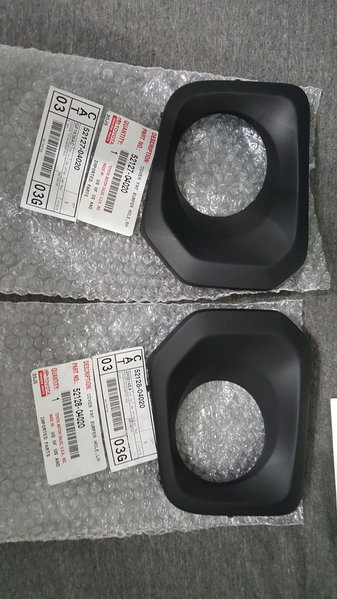

    Christmas came early lol, let the operation MORE LIGHT COMMENCE! Got these bad boys from the dealership on the way home. Now I wonder of @TRSAndrew will do a group buy on the led fogs? Or if they are going to have any black Friday deals or holiday deals?

    Just ordered a set of XB Fog lights for my 2016! Thanks @TRSAndrew for the sweet deal! Also just got my Fog light bezels in from the dealership the other day so all i need is a wiring harness and switch for the truck!
