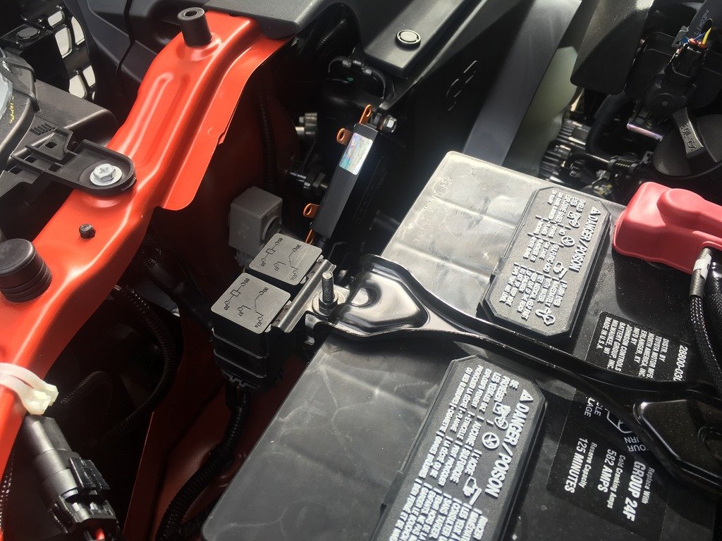

    I drilled it out a hair more to enlarge the hole so it would just drop down on top of the battery and could be tightened down with the nut that holds the (mast?) in place.
    If you are going to do it, might as well do it right since I assume you want to keep the lights for a long period of time and tape won't necessarily hold forever. All you need is that thing to come loose and either somehow end up in your fan belt or dragging below the vehicle if it shakes loose.

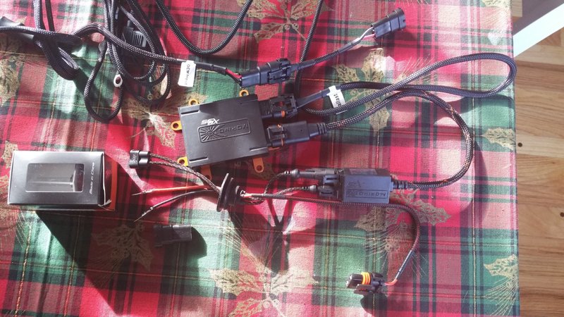

    Hey guys I have my hid kit and getting ready to install it. But before I just jump in I have a few questions for those of you who have done this.
    The orange and black wire with the single pins and connector, what does that go to?

    just pull them out. they aren't needed for the install since the other connector just attaches direct to the bulb

    yes, mine was on the passenger side that I taped up since I mounted my relay on my battery holder (so because it was closer thats how I did mine)

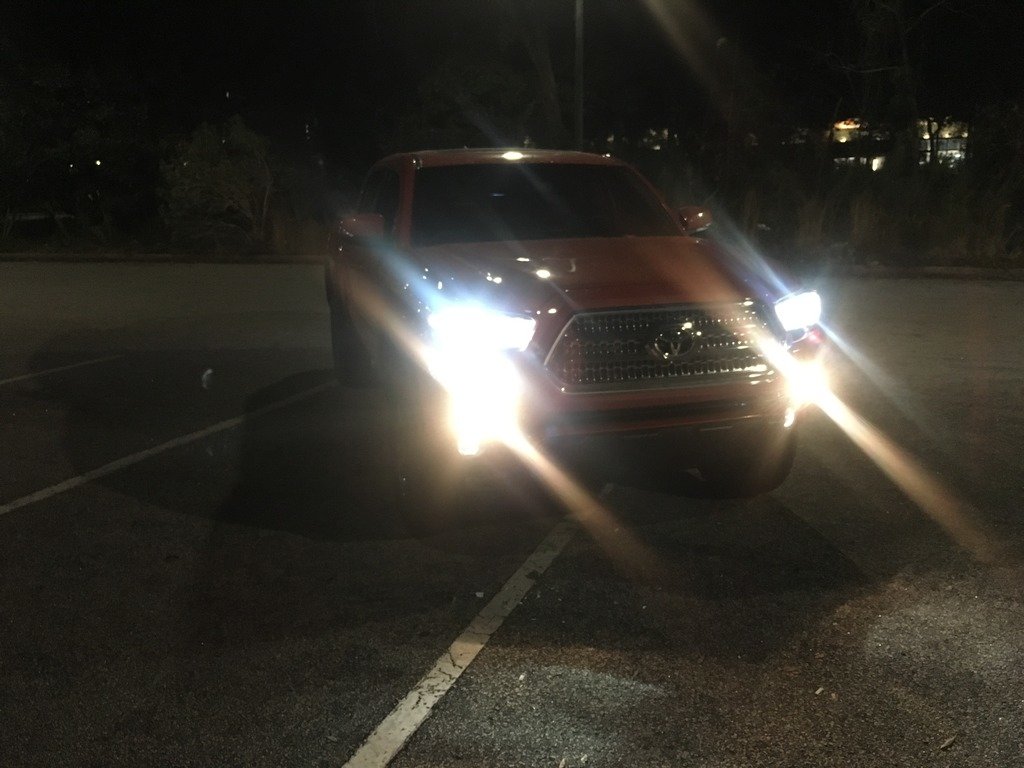

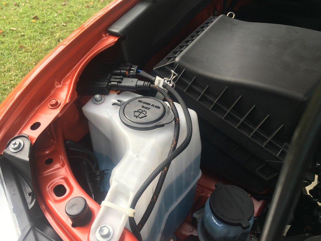

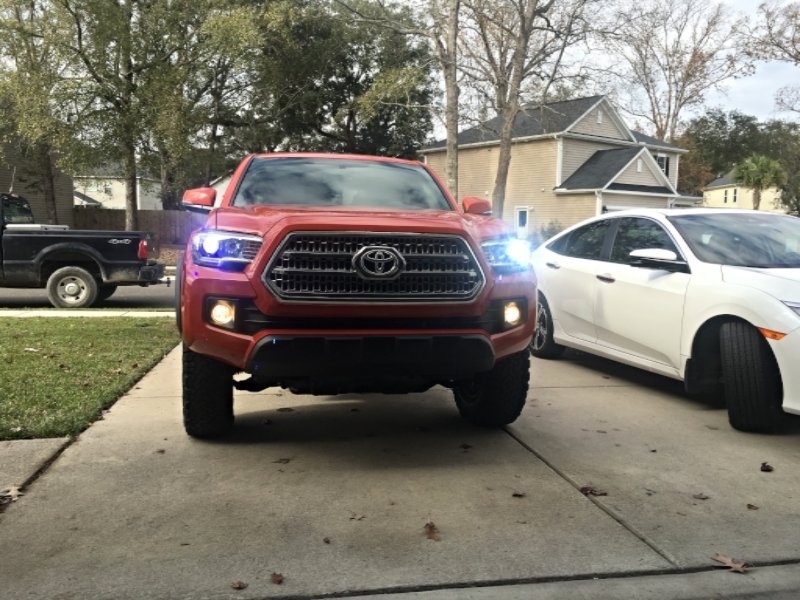

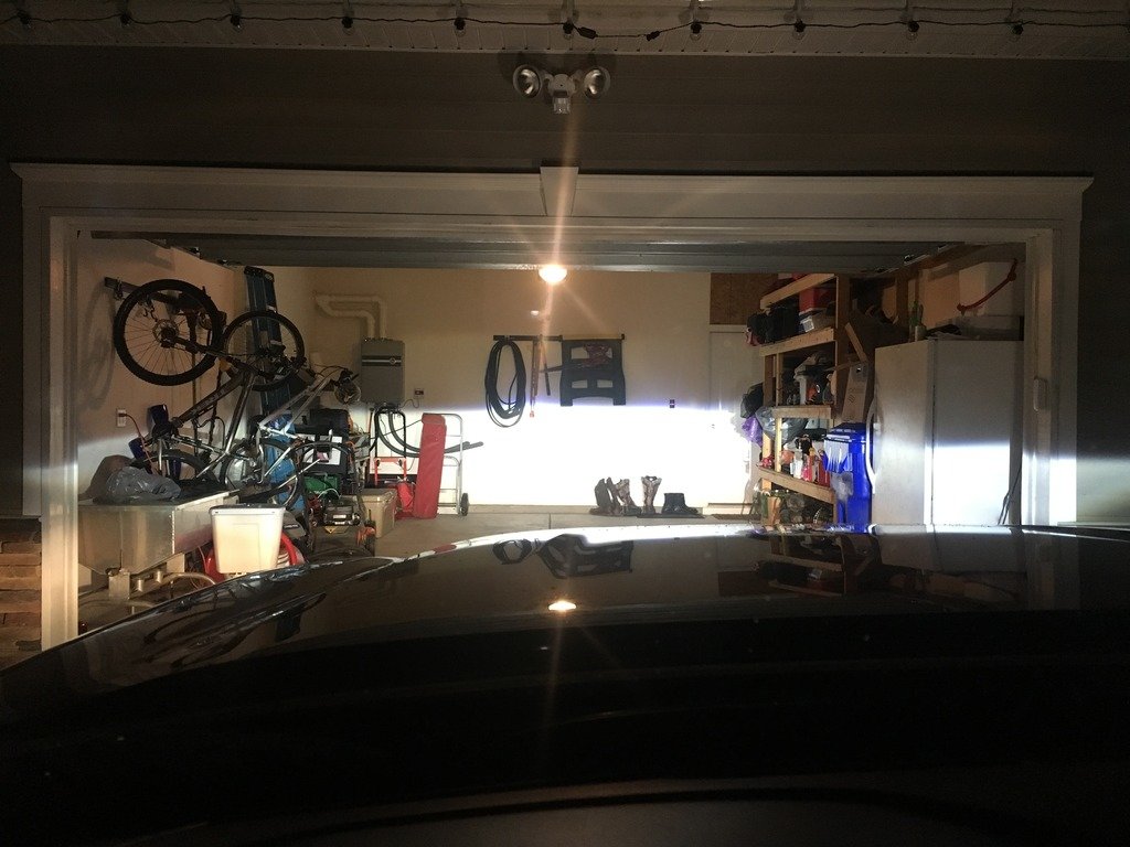

    Ok I installed my TRS HIDs today and included a few pics. Install went about as error-free as possible. Took my time and tucked some wires away so its clean and looks pretty factory under the hood. No noticeable knots of wire. I'll have to wait till tonight to report any bouncing of the lights but the bulbs themselves went in just like the OEM bulbs. Nice and tight. These are the 6500k on the 35w ballast.

    I am new to looking into new bulbs and stuff. Are these the bulbs you got?
    http://www.xenondepot.com/H11-LED-headlight-kit-p/h11-led-hl.htm
    http://www.xenondepot.com/h11-h8-h16-philips-Ultinon-LED-Bulb-p/12834unix2-h11.htm
    If so, do the headlight LEDs cover low and high beams? Sorry if this is a dumb question.
    Also what do you think about these? I have read some bulbs shaking on rough roads and stuff. Do these have to hook up directly to the battery as well?

    No bouncing I can see. Everything turns on and off when it should. Looks good to me. Slight blue tint.
