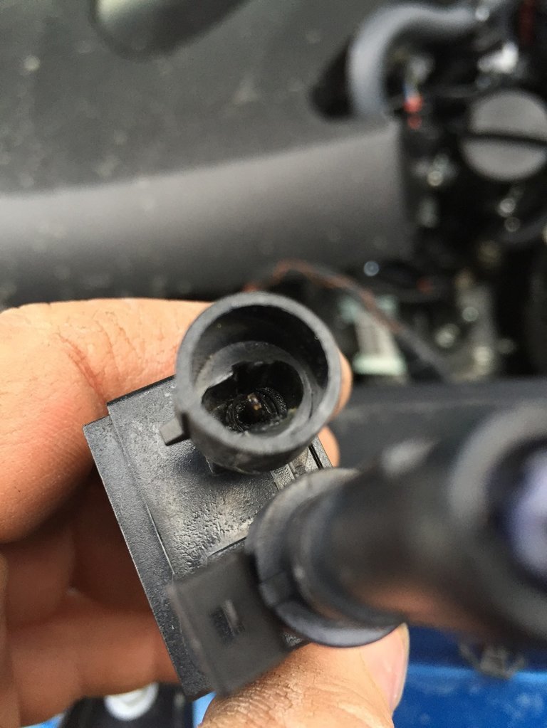

    I've had it apart about 100 times trying to get it to work in the last couple months. If i plug and unplug the power into the ballast 3-4x the light will work

    Its not a relay issue. I can connect/disconnect the power wire at the ballast and the light works. This means the relay must be turned on. Bought from theretrofitsource.

    I had a problem like this but it was the connection at the bulb. Swap only the ballasts side to side. If the issue stays on the same side then it's a wiring or connection issue on the ballast side of the wiring. If the problem follows the ballast then it is most likely defective.

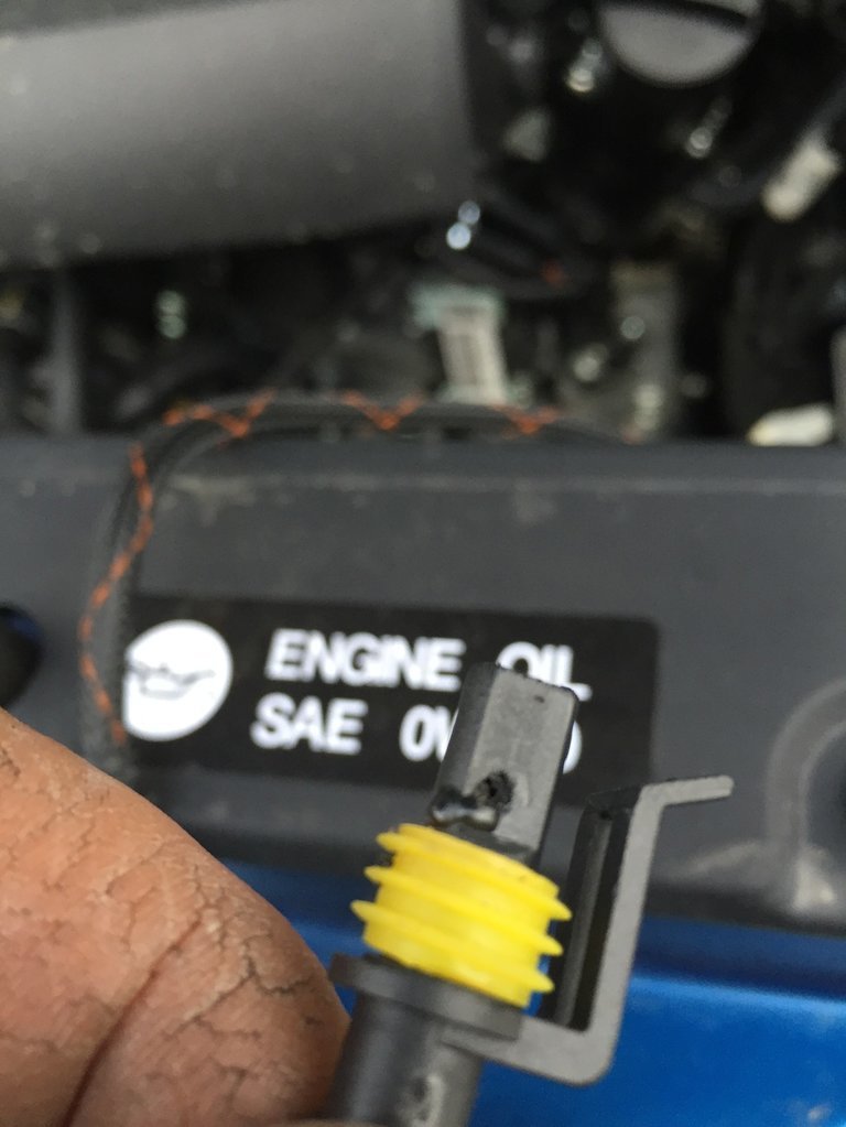

    Found the issue

    That sucks. A bad connection that over heated. Contact TRS for a replacement. They should respond in a couple of days.

    I had to order bulbs to get the sub harness that's melted on mine. I'll make someone a deal on just the bulbs
