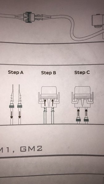

    By being backwards the terminals wont lock in place, when correct they should snap in and not be able to pull out
