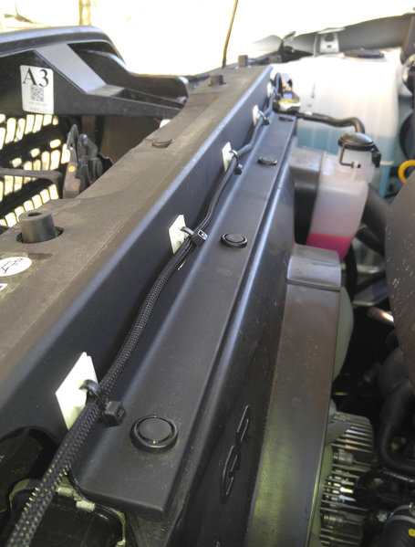

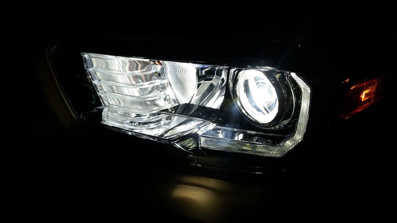

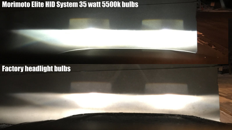

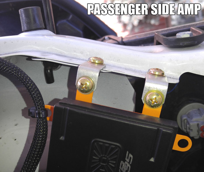

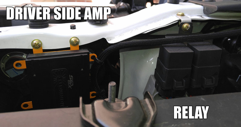

    So here it is, final results and mounting pictures of the Morimoto Elite 35w HID system (5500k) and Direct-Fit XB Type T Fog Lamps from The Retrofit Source.
