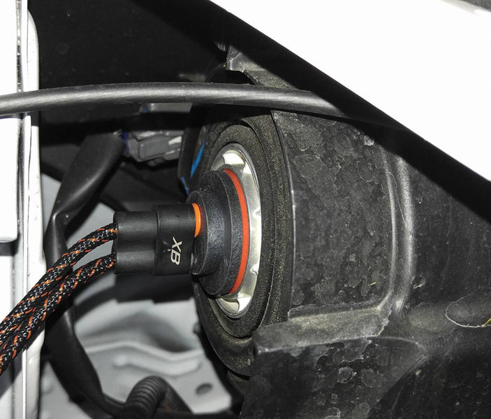

    Ahh, ok...I'm pretty sure because these are it. They have an orange rubber gasket at the base of the bulb where you twist it into the headlight assembly hole. It's a real nice tight fitting seal that I noticed while twisting it into place. Feels really snug.

    See the orange rubber gasket?

    Thanks, so they fit is snug? Are you able to compare the previous version?

    Yes they fit snug, I've already confirmed with my shitty parking lot full of pot holes and dips in from the street lol
