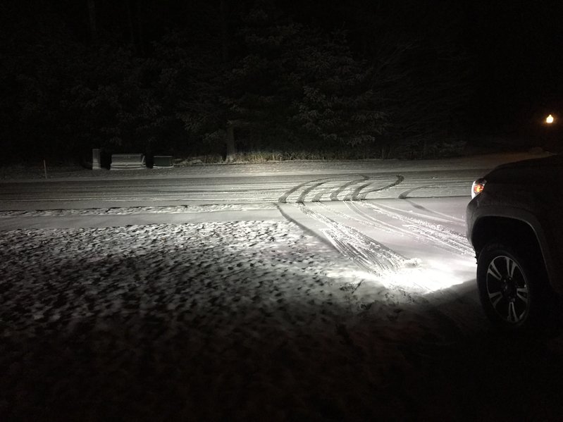

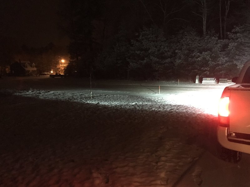

    Super white 16 Tacoma trd sport
    Here's another 2 sorry guys I get little to excited with lights lol
