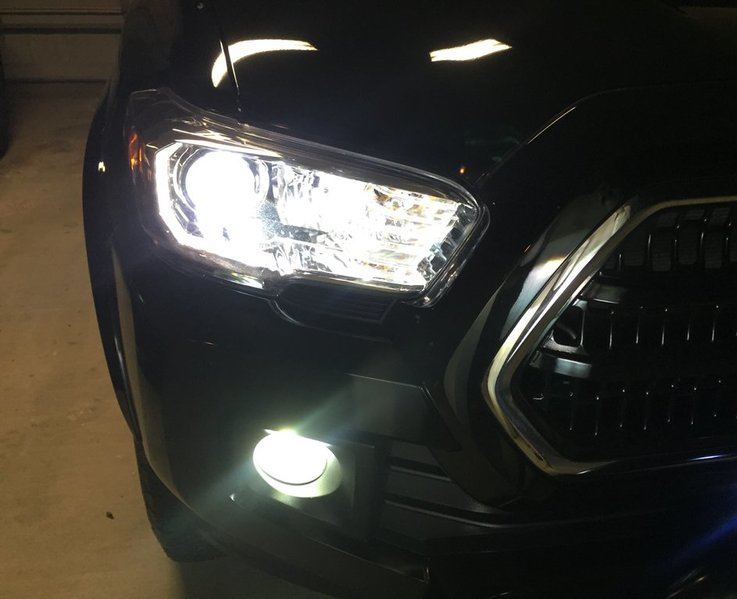

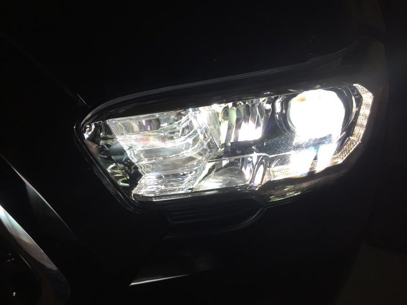

    Do they match the DRLs? They seem to match well from the pictures.

    They match them pretty good. I think they are whiter than them, but I notice when I turn on the headlights, the drls seem to dim which make them not as white as when the headlights are off. The fog lights with the LEDs have a hint of blue to them, probably closer to 5500k.

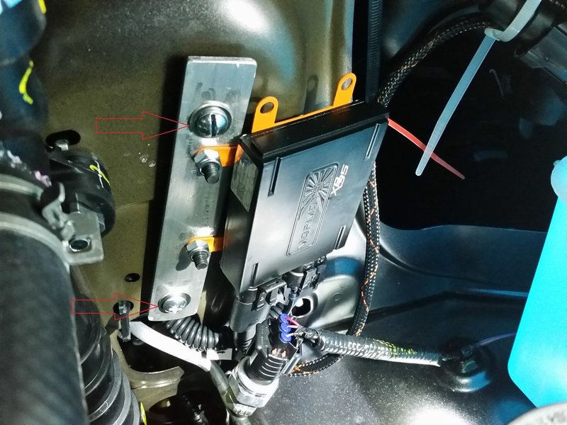

    I originally used something like http://www.amazon.com/Simpson-HRS416Z-Galvanized-12-Gauge-16-Inch/dp/B003YHEEDU/ that I had laying around. However, my first kit went bad and had to be replaced. 2nd time around I used some spare aluminum strips I had (similar to: http://www.amazon.com/M-D-Building-Products-60731-48-Inch/dp/B000I1AOYI/). Bent them & drilled holes as needed. Went pretty well, I'll have to post pics later. I'm actually thinking about buying a new strip and redoing it a bit to make the install cleaner.

  14. Feb 1, 2016 at 4:18 PM
    #874
    TacoZOC
    TacoZOC Active Member

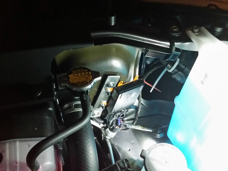

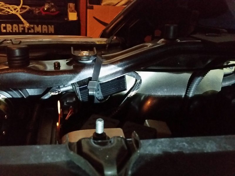

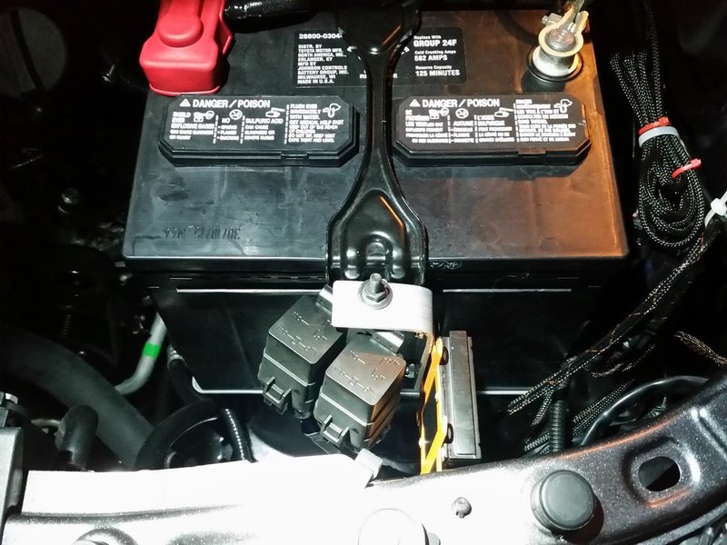

    Sep 30, 2015
    #165524
    39
    2016 Gray Tacoma TRD OR
    djavionyx (post 751) has more balls than me, I didn't want to drill any new holes in the truck just yet! With some longer pieces of aluminum I could make the mounts much better, there may also be better places to use with that larger mount. At the time, I used what I had. When I went to look for examples it made me want to redo the mounts all together....
    Relay and ballast for driver side are mounted on the battery tie down. Going to re-do this to make the mount larger and hang the relay off the left side.
    The LED high beam adapter locked into place nicely with just a zip tie.
    Top & bottom screws go into holes that were already present. Bottom one was threaded already, the top just uses some washers and a wing nut.
    Same as above on the opposite side. This is just to the left of the radiator.
