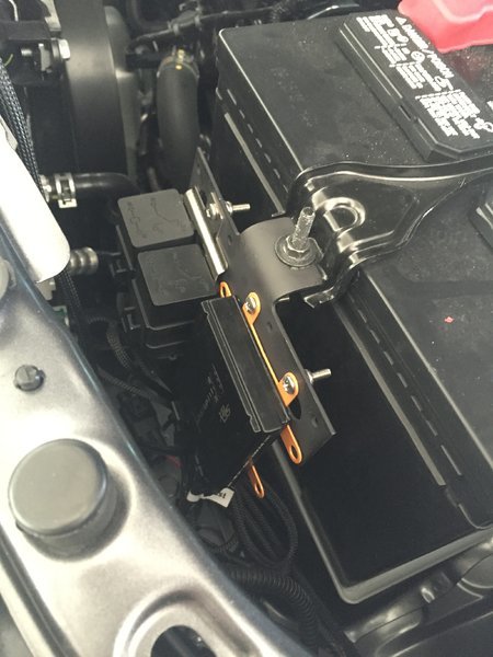

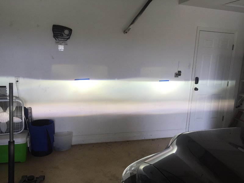

    16 mgm TRD off road
    both hid's and led's installed and have amazing light output at night (35w)
    just a quick day shot
    mounting spot
    I don't notice any headlight bounce at all
