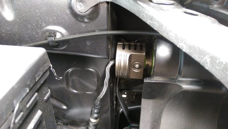

    I'm at a loss man sorry. In the low beams the 2 stroked barely fit without removing the headlight. I didn't try em in the high beams. To fit into low beams you have to remove the 2 top screws of the headlight and use a little force to wedge em in. Had my girlfriend pull on the light while I lined me up.
    Once lined up it takes a minute to turn the bulbs to line up with the socket. Once lined up and in the chord should just barely touch the truck frame...shouldn't rub at all.
  7. Oct 3, 2016 at 7:46 PM
    #1167
    JonWon
    JonWon Well-Known Member
    Sep 8, 2016
    #196764
    516
    John
    AZ
    2017 DCSB OR 4x4

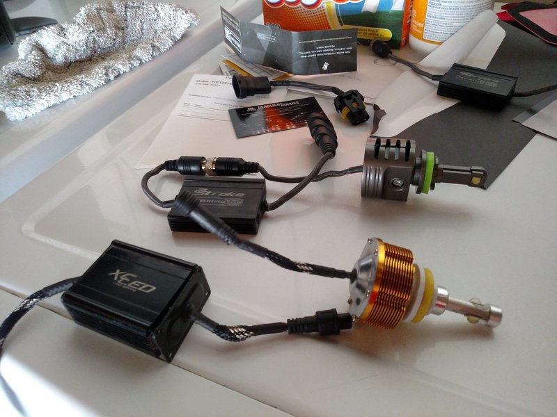

    yup the morimoto H11b. bouncing on imperfect roads and over railroad tracks. i can see them move off a dark street and other peoples cars.
    these came with the supposedly " new gourment '' washers thats bigger and stiffer but it still bounces .
    alot of other people have the same issue but still no solution.
  19. Nov 2, 2016 at 7:48 PM
    #1179
    mulishan909
    mulishan909 Well-Known Member
    Nov 2, 2015
    #168500
    298
    Mulishan909
    2017 Tacoma TRD Sport
