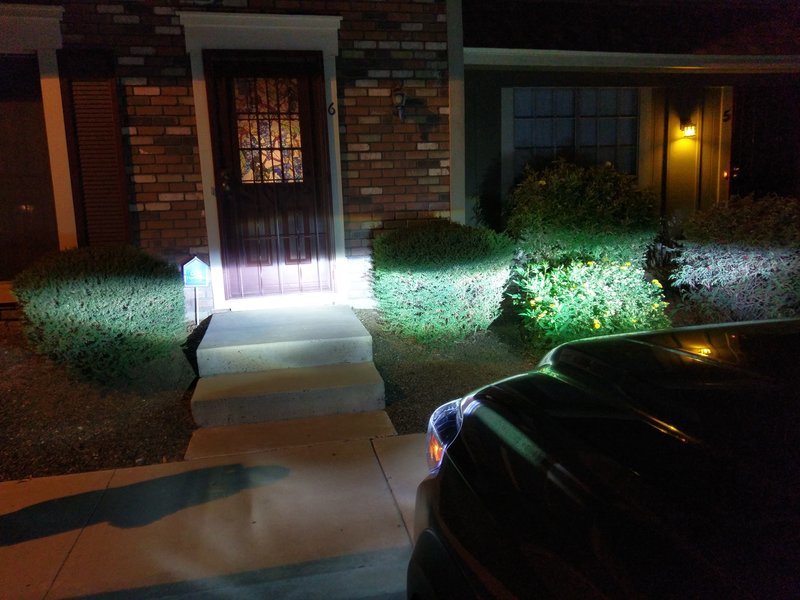

    So here are 3 pics..first is just 2stroke in low beams, 2nd is 2strokes and xb fogs and 3rd is just xb fogs. Camera definitely makes em look more intense then they are but to me both are much better than stock halogens..
  7. Nov 2, 2016 at 8:08 PM
    #1187
    JonWon
    JonWon Well-Known Member
    Sep 8, 2016
    #196764
    516
    John
    AZ
    2017 DCSB OR 4x4
    The fogs fall just under the low beams which is where I like em

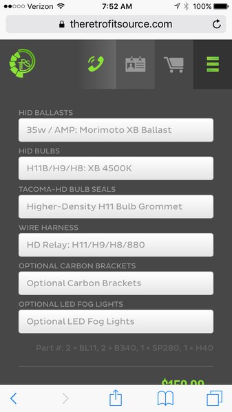

    The kit I ordered yesterday says it comes with upgraded o rings to eliminate that vibration.

    I wonder if you ordered the right kit. They now have a kit specific to 3G that shows upgraded o-rings as an option:
    https://www.theretrofitsource.com/2016-tacoma-morimoto-elite.html
  16. Nov 7, 2016 at 5:29 AM
    #1196
    mulishan909
    mulishan909 Well-Known Member
    Nov 2, 2015
    #168500
    305
    Mulishan909
    2017 Tacoma TRD Sport
    Well I knew this was going to happen do I called in and ask - if I need to make any special requests, the cs rep said all the H11B automatically comes with higher density O rings..... I guess my kit didn't at all
