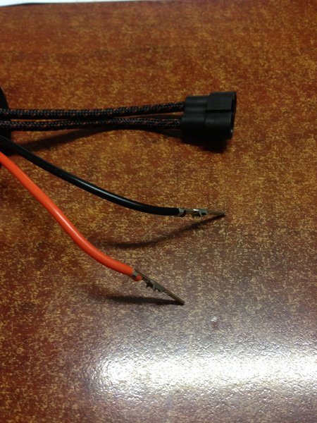

  20. Dec 16, 2016 at 10:07 AM
    #1280
    Taco_yota
    Taco_yota Well-Known Member
    Jul 25, 2016
    #192831
    56
    2016 DCSB trd off-road 4x4
    Where are these 2 wires suppose hook up too?
