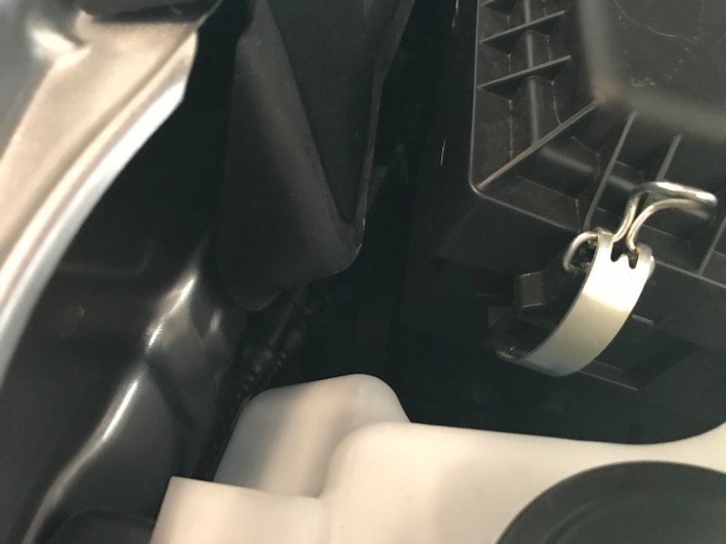

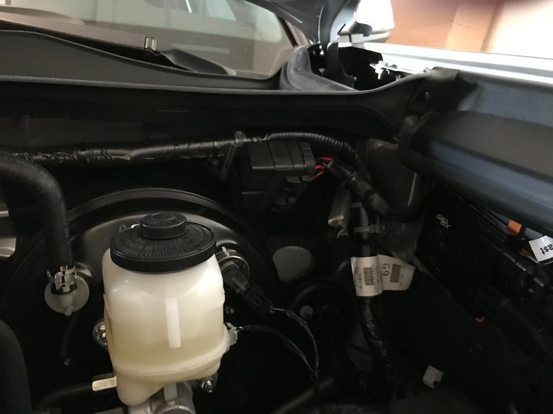

    Relay and Ballast:
    Other Ballast (passenger side):
    I tried to tuck them under the side covers along the inside of the fenders. The ignitors are under there too with double sided tape.

    I didn't use morimoto relay or ballasts but I suspect you could make the same locations work for you
    Windshield ground location for Passenger Side:
    Side of battery on Driver's Side:
    Ground strap by fuse boxes for relay:
