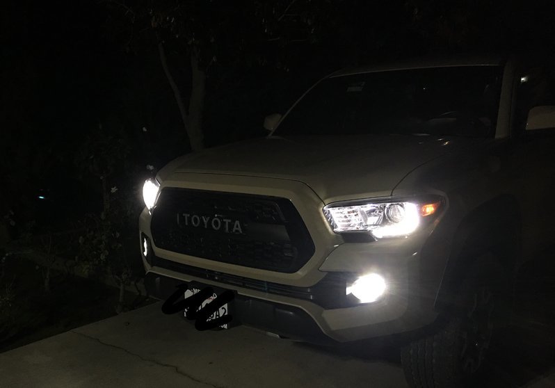

  17. Feb 13, 2017 at 8:32 PM
    #1377
    J.M Taco
    J.M Taco Well-Known Member
    Feb 12, 2017
    #210428
    374
    Central California
    '17 Tacoma Quicksand DCSB TRD OR 4x4
    Installed the XB fogs this evening. A stubby screwdriver is your best friend for the job. I "orangutan armed" through the whole thing, which took about 20 minutes. As others have said the XB color temp matches the DRL nicely.
    I found it goofy that the green wire on the trucks connector is the power and white is negative, on the Morimoto the red wire is power and black is ground. Output and reach on the fogs is really good, I'm satisfied thus far.
    As for the looked HID kit, I'll try to get around that tomorrow.
