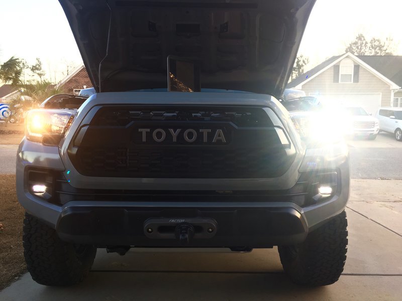

    2017 Tacoma Trd Pro
    A lot of stuff, just ask and I'd be happy to tell you. Or we could wheeling/camping
    Before and after

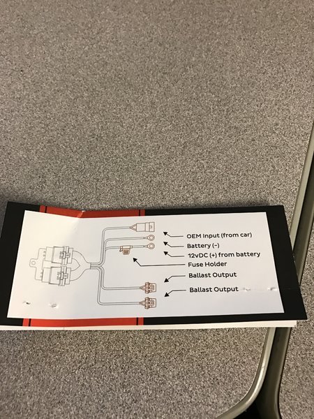

    I've just wired the drivers side light on my morimoto HD but the other headlight ballast has no place for the factory power wife to go. Any ideas?
  19. Mar 11, 2017 at 2:22 PM
    #1399
    JaTe
    JaTe Well-Known Member
    Mar 1, 2015
    #149874
    514
    Maryland
    2017 Tacoma TRD OR DCSB
    If you used the harness, then the stock passenger side connector isn't used. Cover it up and tuck it away.
