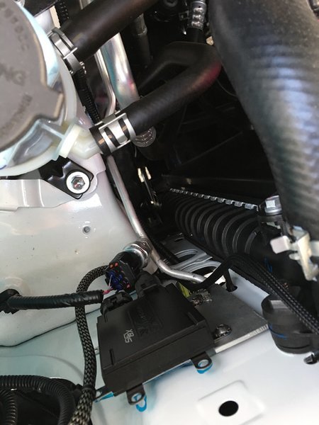

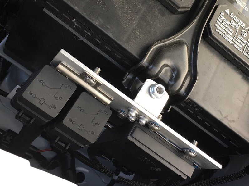

    No drilling. I posted some pics that show some mounting areas.

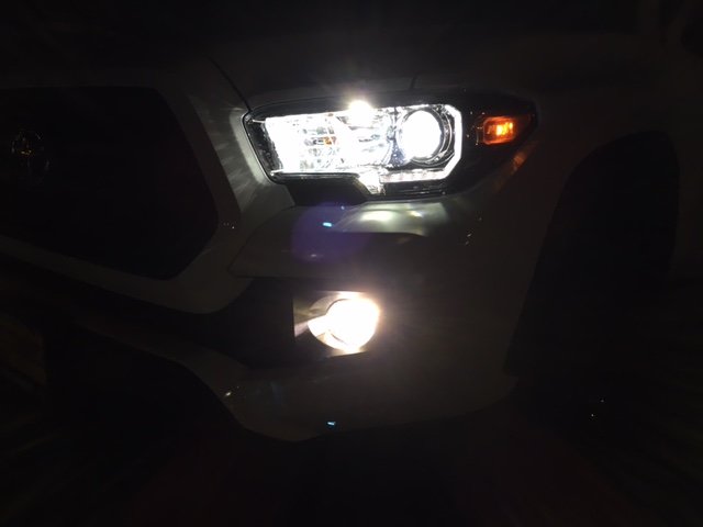

    Just installed my 6500k Lows and XB LED Fogs (with LaminX Yellow Film). Couldn't be happier!

    Yeesh, You may not want to. For now I've basically got the relay and ballists zip tied as cleanly as possible near each headlight and battery. I plan to clean it up later with a more permanent solution, but that's it for now! I'll take some embarrassing photos of them this weekend to give a better idea.

    Okay! well my lights just shipped so this weekend im going to go to lowes and make some mounting plates with some aluminium sheet. I dont have the exact dimensions but ill rough cut it for now!
