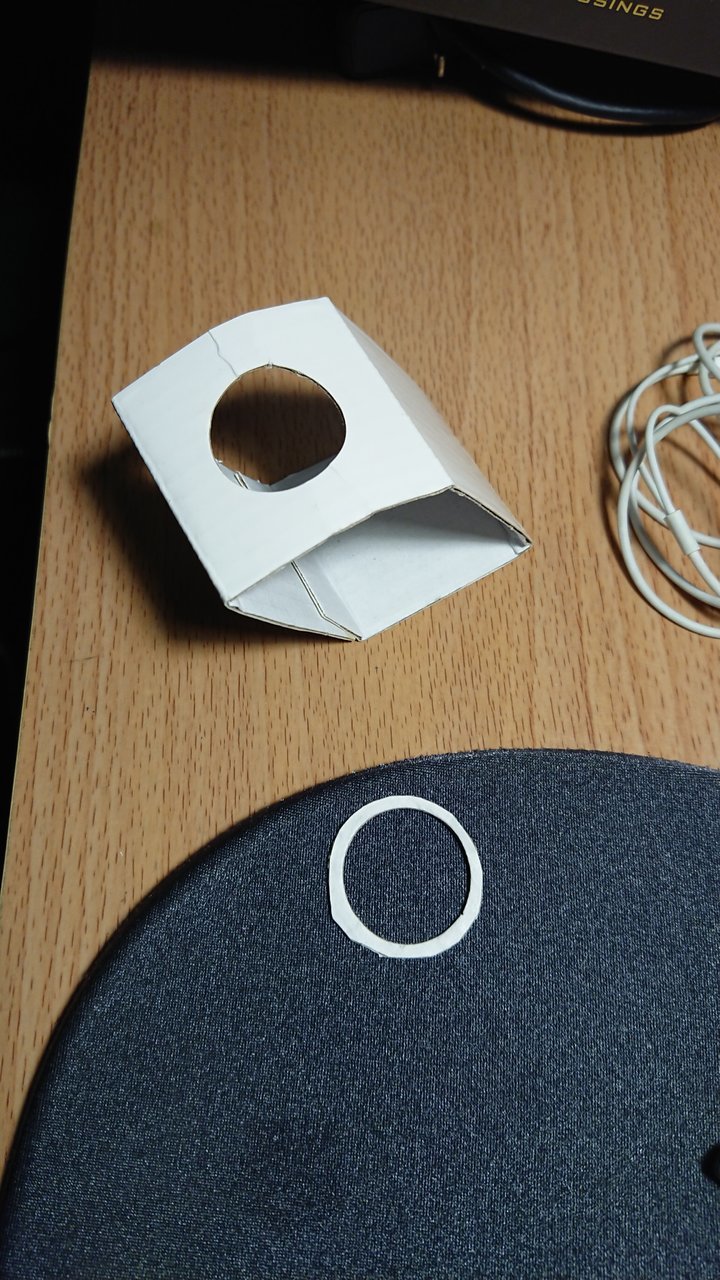

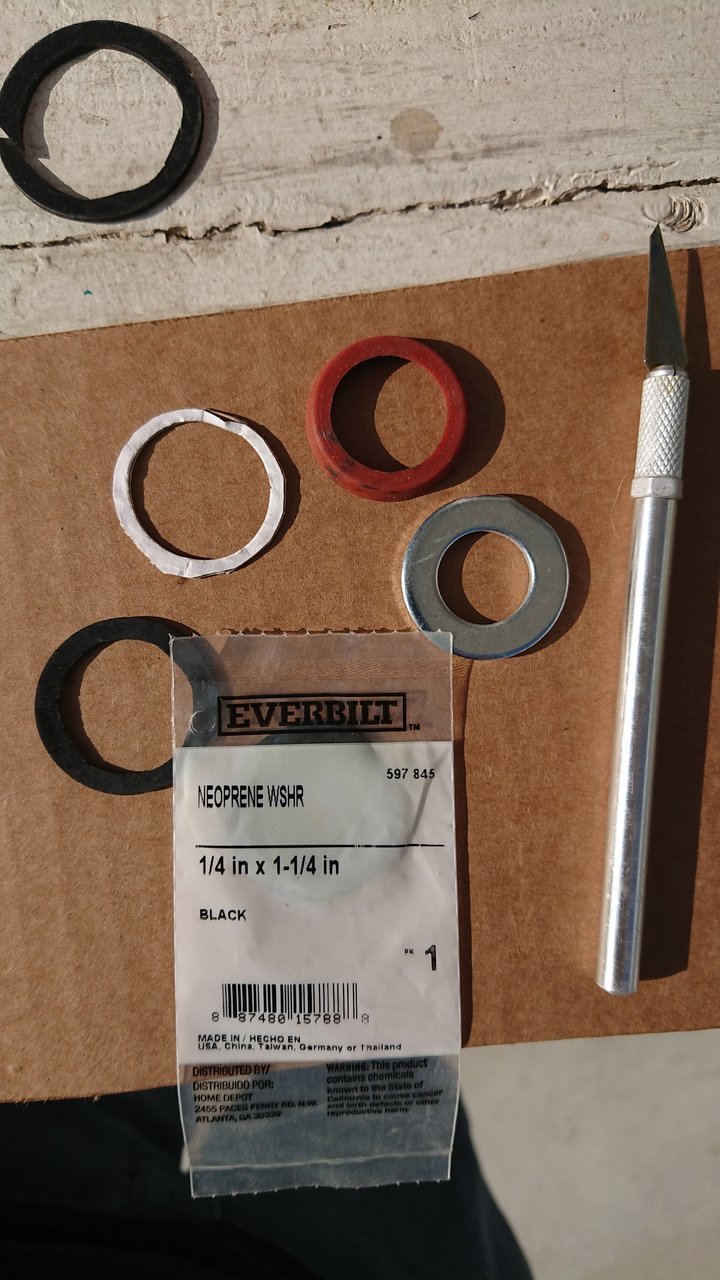

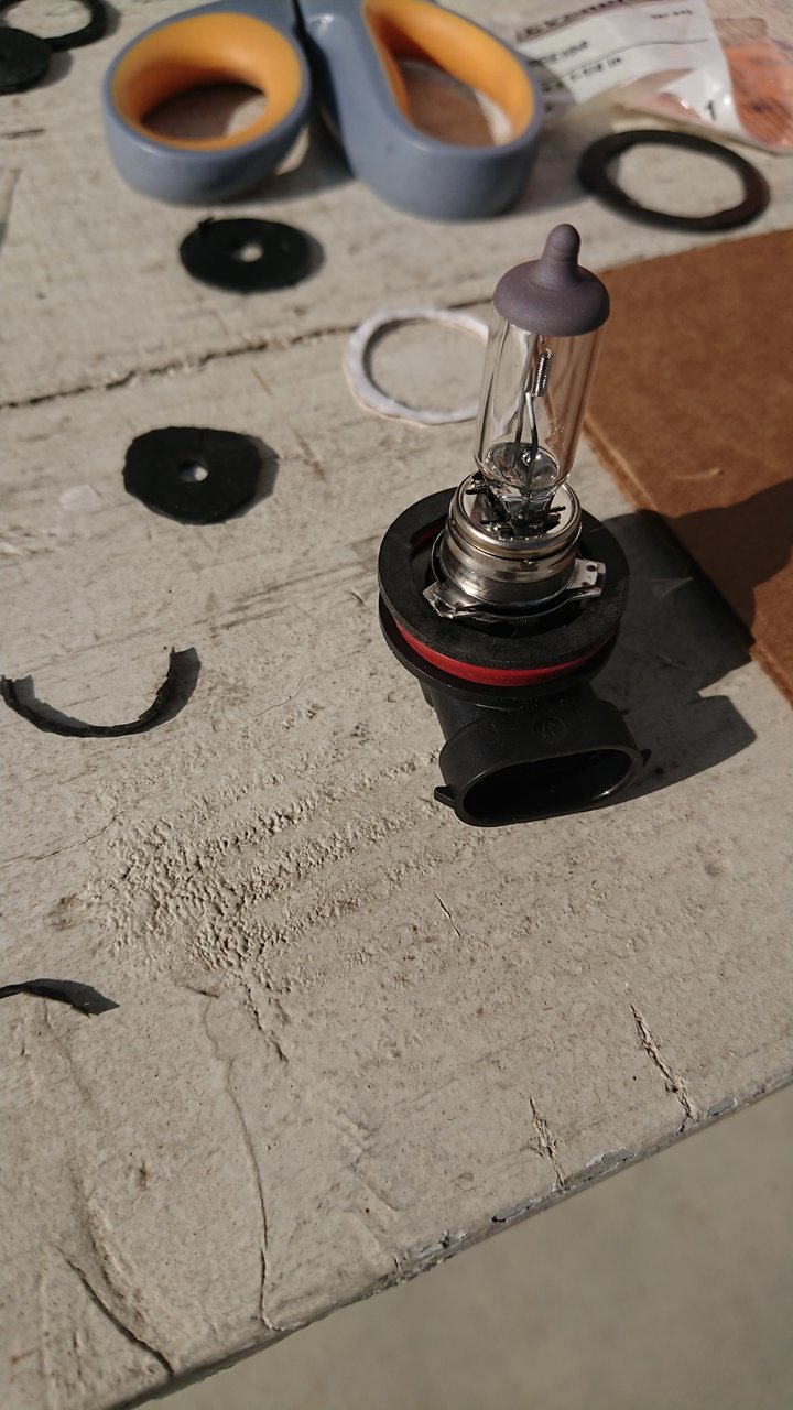

    Updates on a "possible fix" for the shake and bounce with some spacers to add between the bulbs and the "so called high density gourmet washers from Trs"
    Went to home depot and bought some neoprene washers gasket size 1/4 x 1-1/4 inch.
    Used the box that the bulbs came with and traced with the metal washer.
    Used the cardboard washer to trace the inner circle to fit on top of the washer
    Test fitted with my 2017 oem fog light housing as they are the same size bulb.
    The pictures of what I did and a video of "play, movement in the housing with the the morimoto bulbs and it's high density gourmet.
    With the home made spacer there is no play. Some play but it feels like it would break with that type of force.
    Make sure you have a cold beer and it was beastly to twist in with that extra spacer on top. Push in and twist with full finger power!
    Will test and feedback once I drive at night over bumps, train tracks, and off roading
    * last time I'm messing with it. If it works= great, if not I'll live it it.....
    Video of it shaking inside the fog housing
    https://youtu.be/d_DU-L7Xo28
