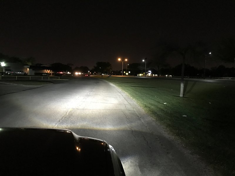

    I got my Morimoto HID and LED 2 stroke kits in but didn't get home from out of town until about 6 P.M. last night but was too excited to wait until this evening to install both kits so I decided to tackle the HID kit. I will say that it was much easier to access the low bean on the Tacoma Vs. the Jeep Grand Cherokee. I went with the 35 Watt 5500K kit as I Like the Whiter light but wanted the Lows to match the LED kit. The install was super easy and didn't take long at all until I got to the Morimoto to OEM connection. The male connection on the Morimoto kit fits in to the OEM female connection however I could not get it to snap in, I have it in there for now but I am not happy with it, So I'll have to figure out something soon. I am expecting to have the same issue with the LED kit as well. Does anyone have any advice or suggestions? Overall they are a lot brighter but I do not like the throw, My 2015 Jeep Grand Cherokee had a much better light output with the same kit. There it also a big dead space that I am hoping the Fogs will fill in.

    I have the same kit in my 2016 TRD Sport. The dark spot right in front of your vehicle isn't visible when you're driving so it would be a waste of light. I didn't have any problems with the connectors so you might want to take them apart and make sure the pins aren't bent at all.
    I got the Morimoto drop in LED foglights because the stock fogs are not meant for anything other than a halogen bulb. With the LEDs in there you'll run into the HID in reflector problem. A sun spot in the middle of a ton of glare and not much of the light going in the right direction.
    For the price of the LEDs you might want to see if you can return them and get the drop in fog lights. You'll have much more light output and a sharp cutoff if you do, and they're not much more money.

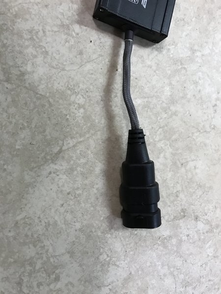

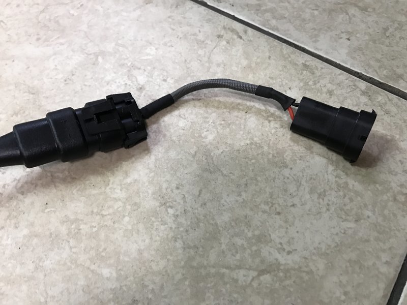

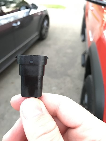

    IMG_1462.jpg IMG_1462.jpg IMG_1464.jpg Well I think I figured it out, I was looking through everything that came with the LED kit and there was a jumper that had what I thought was the same connector but it was a little different it had a tooth on each end, plugged it into the factory connect and locked right in.

    HID in the high beam reflector would work, but you're better off doing a full retrofit if you're looking for more light.
    HID, LED, and Halogen bulbs all have very different ways of putting out light. Your low, high, and fog lamps are all optimized for halogen. HID are reasonably OK to use in the low beams because they are projectors, but the side effect is having squirrel finders (the little bit of light that escapes above the cutoff line)
    Fogs suck with HID or LED bulbs. They create a sun spot on the front of your truck and scatter too much light.
    HIDs are sorta OK for the High beam if you keep them on for long periods of time, but again the reflector was not made for them and you'll lose a lot of focus. Also, HID bulbs don't like being switched on and off. They also take a bit to warm up and actually turn on so you can't just flash your headlights to let someone go at an intersection.

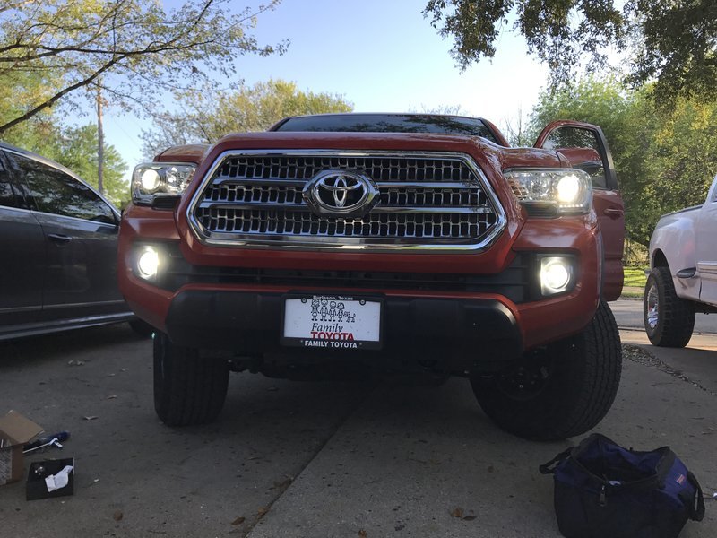

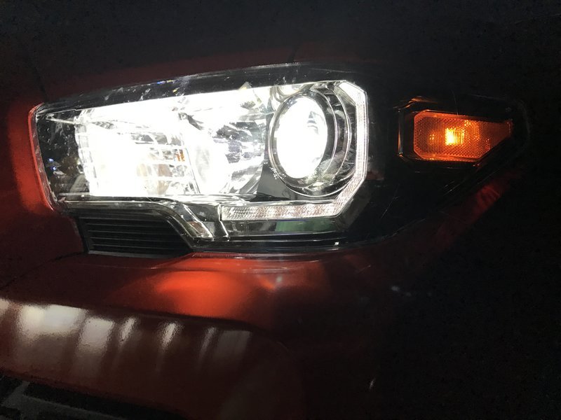

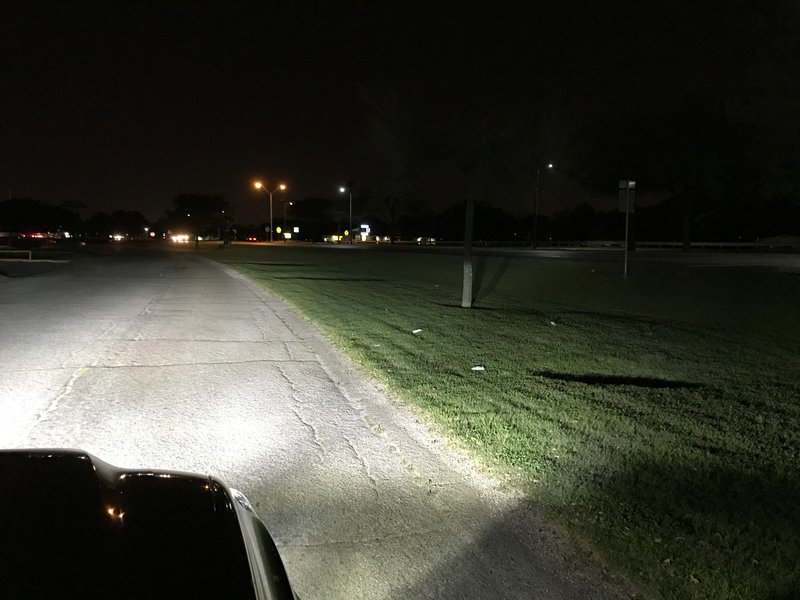

    Finally got the 2 Stroke LED kit installed tonight and it is much better, I am happy with the outcome. IMG_1485.jpg

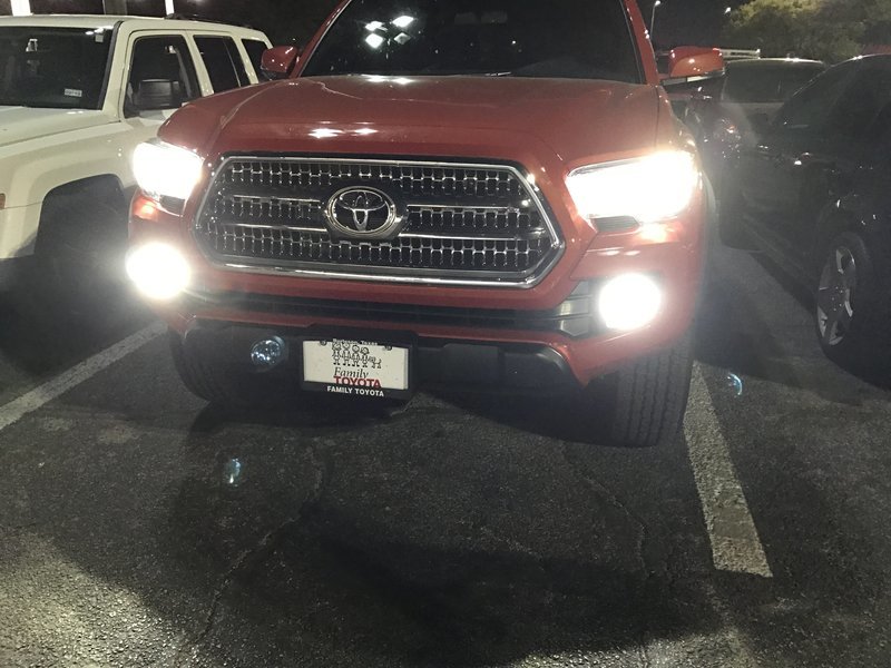

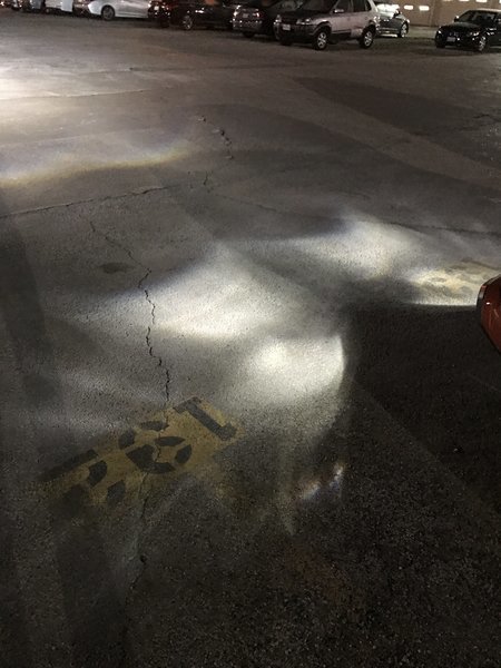

    Check out the difference between the two, the Fog lights fill in the dead space that was bugging me and shoots out to the side quite a bit.
