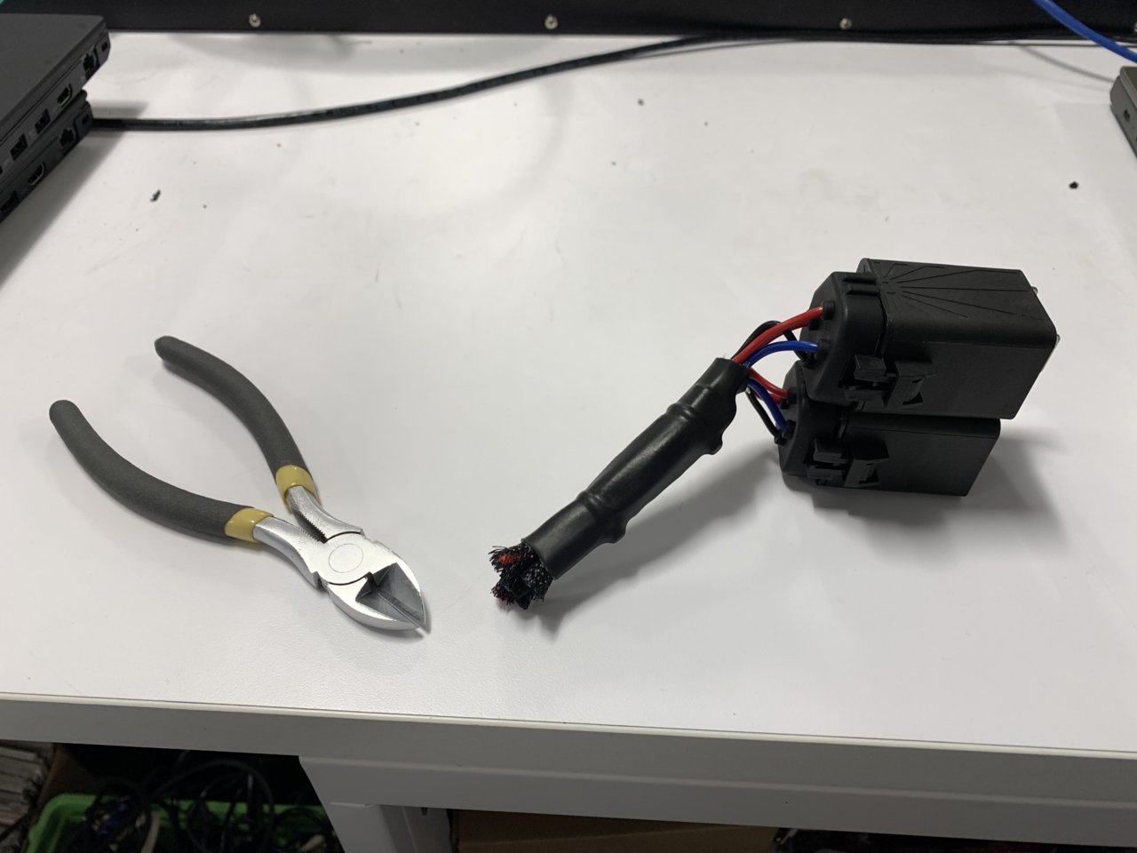

    Spoke with TRS. They’re sending out another pair of igniters and a new relay harness...lol
    If things still aren’t working after this, I’m just gonna get my money back and buy the Morimoto LEDs. Plug & play.
    Funny part is that in order to send out a new relay, I had to snip apart the current one and send pictures. Felt weird cutting it but I did :rofl:
