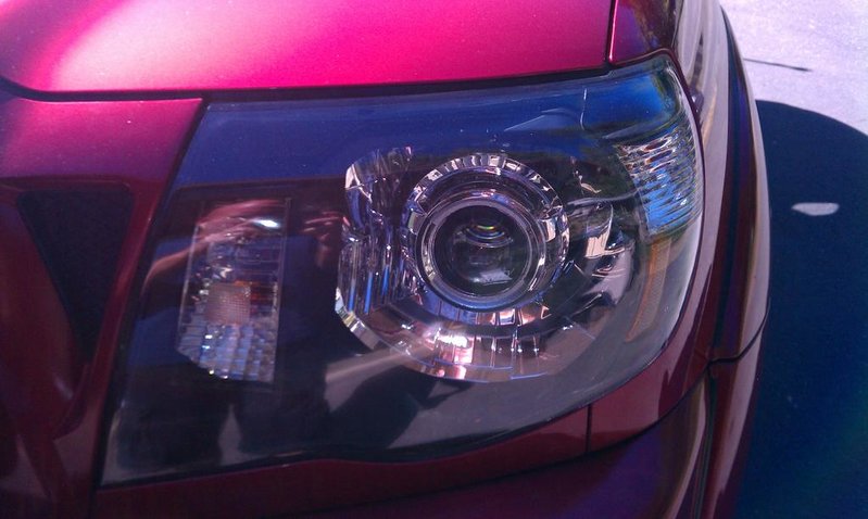

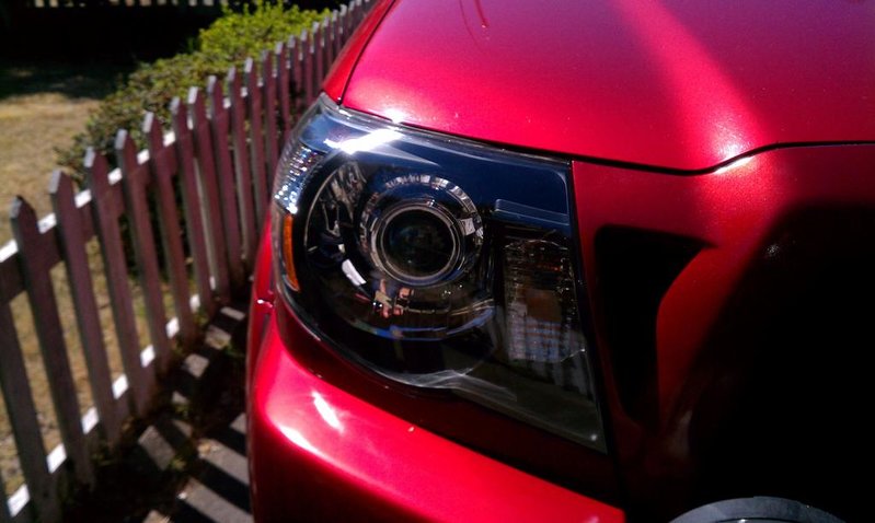

    I got my morimoto mini hid retrofit done last night. It wasn't too hard at all. The light output is awesome. Way better than stock headlights!

    Looks Good! How much did that run you if you do not mind me asking?

    Which shrouds did you get?

    The whole setup which is projectors, morimoto hid bulbs, adapter plugs for the new bulbs to work with my ddm tuning ballasts and relays, and the Apollo shrouds ran me about $170. The kit was super easy to install. All plug and play basically for all the equipment....you just have to seperate the light housing from the light window. Heat light assembly in the oven at 275 for 7 minutes and seperate. When finished with the projector install put back in oven at 275 for 7 minutes to resoften the sealer and put back together.
