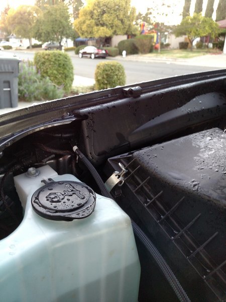

    Well they sent me H11 LEDs... High beams are h9s...
    They already told me they're not doing anything about the HIDs.
    I reinstalled everything, I have the ballasts in a pretty protected area, all the ends have been siliconed and dielectric greased.
    I sprayed it down with water and no issues.
    Now to wait on the proper LEDs.
    The old ones still work but with a melted wire I'm not down to put them back on.

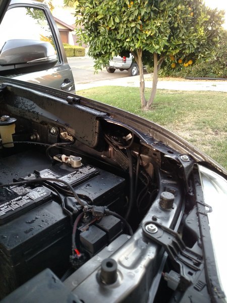

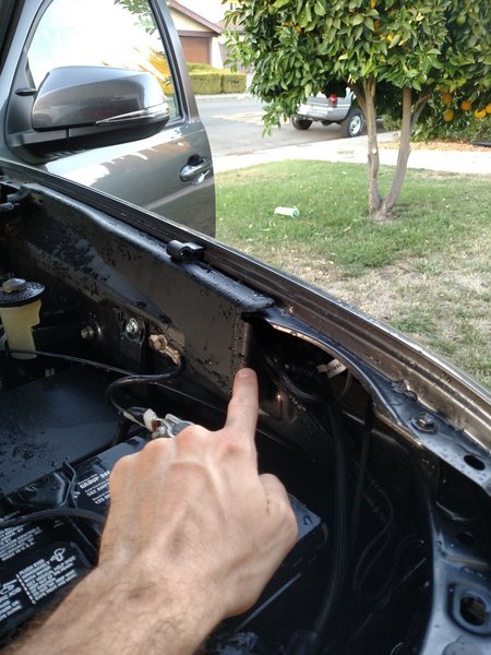

    I tucked the ballasts and igniters back behind that plastic, and with a hose test, since the fender is all sealed off by plastic, no water gets up to them from the tires, and if I wash the engine bay, they're out of the way. For the purpose of testing I shot back there in that space on purpose. Targeting every plug directly.

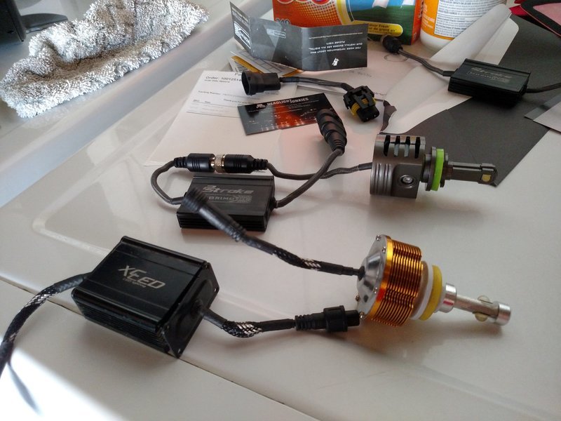

    You can also see the XC LEDs (copper ones) and the new 2strokes. 2 strokes have metal couplings and are heavy. But have an internal fan, and in the past fans have failed on me. The XCs (discontinued) had a heat sink.
    Being for high beam use, they'll never be in for long periods of time anyway.
