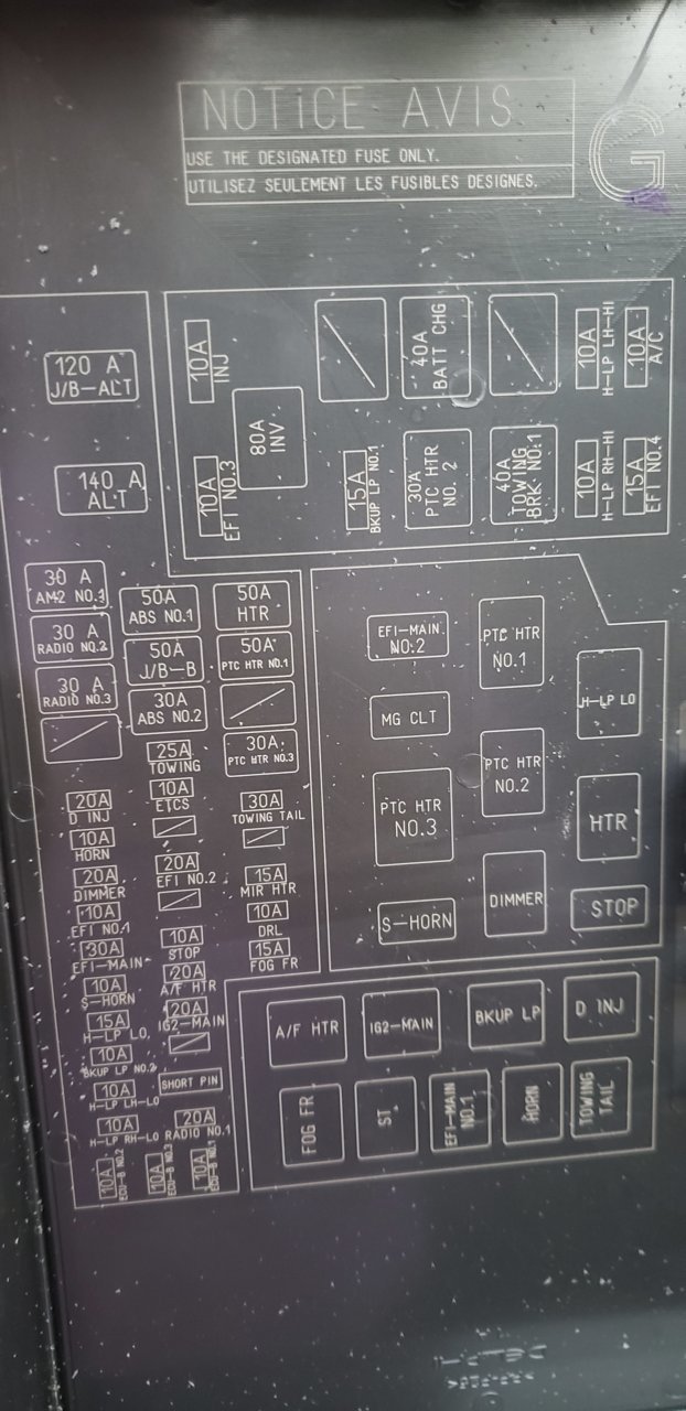

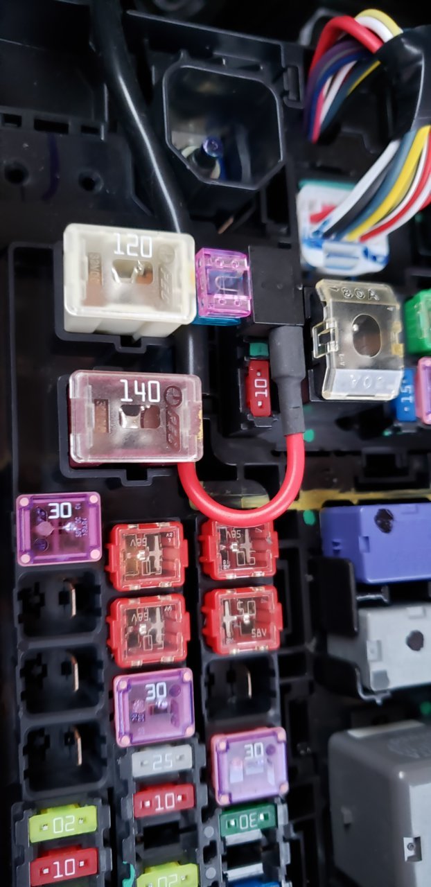

    Yes, the Morimoto XB headlights do turn on...driving lights...randomly when the SR5 is off. I have dash cams and home surveillance cameras as proof. Also, MESO mentioned something about this. Other discussions have mentioned this issue, but I have not seen a specific solution.
    I moved the SR5 fuse connection and stopped using the fuse mentioned in the online installation instructions. Around February 2020, I selected an alternative 10 amp fuse, next to the suggested fuse. I took a picture but do not recall my decision process. 20200122_171136.jpg 20200122_171204.jpg I am not an expert, but it appears to have resolved the random powering of the DRL. I have not driven the SR5 much since March 2020.
