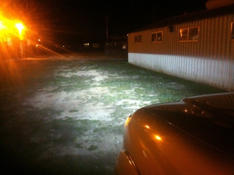

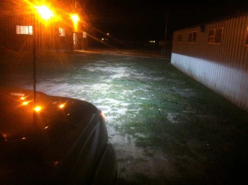

    Nice looking retro man! :thumbsup: the 6000k's arent too blue for you? Would you be able to post some night pics of the full light output (not just on a wall)?

    actually they aren't blue at all, more in the pure white-ish look.
    I'll get some pic up.

    davidjmay- here's the pic that you've asked for. I use my iPhone. kind of sucks that it couldn't focus when I was driving about 25mp. it looks a lot better in person.
    here's the driver side
    8517E935-D4EB-409F-A947-1E5FAF73EF05-799_429773f0cda25dc13545579da95a4595ff81d62f.jpg
    passenger side
    9EB878E0-F365-4BBD-B096-E3CFB7E4A55A-799_40a38e1dd1daa041dea798ddb81617432403832d.jpg
    stupid phone couldn't focus, but you kind of got the idea. I'll prolly get a better pic next time.
