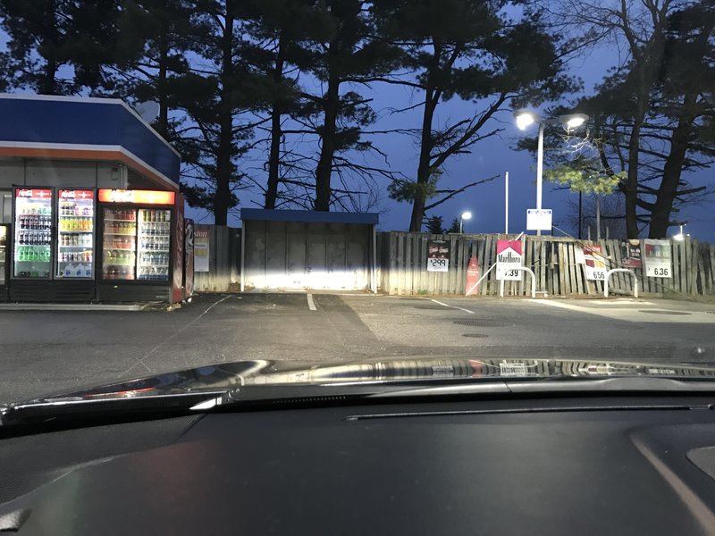

    Here's a pic of the cut off from about 30' away. As you can see it's pretty crisp. I did aim my headlights down a little after installing them, but only a hair.

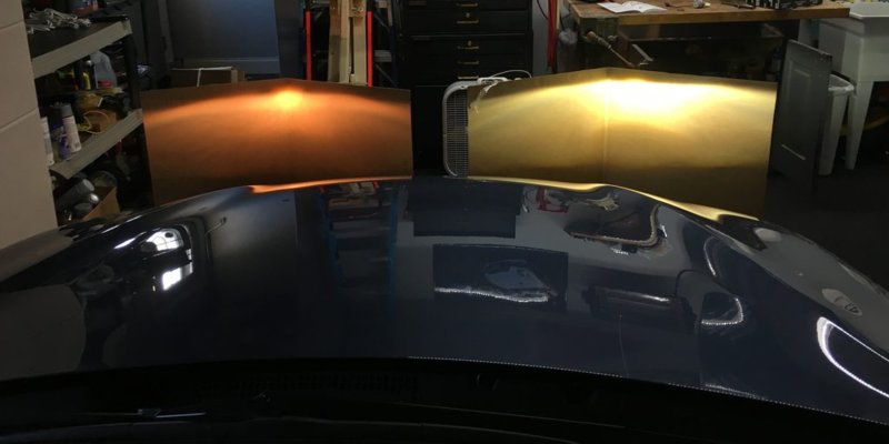

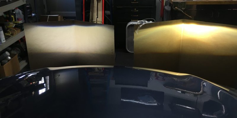

    LEDs lack the hotspot necessary for throwing light down the road.
    Stock halogen left and hid right
    LED left and hid right

    Same here. LEDs are not the answer. I'd compare those to a cheap spacer lift on the Tacoma. Throwing hids in halogen projectors is like a bilstein/ome lift. There are better options out there, but it'll get the job done pretty well. Then there's king/fox/etc. Those are proper retrofits that'll knock your socks off. Yes they're better but as long as there's no glare being thrown to incoming drivers, there's nothing wrong with HIDs in stock projectors.

    What are the pictures that prove otherwise? Are you considering the squirrel spotters as a condition of the projector's cutoff? Those are designed to throw light above the cutoff to help with visibility of signs and the light intensity in that bit is very low. Lower than the stock halogens, in fact, thanks to the return wire of the HID bulbs casting a shadow in that.
    I've personally driven past my truck with HIDs coming the opposing way while above the cutoff and was not at all inconvenienced. My wife's even mentioned she thought the lights looked dim from her perspective as oncoming traffic. Would a retrofit be better? Absolutely. Does not retrofitting mean you're blinding oncoming traffic as a result of this cutoff and/or that this setup is in any way worse for your own visibility than halogen? Not even remotely true.
    As to your other claims of the hotspot not being the only factor, width, etc...you're not wrong. However, I can assure you, this is throwing light everywhere better than the halogen.
