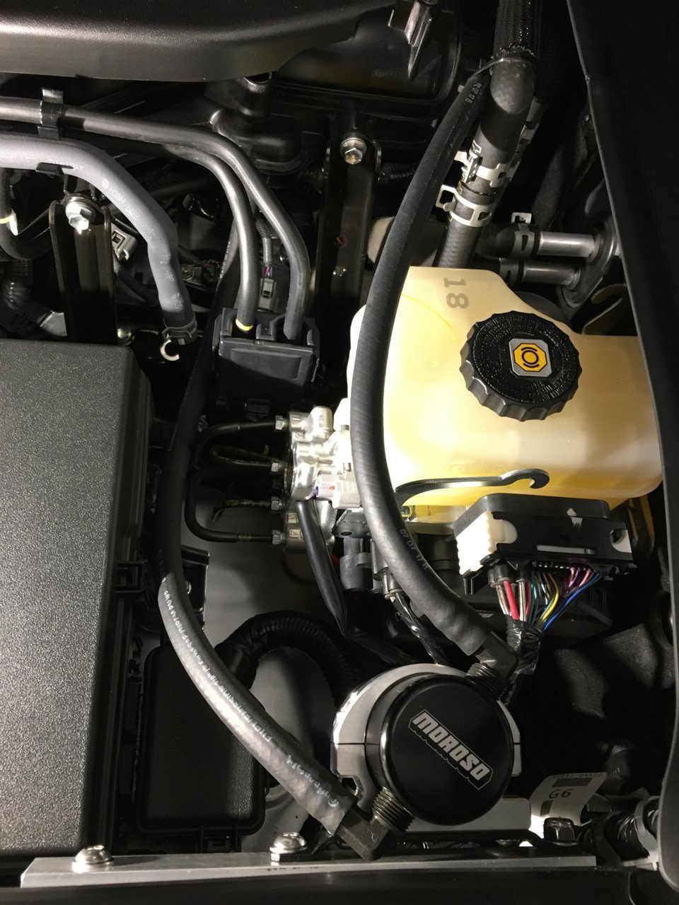

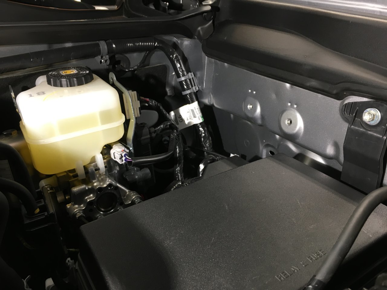

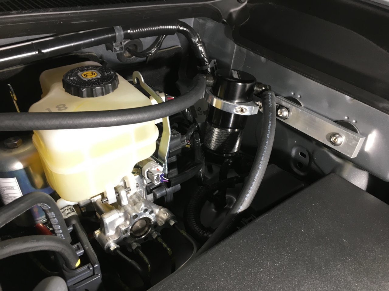

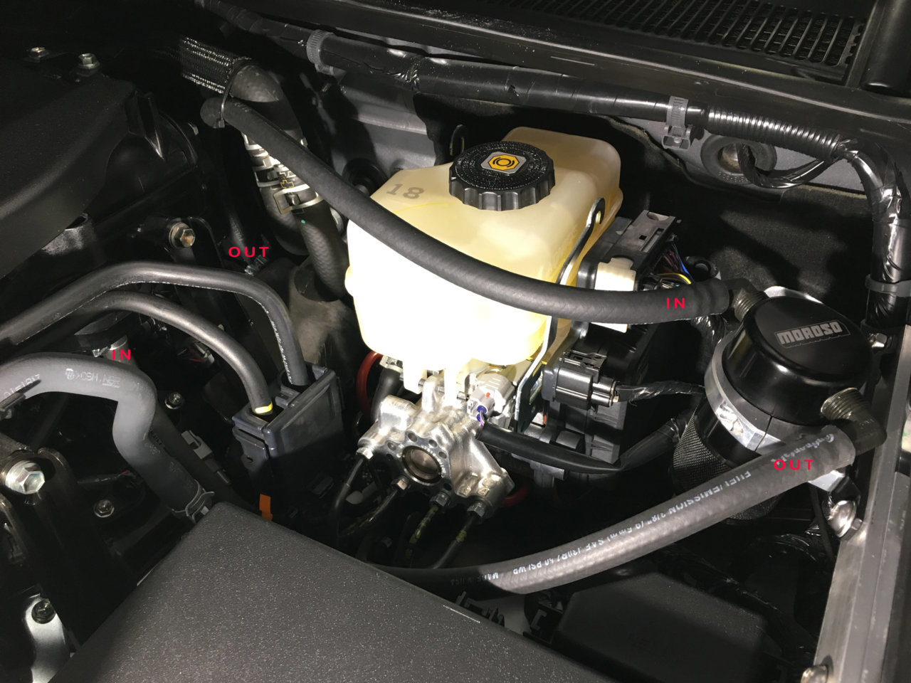

    Hello all!

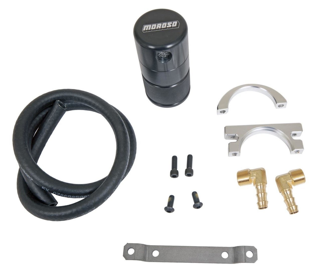

    I installed a Moroso oil/air separator (catch can) on my 2019 Tacoma TRD OR – 2GR-FKS 3.5L V6. This can has been used on two of my previous vehicles with very good results. 2016 Honda Fit EX and 2007 Tacoma SR5 2.7L. It has removed oil/fuel vapor/moisture in both vehicles that otherwise would have been ingested into the intake track and onto the intake valves. I check and empty it every 500-1000 miles. It definitely works! Whether you are yay or nay regarding catch cans, here is the fairly simple install procedure.
    Materials:
    Moroso Universal Black Anodized 85497 Air/Oil Separator (purchased from summitracing.com)

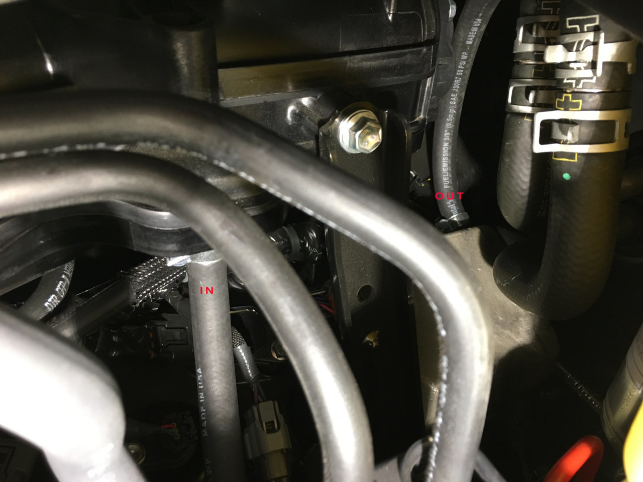

    The kit includes 3’ of 3/8” PCV hose. I preferred using higher quality/better flexibility Continental PCV hose from Amazon. It includes 4 smooth back hose clamps for use on the engine side only. The 90 degree barbed hose fittings mount very tightly into the hose on the can side – no clamps are needed. Lubricating the inside of the hose and barb exterior with silicone spray makes the process much easier.

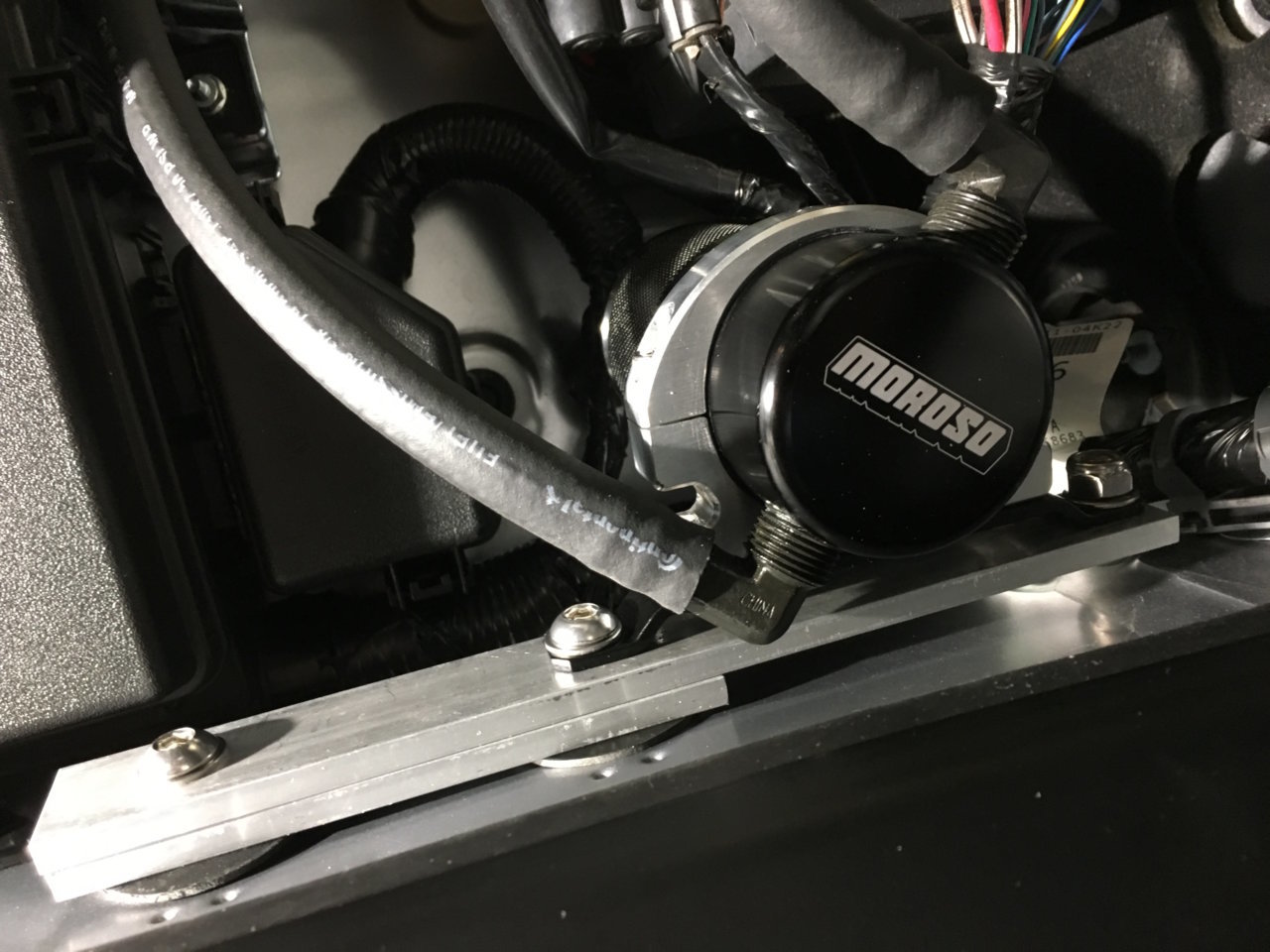

    All materials below purchased at Ace Hardware:
    ¼” x 1” x 4’ Aluminum Flat Bar
    Length: 5” inside bar (fender attachment) 9” outside bar (can attachment)
    Use two existing 8mm threaded fittings on fender wall to mount.
    Drill aluminum bars & outer steel can mounting bracket holes with 5/16” bit.
    (2) 8mm x 30mm 1.25 pitch stainless button head socket cap screw
    (Aluminum bar to fender wall)
    (1) 8mm x 20mm 1.25 pitch stainless button head socket cap screw
    (Aluminum bar to can mount/cap head facing fender wall)
    (1) 8mm 1.25 pitch stainless stop nut (nylon insert)
    (Aluminum bar to can mount)
    (4) 8mm stainless flat washers
    (2) 1.5” rubber washers (aluminum bar to fender wall)
    Have fun and let's go places!

    Update: Yes – 2GR-FKS is direct and port injected. Catch can certainly can't hurt, eh? Drain interval is now 3K miles. At that interval, 22ML or bit more than a generous tablespoon of oil and other nasty muck is consistently captured by the can.
    I don't want that gooping up the intake manifold or valves, even though they are washed somewhat by the port injectors. How much oil will be injested over the service life of the engine? Do the math.
