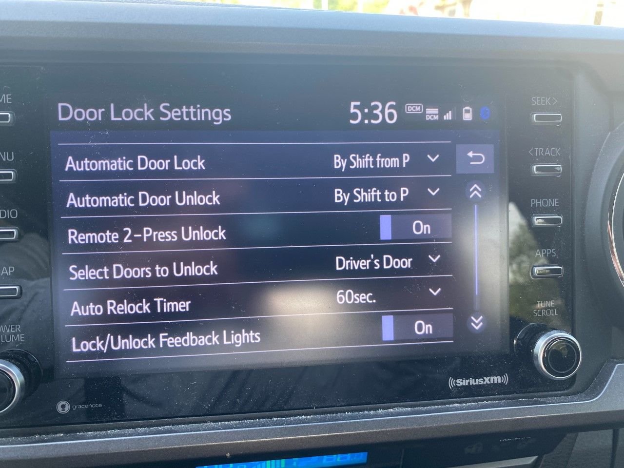

    Can anyone tell me how to make it so all my doors unlock when the ignition is turned off. I feel like sometimes they do and sometimes they don’t. Most of the time they don’t. I have a 18 MT. With a family, it’s such a pita to get out pull the handle, then have to pull the keys out, no keyless entry with manuals, and unlock the truck. Rant over.
    Thanks for the assistance.

    Its in your trucks setting screen. Under like driver settings or some shit. Im not sure there is an ignition off one but you can change what locks and unlocks when you shift to or from park

    it's in the radio settings - I've got a '17 6MT and mine unlocks all the doors

    The lock screens are available in the vehicle functions setting on the touch screen. However, they do not always work appropriately and it’s driving me nuts. Does anyone else have experience with the same thing? Maybe I’m opening the door too soon or what?

    My 18 manual unlocks all the doors if I turn the truck off and then open the drivers door, if I open the door with the engine running, it doesn't unlock any other doors. I'm good with that.

    Good tip! This might be the issue. I am the kid of person who sprints everywhere and it’s definitely possible I have my hand on the door handle and my keys at the same time. I’ll pay attention and see if that is the issue.

    I found that if it is set to unlock when you turn off the truck it does work. But you can not open the drivers door before shutting off the engine. I was getting a bit frustrated as well. Then I turned the locking features off and I lock the doors when I want to. Hope this helps. And another thing, manuals rule and are too cool, automatics are for fools that drool! :rofl:

    Looks like the AT and MT have different settings.
    Plus, you have 2018 and mine is 2021 so the display system is different.

    That page explains for AT...didn't see where it explains for MT.
    AND he doesn't have a SMART key.
    EDIT: Page 124 does have a workaround for non-smart key system.
