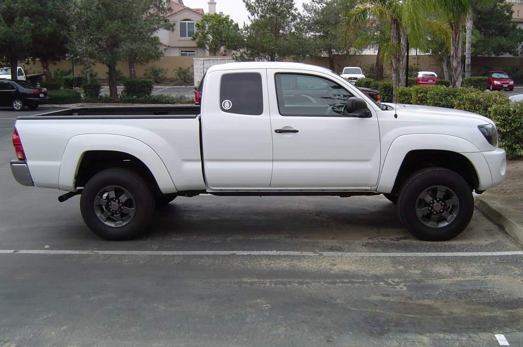

    here is my truck w/ bils at 2.5" and TSB leafs (NO AAL), nearly level. so you really dont need the rear AAL if your worried about money right now.
    i suggested the bils because many people have had the OME coils settle on them, giving them 2.5" or less anyways. yes, at first you will have 3" (maybe a tad more), but it will eventually settle down a few months later. also, you really dont want more than 2.5" any ways for alignment, tire wear, and handling reasons.
    also, if your going to get the bils upfront, i suggest you might as well get all four shocks from sonny, will make a big difference in the way your truck handles.
