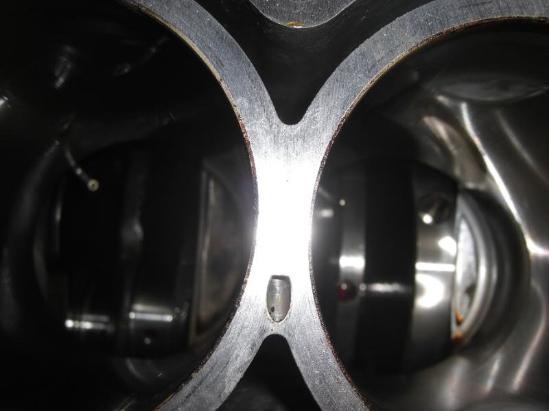

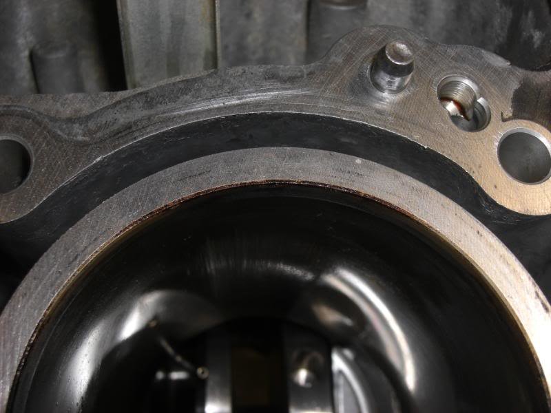

    LCE has been bored plenty of 1GR's. The most the over bore them is twenty over. .020
    From 3.701 to 3.721. They even have pistons listed as such on their website.
    Orrrrr just get the block sleeved. ;)
    Here are a couple pictures, from one of my blocks, illustrating the sleeve liners of the block.

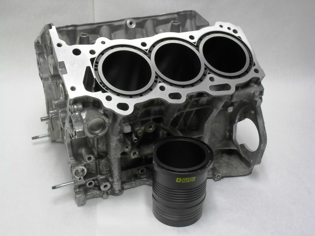

    These are Darton Modular Integrated Deck (M.I.D.) sleeves. Completely replace the factory sleeves. Gadget shipped themone of my spare blocks so that they could cut it apart and get all the necessary measurements to the sleeves. With these, one could have them bored without worry of sacrificing cylinder strength. Obviously. The only question would be how much you could go based off of the combustion chamber. Easily .020 over. How much more than that, I do not know. And engine builder would have to make a recommendation on that.
    There are also stroker cranks already available from Brian Crower. Have to order them from a place called Sub-Zero performance, or something like that, out of the UAE. That Brian Crower crank was $4k last I checked, and made the engine a 4.3 L
    Or have LCE make one for half of the cost. $2200. They use a company that makes one off racing cranks.
    Balboa was supposed to have custom sleeve inserts done to his block. Those still left the factory sleeve, bit bored it out for the inserts to fit. Still leaving the open deck. Still allows for top of cylinder wobble too.
    The Darton sleeves you see in the picture are what I did/am doing.
