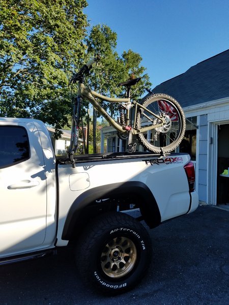

    I went with the Mobtown Bars & Thule Sidearm Racks. Haven't done anything too crazy but I've had the truck rocking side to side a few times and the bike is locked in tightly enough that the only movement I've seen is the bike suspension compressing on occasion. I've used Thule Bigmouths as well and they are hit or miss depending on the bike. Not really a fan of the fork mount racks as they really only work well with 15mm QR forks, plus the hassle of putting the wheel on/off each time you want to move the bike, as well as having a bad experience with having a bike that was attached to one get tossed. Here's a picture of my setup: [​IMG]
  12. Oct 10, 2016 at 5:08 PM
    KB Voodoo
    KB Voodoo Well-Known Member
    Dec 20, 2012
    #93425
    9,862
    Chad
    Glenwood, NY
    www.kbvoodoo.com
    Bike is rock solid, and elevated above the bed so you have room for other gear.
    I've been using this system since June. Every place I ride has a rough dirt road to get to it. Over 80 rides this season. It's an awesome system, and it looks phenomenal.

    Thanks for the feedback. I do like the convenience of your setup. Not having to remove the wheel all the time would be nice, and you still have full use of your bed. You have the same tonneau cover as I do too so that is a plus. Glad to hear the setup has been rock solid on rough surface for you as well.
