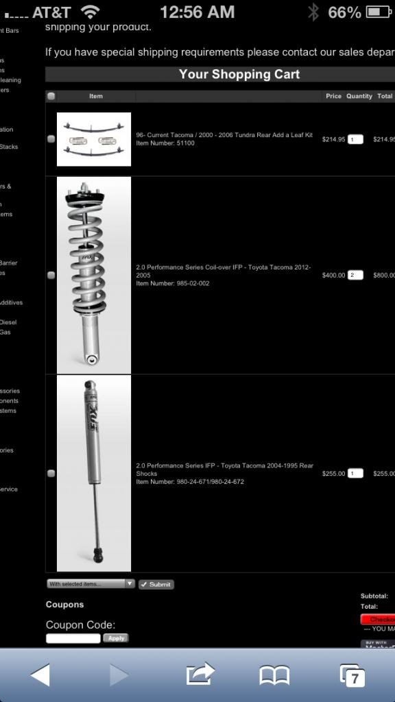

    Alright just brain storming and trying to see if I could save so e money and still have my needs covered
    With this setup what would be the big loss? Over the other? I don't plan on jumps or anything I just want to be able to fit the big washouts and ruts where I drive a lot at 30-40 and not have a problem would I be okay with this setup? I know the other would be best but trying to keep wife happy she didn't like my other idea as much as I did

    A 2.0 coilover isn't ideal....the bigger 2.5 one's are much better. Might as well get some 5100's if you're going that route. Just get the aal and a bigger ext travel coilover for now and UCA's when you can. I just wouldn't fully droop out the front with stock UCA's, otherwise they'll be fine.

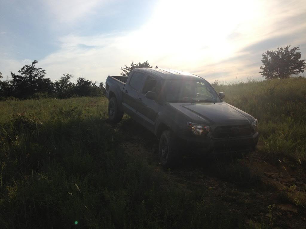

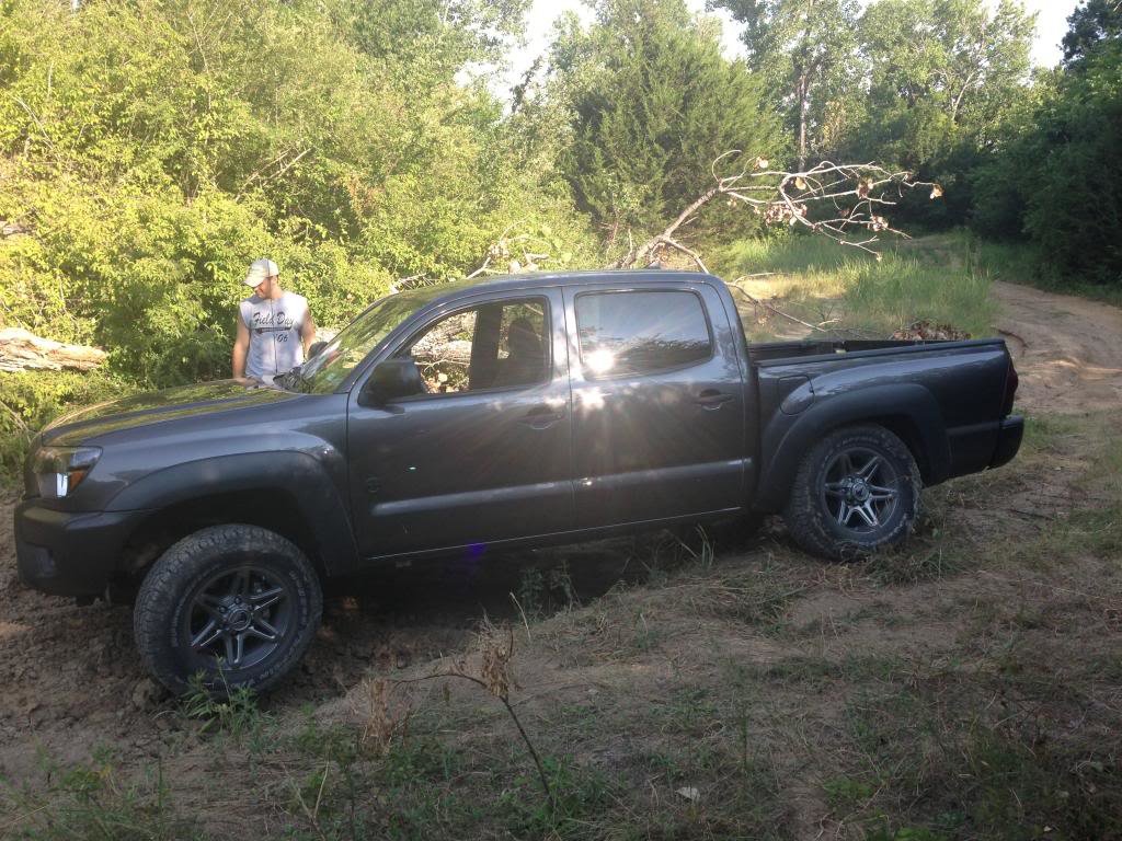

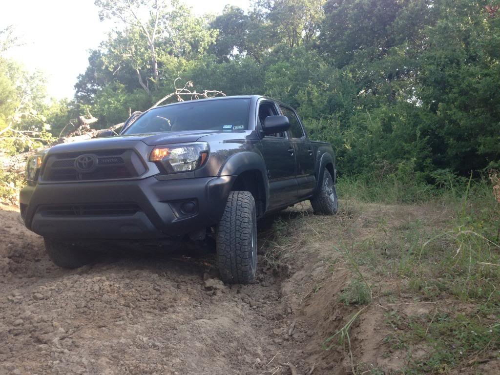

    No matter what setup it won't happen till the end of the year unless I come across a good deal on here I started this thread and talking to people so I do it right the first time.. Most of what I drive on is like this
    I am not sure if you can tell but the holes like in the last picture are what I am wanting to be able to hit and not feel like my trucks going in to a bottomless pit a fe run outs are a little deeper that I want to be okay to hit at 30/40 the deep ruts and hills I am not worried about speed but I am running out of flex (maxed in the first pictures)

    I really think I'm going to go with the fox2.0 co up front and the non resi in the back with the aal I just don't think I need the added cooling and or remote resi for what I will be doing... I hate to keep beating a dead horse but I don't want to spend a lot more on over kill but I don't want to screw myself everyone running the extended travel 2.5s that I see is jumping and doing some pretty harsh high speed stuff and the fast stuff I am going over us nothing like what I am seeing but just want to make sure I will be okay if I go with the smaller setup.. I could for sure do the fox 2.0 set up by the end of the year the ext travel I would have trouble with finishing the front end alone by the end of the year and have a mad wife..
