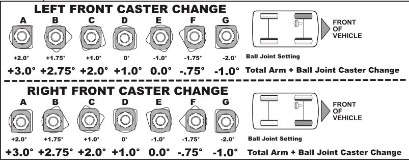

    I have my LCAs pushed all the way forward, I think I'm at 4'? Can't find my alignment sheet. I'm going to push the tires forward even more by reducing castor down to 3' or maybe 2' of castor. Probably set it at F. @Buttskevin21 what did you set yours at?

    21' TRD OffRoad 2" 887 OME on Bilstein 5100's. 285/70R17 General Grabbers G3 17x8.5" Icon TRD wheels (Gun metal gray) 4.75" BS
    This is not the correct image for the SPC 3rd gen Tacoma UCAs.

    Updated. [​IMG]
