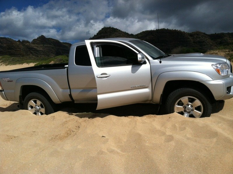

    I took the ultimate test this past Sunday and rode on Polihale (ultra fine sanded beach). Flattened my Dunlops to roughly 18 PSI (tires were hot) and didn't do too bad reaching an open spot.
    I kept eyeing a small hill which I planned to climb to get to an exit. When we finally called it a day, I champed it up the hill and failed lol. Dug out a ton of sand from the tires and placed a couple of blocks of wood in front each tire, gave it a go and basically turned those blocks of wood into fossils well beneath the sand. The sand was almost covering half the wheels, the mudflaps were bending, and my OEM "skid plate" was well into the sand. My gf took this pic after I freed a bunch of sand.
    Laughed, then asked my old friend that was next to us if he could pull me out with his Tundra. He asked what PSI I was running and told him, "About 15-18." He replied, "Try 5, or 10." *Mental Note* We bled a bunch of more air out and he pulled me out of the sand. Laughed some more, then looped around and took a flatter exit out.
