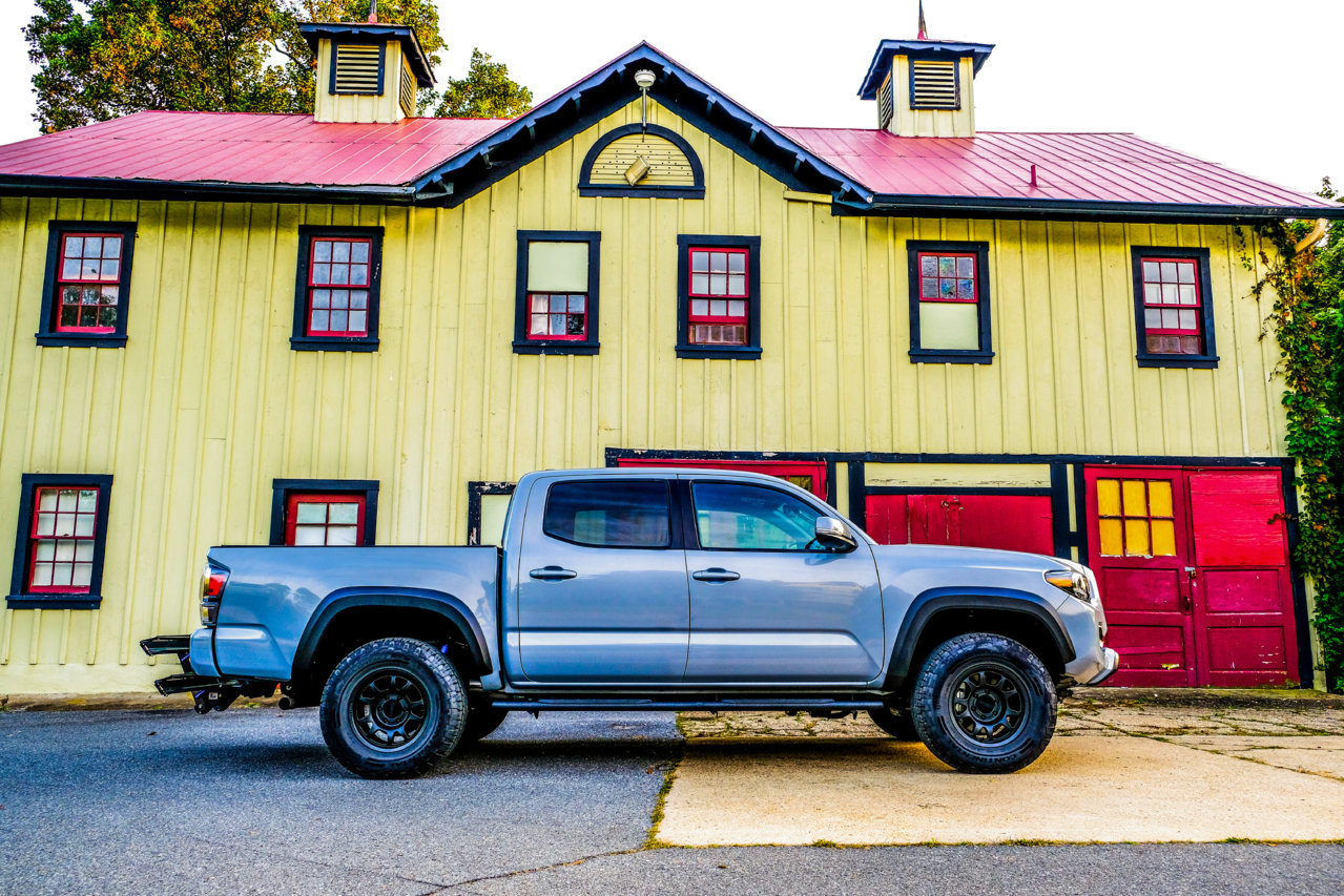

    My new setup on stock SR5 suspension - 16x8 MR150 Trailite and 265/75/r16 BFG KO2’s:

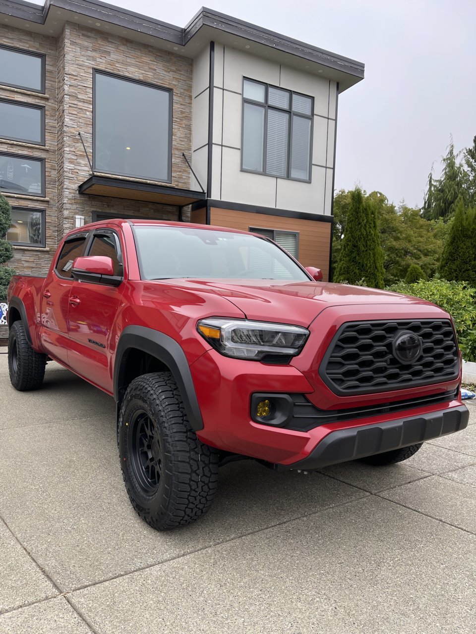

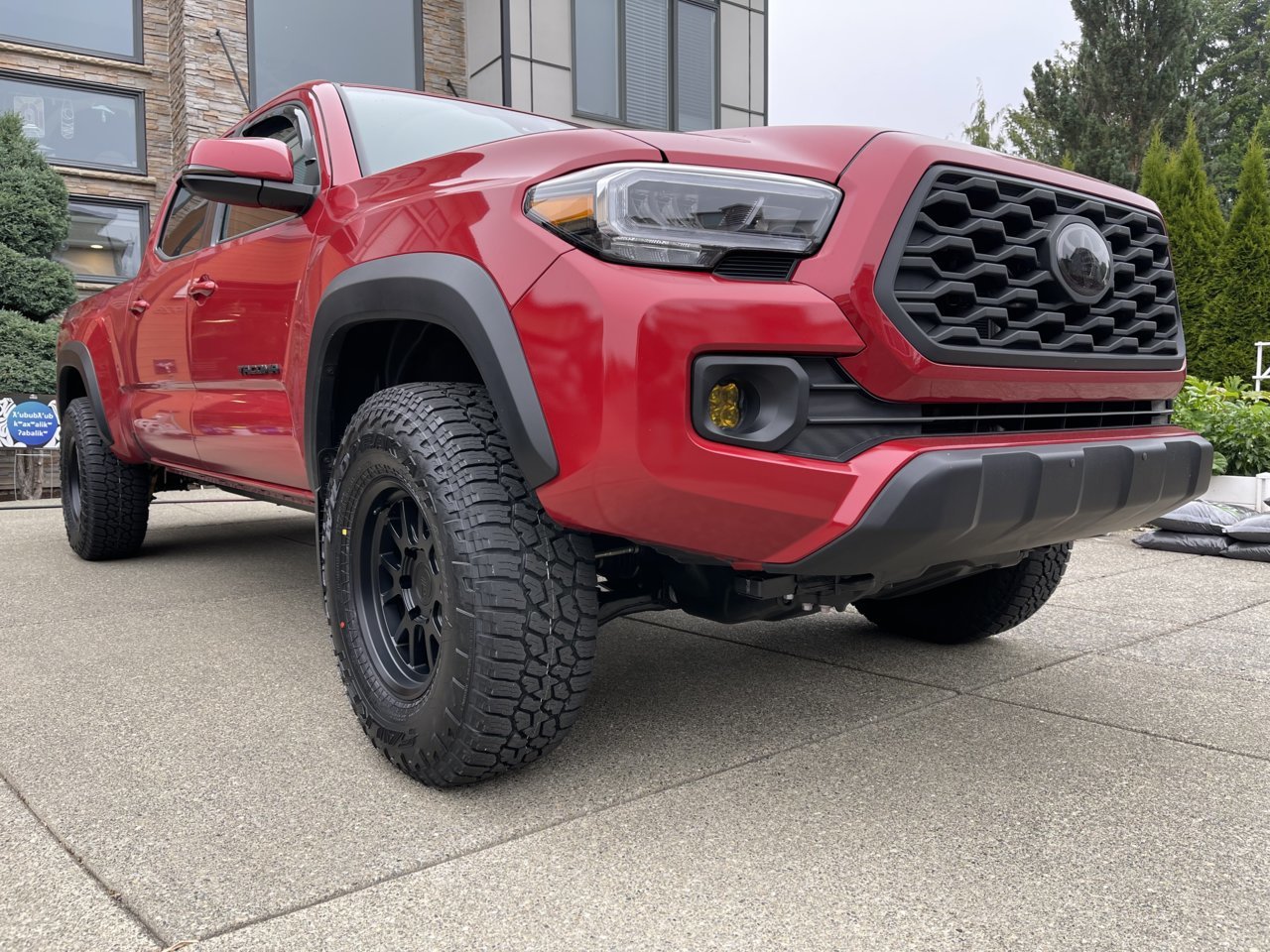

    MR149 16x8 on 265/75 Wildpeaks

    FYI: I heard it rub twice on both sides of the inner mud flap while on full turn. Not a big deal to me since I don’t drive the truck as much but removal of front mud flaps would be the simple fix.

    Stock mudflaps? I have the rokblokz flaps and have never had any rubbing, but the stock ones protrude a bit more

    Yes, oem mudflaps. I’ll try to take pics next time for reference.
