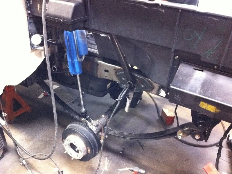

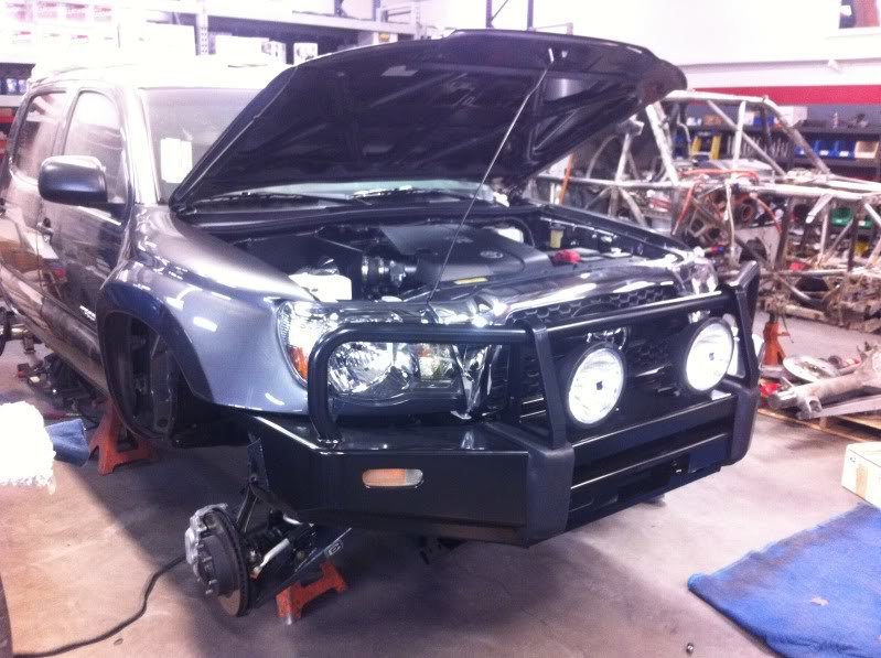

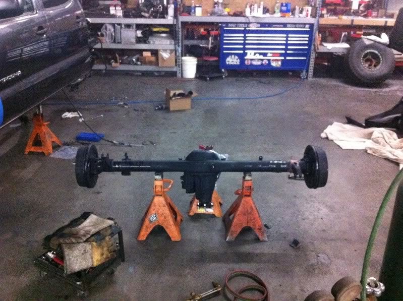

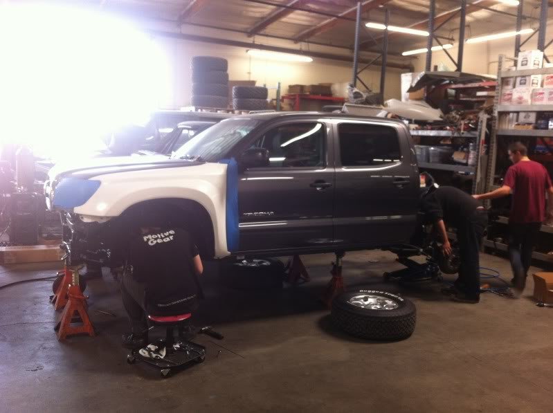

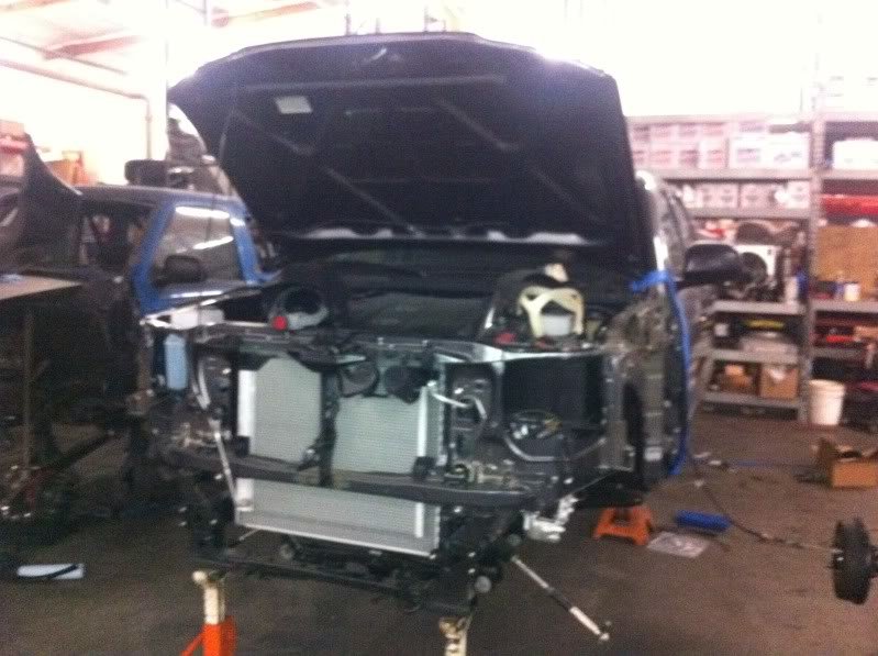

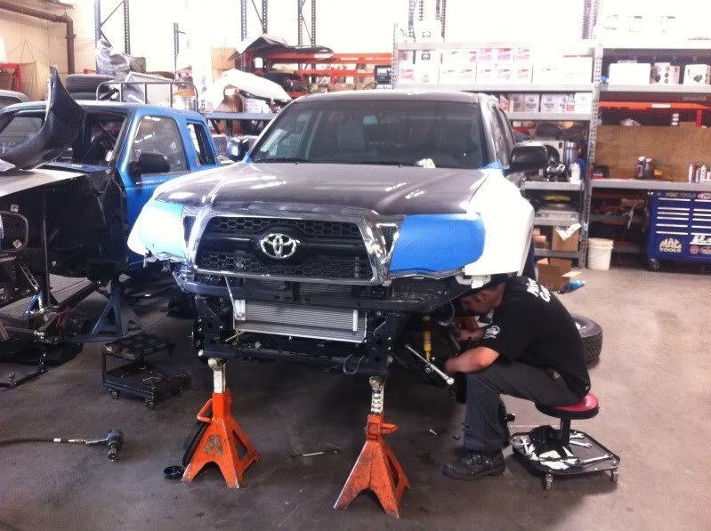

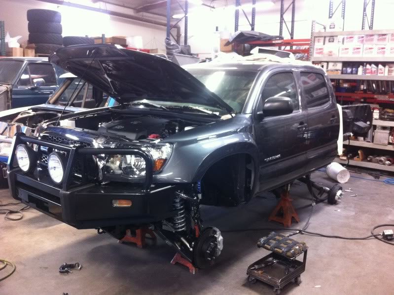

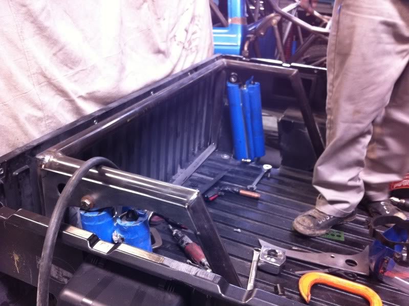

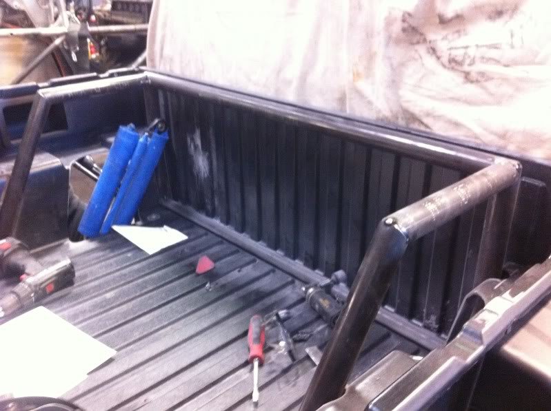

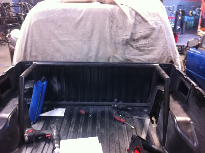

    So I thought I'd share a little project we took on at Camburg.
    Late November I got a call from a guy over in Russia who was interested in building a rig that could be used a higher rates of speed at an elevation of 12,000+ ft. You might think this is a toy, but you'd be wrong. This sucker is a Wolf Hunter-Hunter. He protects the Wolves from hunters in a 500KM area of Russia.
    I was skeptical, but proceeded to send him a quote. By the following week he had purchased a brand new 2011 Tacoma 4WD Double-cab Short-bed 6-Speed in San Diego.
    I went down, picked up the truck and the rest is history.
    We are nearing the end of this build, and I can't wait to see the finished product.
    Specs
    Front:
    Camburg Tacoma 4WD Long Travel Kit
    Fox 2.5" Remote Resi Coilovers
    Fox 2.5" Piggy-Back 3-Tube Bypasses
    Extended 4WD Axles
    Rear:
    Spring Under Axle Leaf Pack
    Fox 2.0" Bump Stops
    Fox 3.0" 3-Tube Bypass
    Other Equipment:
    Bed Cage + Veritcal Spares (Spaced to maximize cargo room.)
    4 Jerry-Can's
    ARB Front Bumper
    Hella Rallye 4000's
    Glassworks Front and Rear Fenders
    KMC Enduro Wheels
    Nitto Trail Grappler Tires
