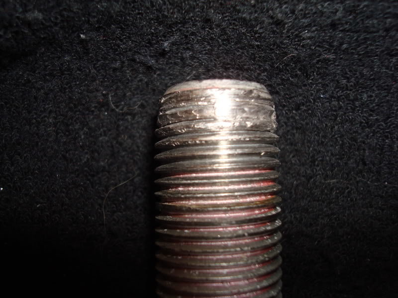

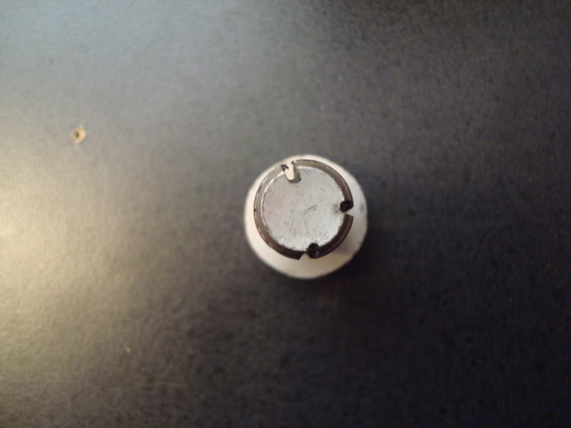

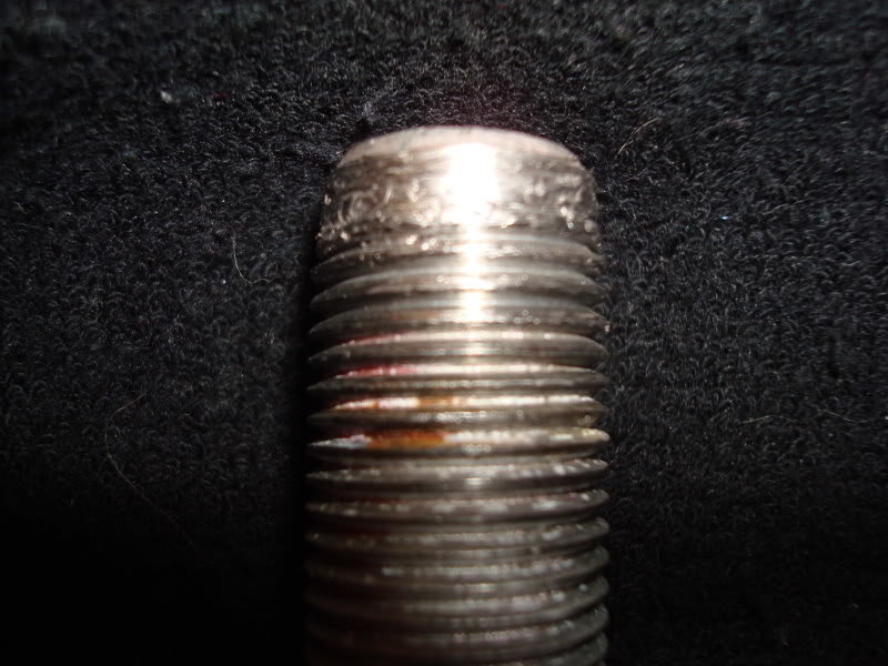

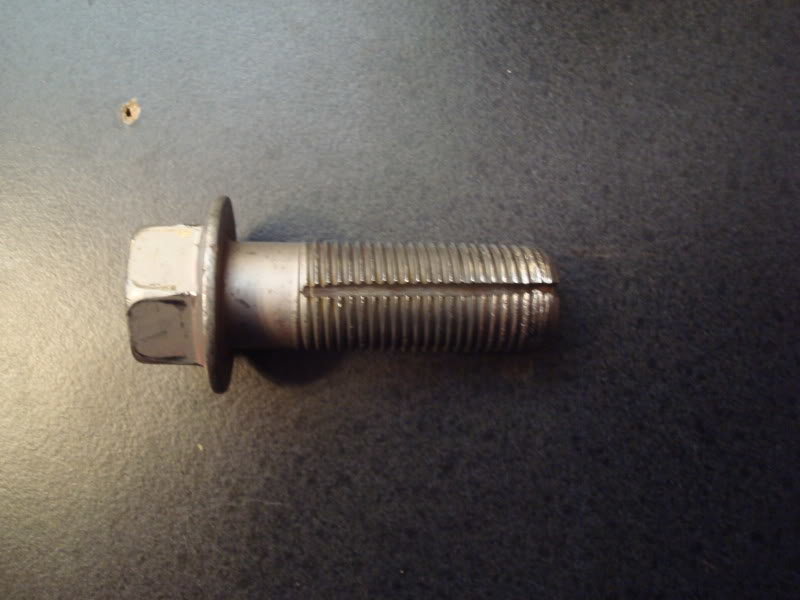

    After going to six different shops that refused to touch it due to it being too much of a "liability", I found a place that was able to help me out. At first the owner said he didn't have a tap big enough to help me, but when I happened to mention I had bought two replacement bolts just in case I needed them he got very happy. He asked if he could destroy one of the new bolts and use the other one to fix it. I told him as long as it is done right and I don't have to worry about it breaking.
    So, he took out the bolt I jacked up:
    Then made a tap out of one of the new bolts:
    And now it is good as new. I did not know you could make a tap out of a bolt, but it worked like a charm. He was done in about 30 minutes and charged me $19!!!!!!!! In my 11 years of driving/working on my vehicles, this was the first time I had stripped or crossthreaded a bolt and I thought I was in for a big repair bill, so I am happier than a pig in sh*t that it was so easy/cheap to fix once I found someone to do it!!
