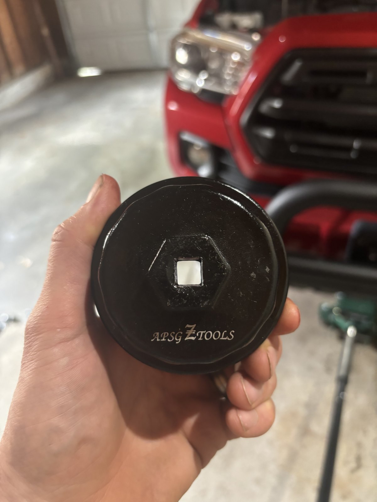

    I just finished doing an oil change. And this is the one that I bought from Amazon it fits snug, but I can get it off easily.
    IMG_0799.jpg and no, I did not use that jack in that spot to do the oil change lol. I happen to be painting my calipers.

    Did you use the 3/8 drive to spin off housing or hex socket ?

    Yes. While the wrench was still on the filter housing, I just wiggled the 3/8 extension back-and-forth and it came off easily.
