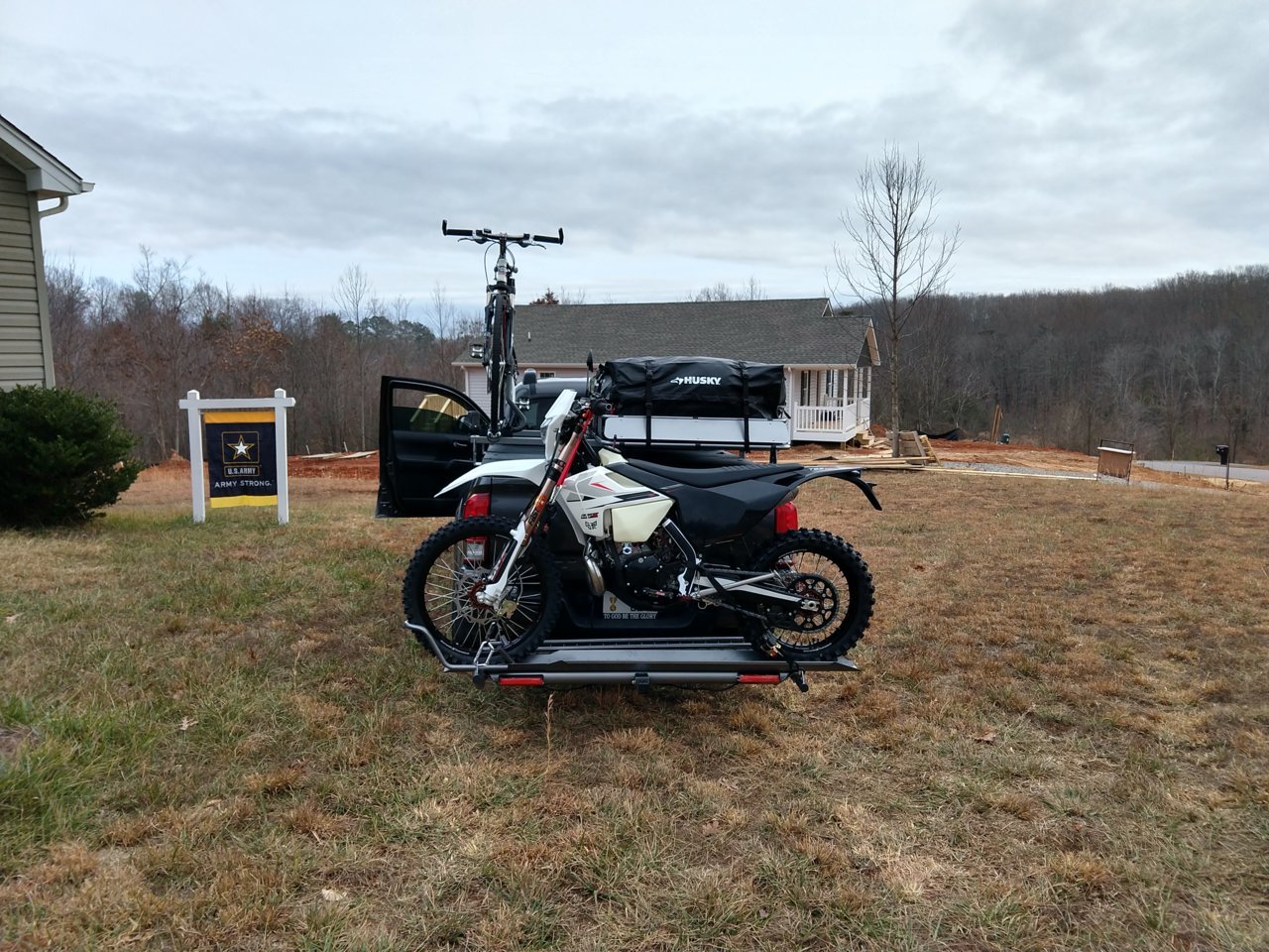

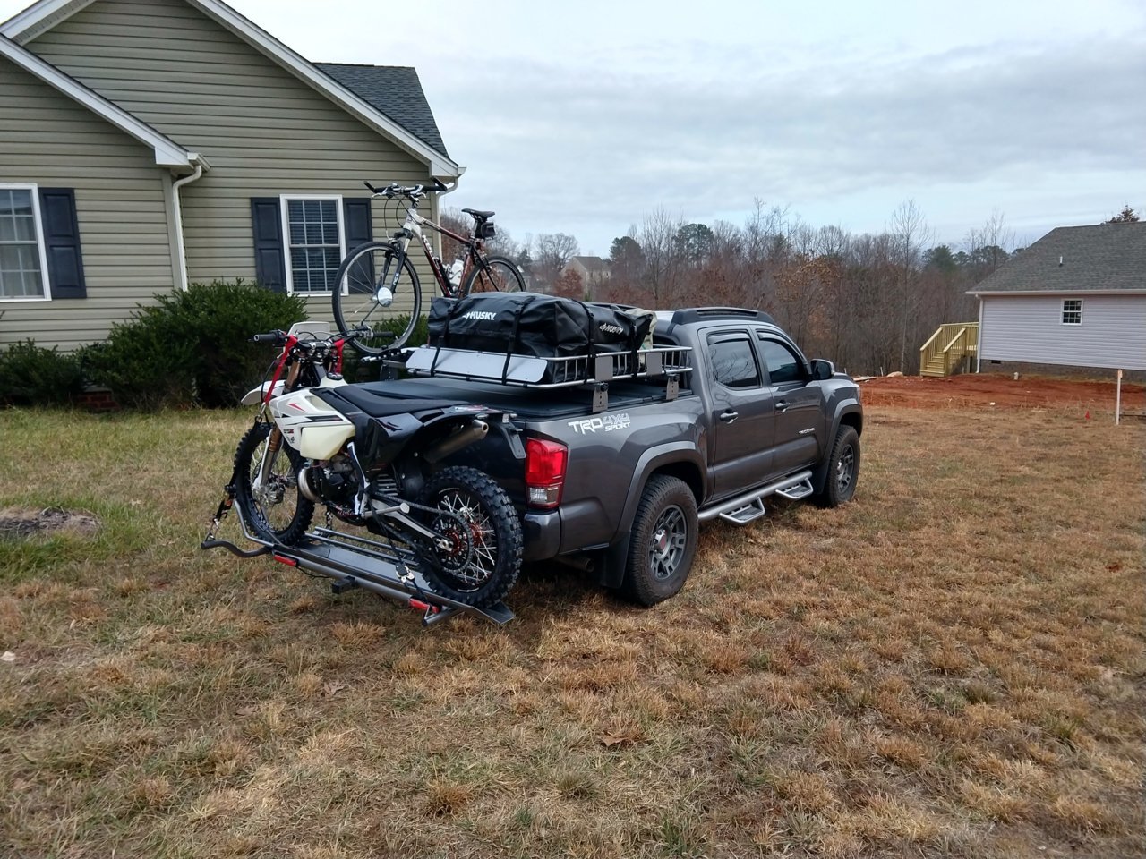

    For your consideration...Mototote, KB Voodoo cross bars, Volvo bike carrier, and generic Amazon cargo basket...

    KBVooDoo is local to here - nice! Thats quite the set up - I love it. Mototote looks like a solid option. Quite a bit more money than the ones linked above. hmm

    The MotoTote is worth it...great design and a solid Father/Son company out of Texas...great customer service and may hook you up with an off-season deal or military discount possibly...I would buy another one in a heartbeat...mine is powder coated gun metal grey btw; they come black...they have two versions available and mine is the lighter duty sport version which is plenty for dirt bikes and dual sports etc.

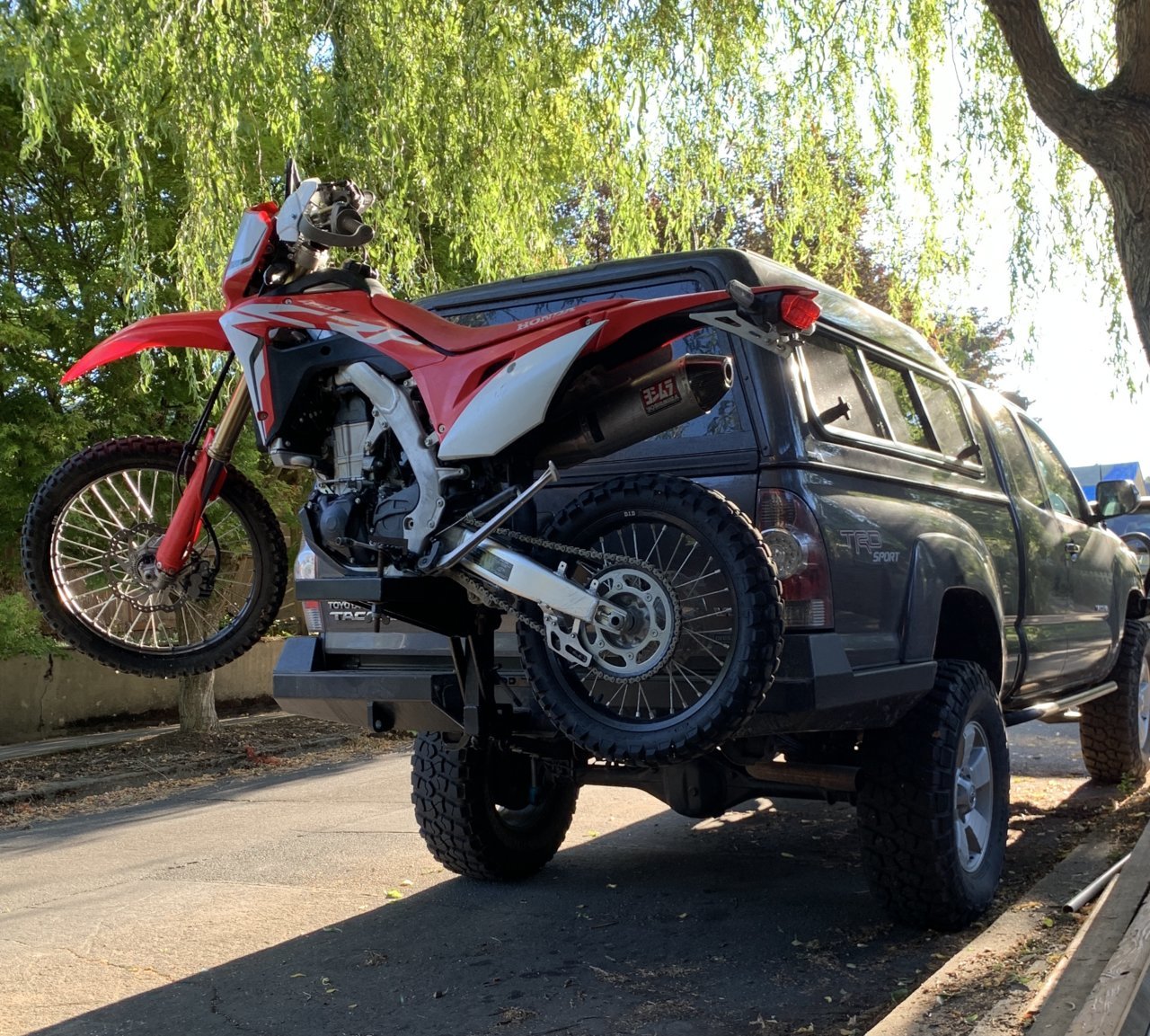

    My new to me Tacoma has a bit more lift than my old one that I originally purchased the Motohauler for. Let’s just say ground clearance isn’t a problem. D87A8048-840A-42D8-85FA-7F39E984ED14.jpg

    are you able to open the tailgate with it in the hitch? i read differing things so i didnt want to mess with it and jacks going out eventually. do you tie the front bars down so they dont move?

    No, you can’t open the tailgate with it on the hitch, which is annoying. I actually fabricated an extension that moves the motohauler back just beyond the tailgate’s arc and raises it a few inches for more ground clearance (helpful for my last Tacoma, unnecessary now). It worked for my old taco with the factory hitch; unfortunately it doesn’t fit in the CBI hidden hitch, I planned on running it upside down to lower the hauler a few inches. And yes, you tie the handle bars down with a ratchet strap.

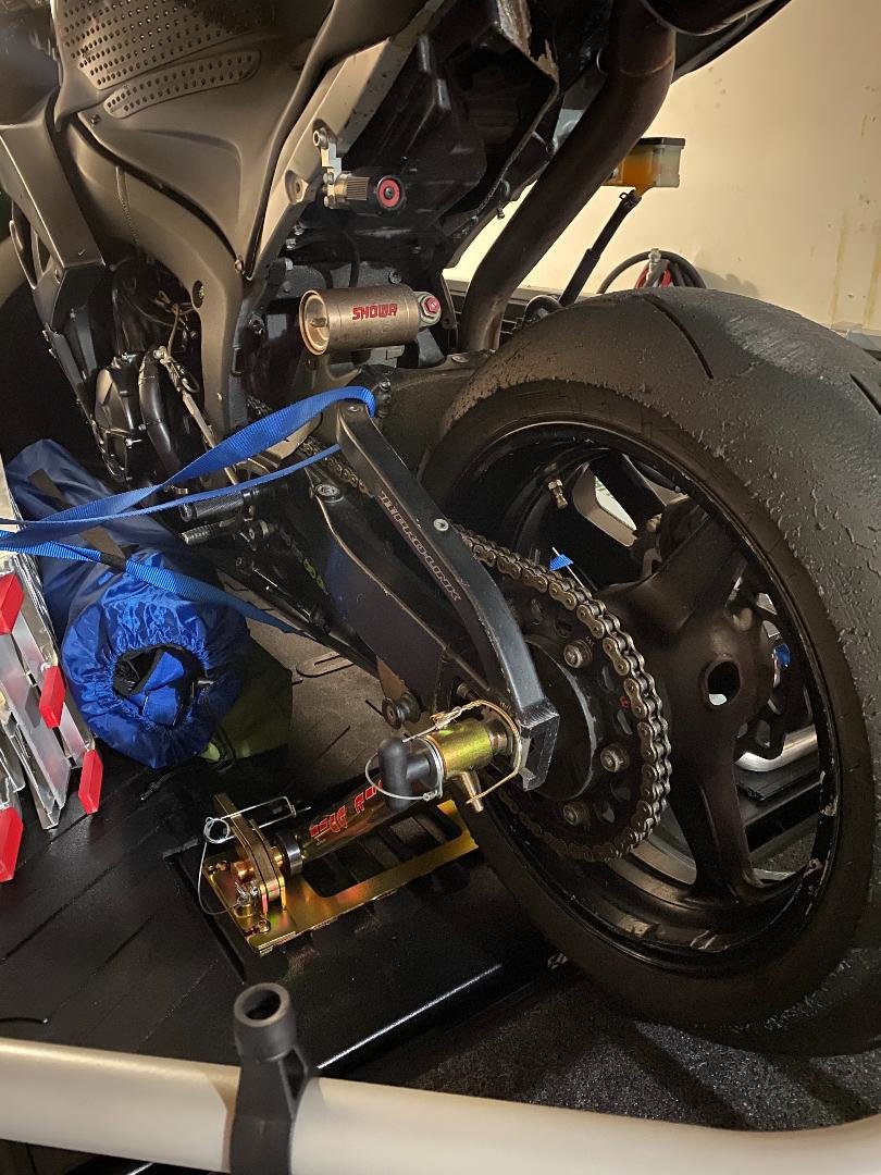

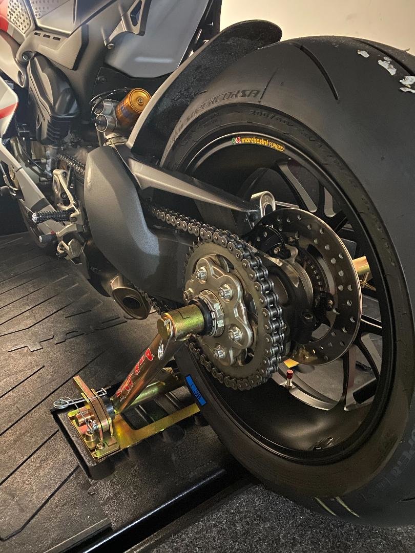

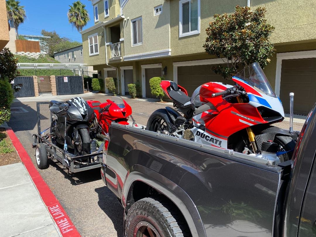

    Took the V4 and a couple 600s to the track this weekend

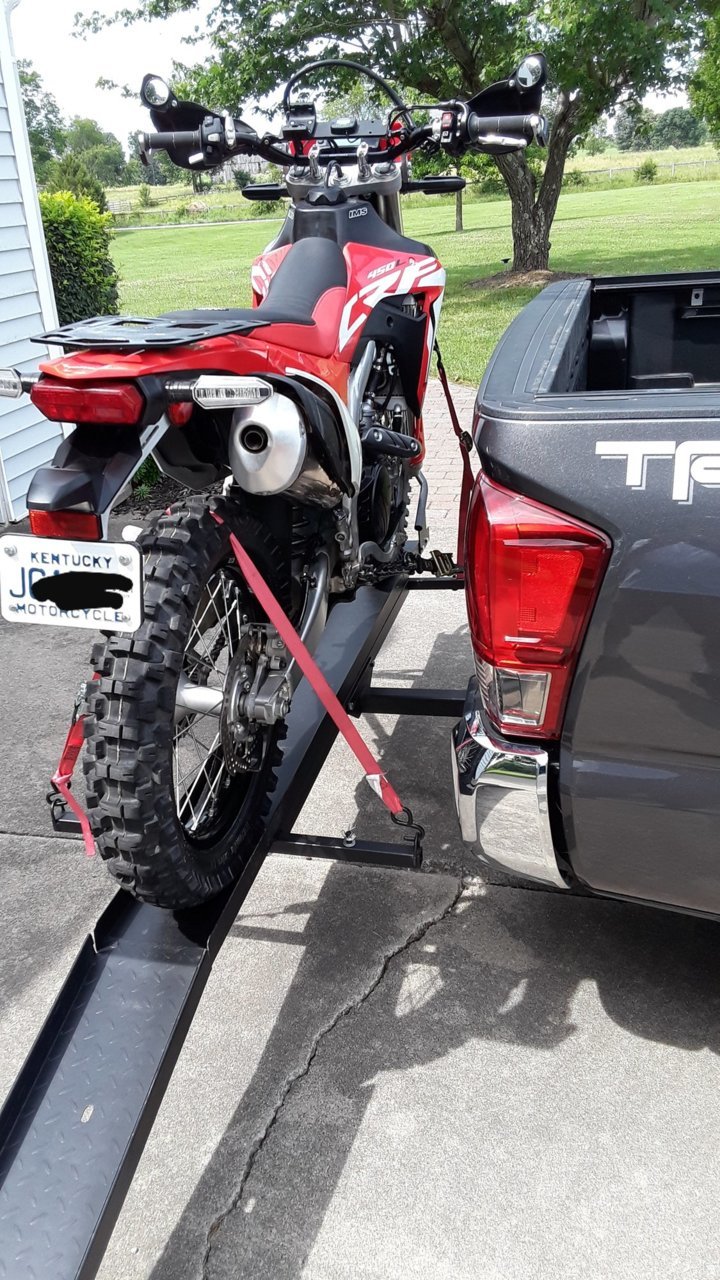

    I have the Black Widow MC 600
    It works good for my CRF450L.
    Next I would like to sell the bed cover and add a camper shell.

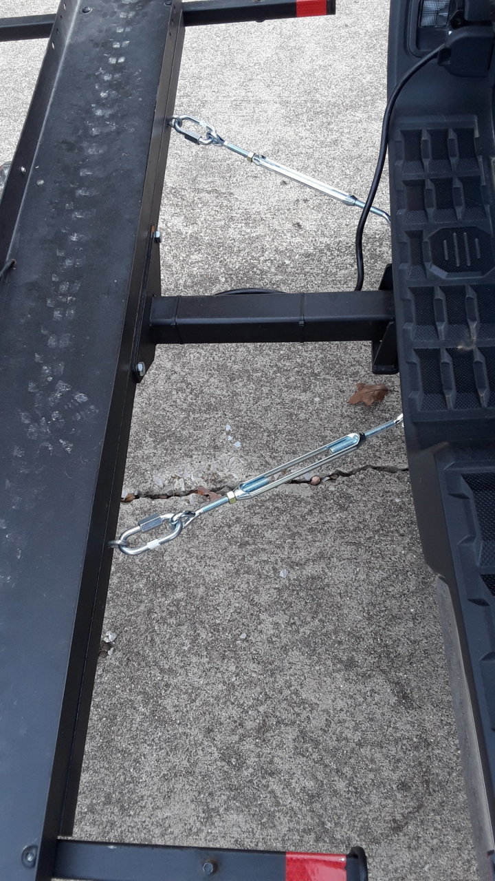

    I also added some turn buckles to remove some of the rocking on rougher roads
