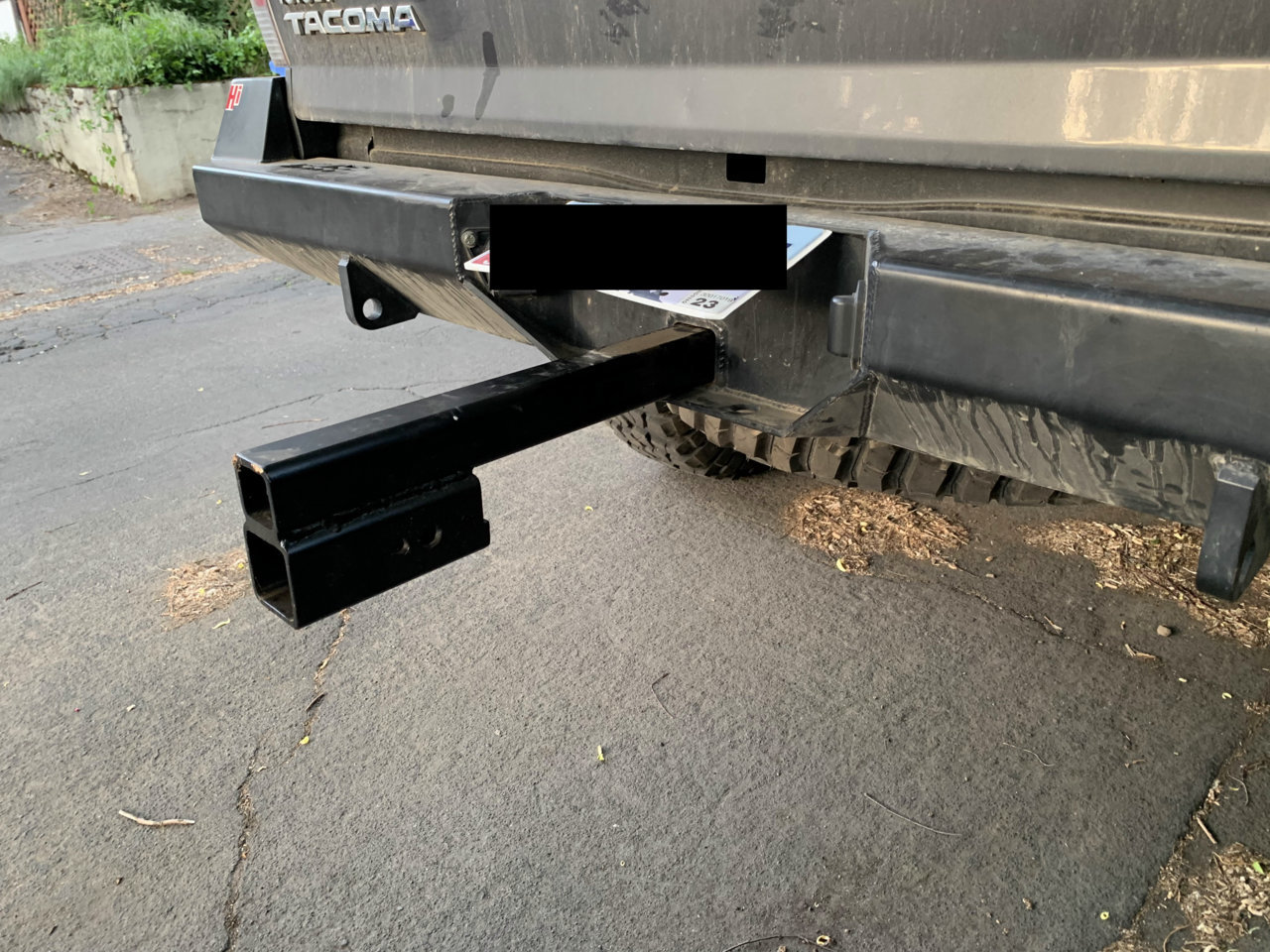

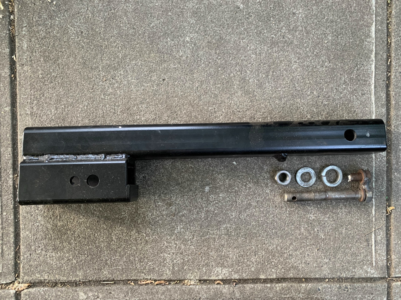

    I have a motohauler (same as the mx hauler), I welded up a hitch extension that lets me open the tailgate. My new bike is under 250lbs. It might be close with my bike; I don’t think I’d do this with a bike over 300lbs. The extension is really simple—just one square tube resting on top of another, but I can send a pic if helpful.

    Yeah send that over would like to have a look at it. Ideally I would like an mx hauler if i can figure out the tailgate issue. I thought maybe a drop down but then it might be too low?

    Drop bracket lift and booger welds

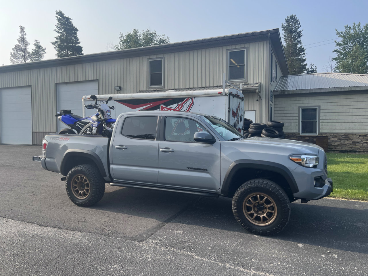

    old fashioned way, I guess. 2 ProTaper straps, g2g

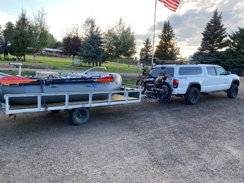

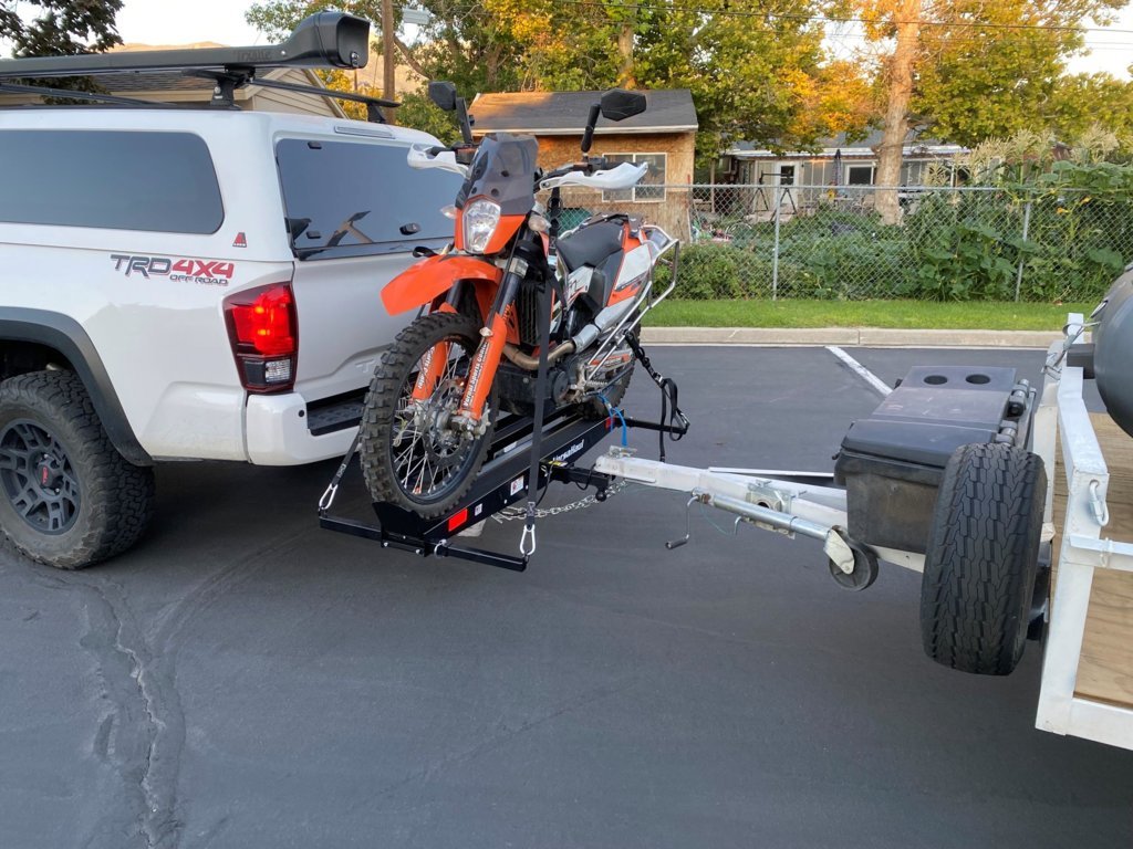

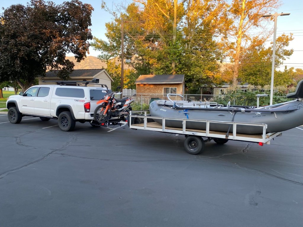

    Here is my setup. I wanted a way to take my bike on river trips so I could use it as a shuttle. I was going to modify my raft trailer to allow me to load my bike up onto it but decided to try the Versahaul since it has a receiver in the end of it. This also allows me to pull the trailer without the bike if I want to, or to only haul the bike without the trailer. I also keep the shell on my truck all the time so didn't want to load the bike in the bed. I took it out a couple times this summer and it worked beautifully, although the rear of the truck does sag a bit with everything loaded up so I am contemplating adding some airbags. Other than that, the only real "issue" is that I can't really get into the bed when the bike is loaded up. Not a big deal, it just means I have to be a bit more thoughtful about loading and unloading everything. The bike is very easy to load and unload, a lot easier than I thought it would be actually.
