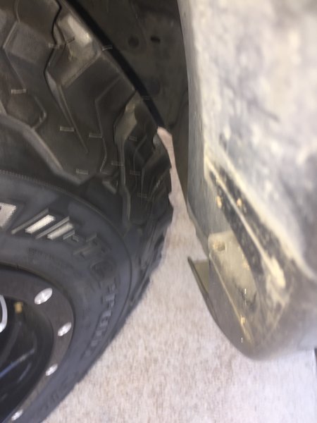

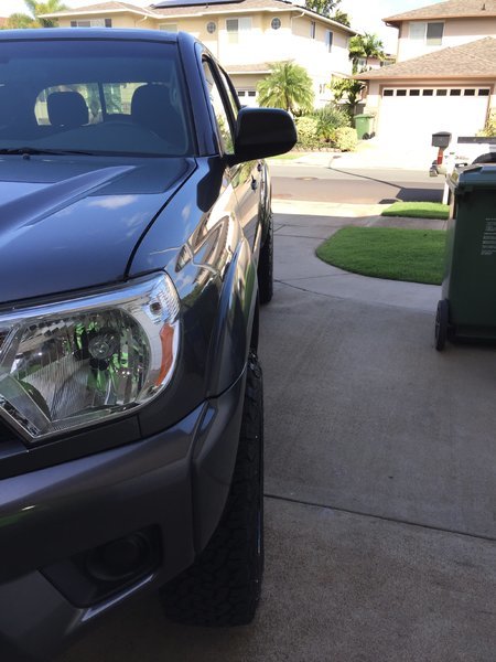

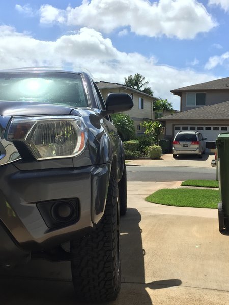

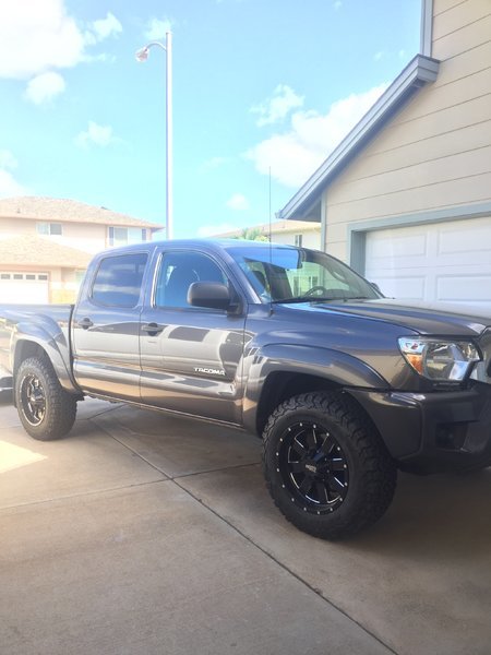

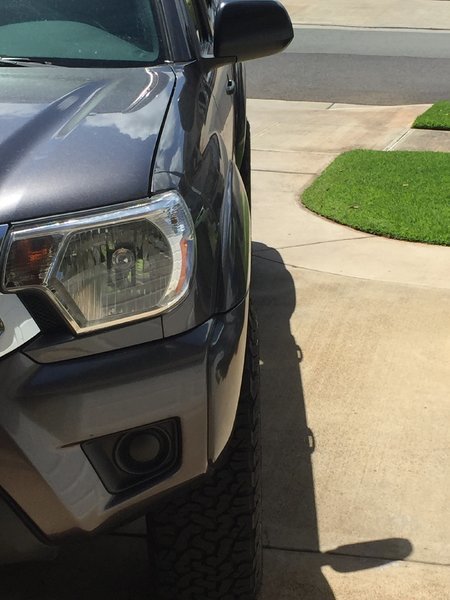

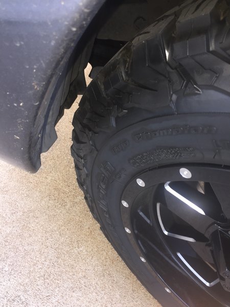

    So i got the same spec wheels 18x9 0mm offset 5" backspacing moto m0962s and rocking bfg ko2s 265/60/18 and she fit good with an inch to an inch n a half play lock to lock so prolly wouldnt even need to take front mud flaps off. But with that play im thinking bout going 285/60/18 next time for a wider stance. Il post pictures tomaro. Ast far as stance wise it pokes out only a lil bit not too noticeable so gaurauntee pass safety check.

    Sorry for the late reply but heres those pictures
