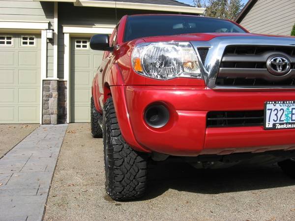

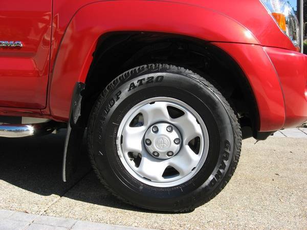

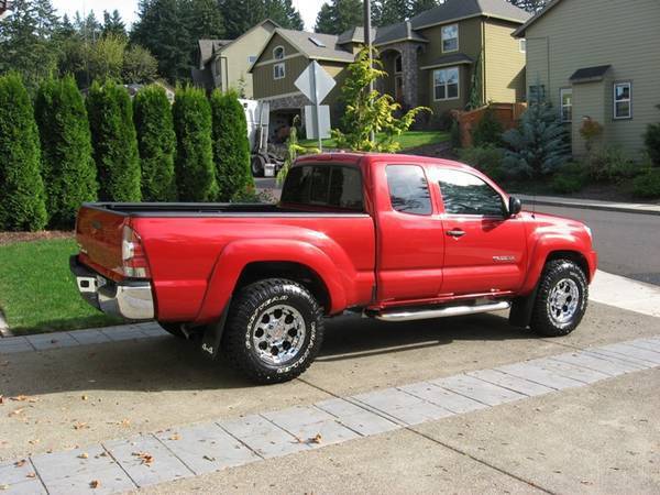

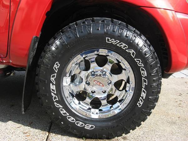

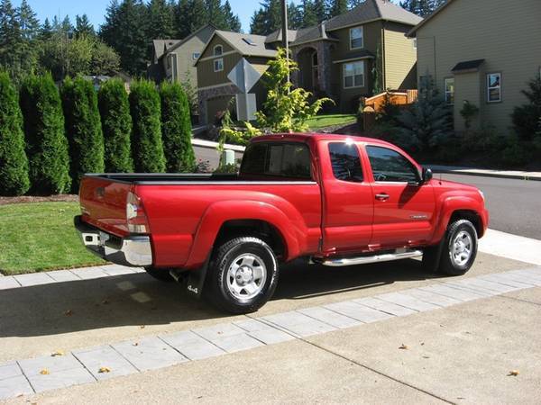

    Got tired of the cheapo steelies and Dunlops that were on my truck, so I pulled the trigger on some new Moto Metal M0955's and new rubber to go with them.
    Before
    After
    Before
    After
    Before
    After
    As you can see, I like chrome! What do ya think about them?

    These are 265/75-16's. Stock suspension. Yes, I do have a little light rubbing now....nothing at full lock, but with the wheel turned about halfway and making a slow turn I am touching the front mudflaps. They clear everything else. I'm going to have to deal with this, either trim the flaps or lift it up above the problem. I didn't start out wanting to lift it, but maybe I'm forced to now. :D

    It looks like he had on the stock Dunlops at 245/75R16 and went with the Duratracs at 265/75R16 with the Moto Metals.
    As far as rubbing the Moto Metals have a different offset than stock so they stick out farther which would help in eliminating any rubbing.

    Don't know what the MPG is yet, only had them on for 3 days now. I'm sure it will be a little worse.
    You're right on the tire sizes. And yes, they stick out farther...different size, different offset.
    Steelies = 16x7, 30 mm offset (I think)
    New Wheels = 16x8, 12 mm offset
    Less offset on the new wheels and 1 in. wider made them stick out farther. They cleared the UCA and caliper, but because they stick out farther they rub the mudflaps. I tried a 16x8 with -6 offset, and they stuck out even farther and rubbed the mudflaps bad!
