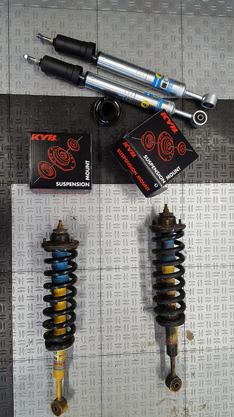

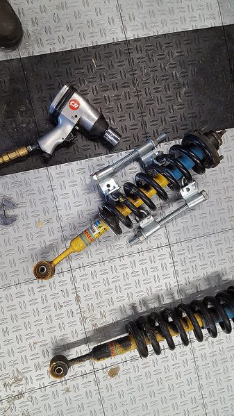

    After an ill advised spacer install to stop the front tire rub while, I said screw it and got 5100s. Still debating what I will do in the end for suspension.
    My crappy spring compressors were not cooperating. Took way too long to do this.

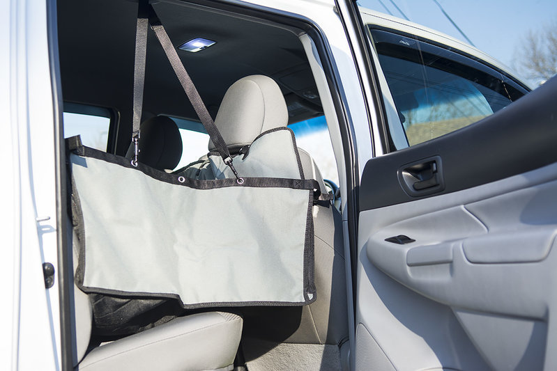

    I wanted something to protect the rear seats from the dogs. They shed like crazy. The big one likes to get up front. The little one likes to stand on the door arm rests. Basically they just destroy things. But they're dogs so....they're the best.
    Everything I found was a terrible color or didn't meet my requirements. Then I found this from Duluth Trading Co of all places. Matching grey. Solid across the front to prevent center console stepping, sides to keep them off the doors. Fits and matches damn near perfect.

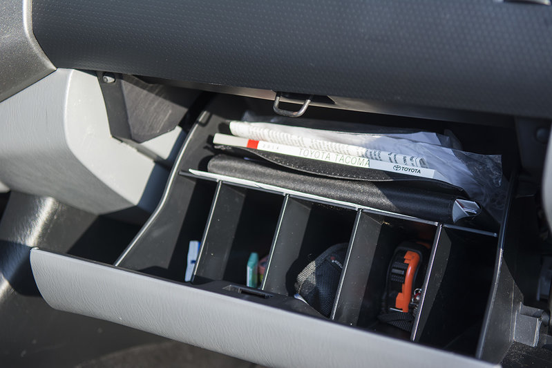

    Really liked these @salex organizers so I had to get those.

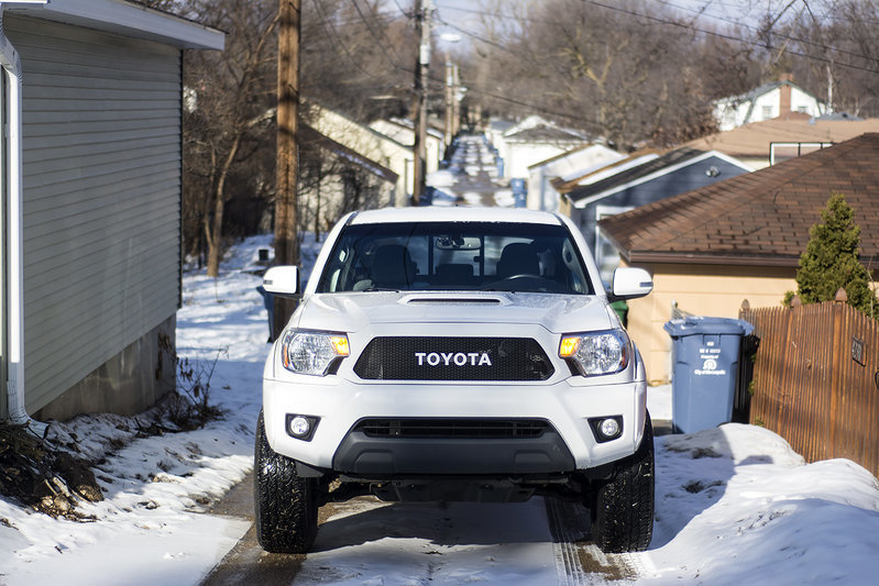

    Well I put in 5100s and interior LEDs so I figured I needed to complete the TacomaWorld trifecta and do a grill upgrade.
    Count me among the minority that prefers the "thin lip" style grill, it was just a matter of deciding what material to go with. I liked the few I saw from CustomCarGrills and the price was right so I grabbed the Perf SS in flat black. Figured the white vintage style OEM Toyota emblem would look nice so I opted for that as well.
    Longest part of the process was just trying to get the damn grill out. Several attempts and internet searches later finally made me realize that it was just the eight tabs on the bottom that needed to be squeezed and pulled straight out. Cut, zip, glue and set. Put it on today and I like the results.
    The guts behind it don't show up as much as they do in the photo, truck is pointed uphill at a low sun. I dusted it all with some black paint before reassembly.

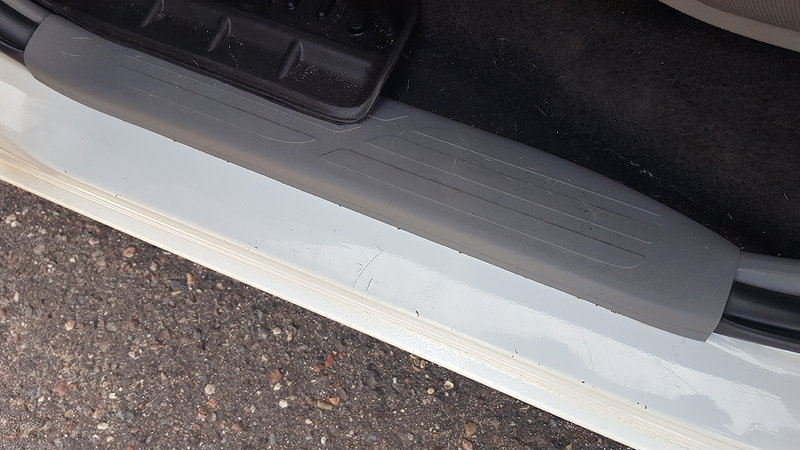

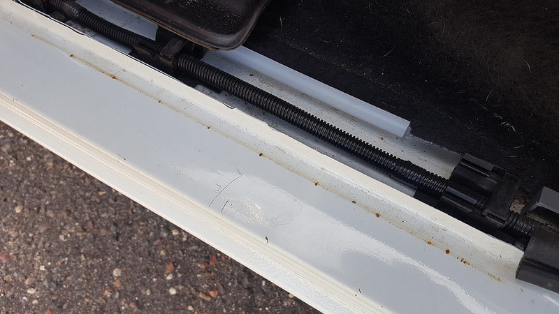

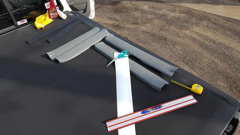

    As the weather is getting consistently nicer, I'm starting to get going on some other projects. The one I was least looking forward to was first. Toyota in their infinite wisdom has no protection on the door sills, thinner than paper paint and jamb covers that rub through. This all needed to be fixed. This has been documented before, but....here we go:
    All four needed to be addressed, some worse than others. This is the front driver side.
    Cover off.
    The passenger rear for some reason was the worst. PO must have used that side a lot for something, though wear everywhere else is near non-existent. Sanded through everything with 80 and then smoothed it out from there. Didn't take much elbow grease.
    Cleaned it up with some solvent and shot primer.
    Followed by a couple light coats of Dupli-Color Toyota Super White, couple light coats of clear.
    Let that sit for a few days and then it was time to reassemble.
    Here's the main culprit. The little knobs on the edge where my thumb is. A few swipes of sandpaper made short work of that to leave an even, smooth surface.
    My extra layer of protection was some 3M clear bra. I cut strips and applied that from the seam of the door jamb past the 90* towards the rocker. And then some G Tek sill plates over the whole thing. Now I can use my truck like a truck.
    Cross that off the list.
