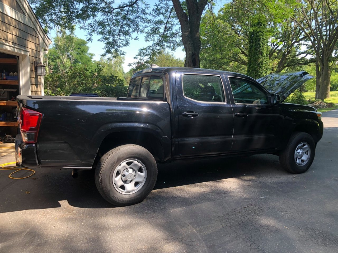

    I really wanted a 2015 DCLB but after searching and searching I only found beat up and high mileage 2012-2013's for over $20K. These trucks just hold their value too well.
    I didn't really consider a GEN 3 but came across a previous fleet vehicle at one of the dealerships nearby. The paint was rough and it didn't even have keyless entry. But it did have only 25K miles, still under factory warranty and no rust at all which I could not say about any of the GEN2's I looked at. So I thought why not?...I'm going to modify it anyway. Why not spare myself the added expense of nice wheels and stuff I'm going to replace anyway.

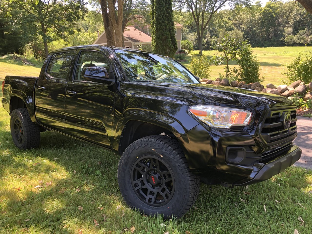

    2018 SR DCSB V6 with tow package....and not much else
    67086504_10158620569189418_8342585535637_997a3cb3d36f95a3a149fa84921455a9ecb8cb56.jpg
    66825558_10158620565804418_5823159678309_1cc6fcb4404ad32f1b22b6e0dc13c304e9d2a636.jpg

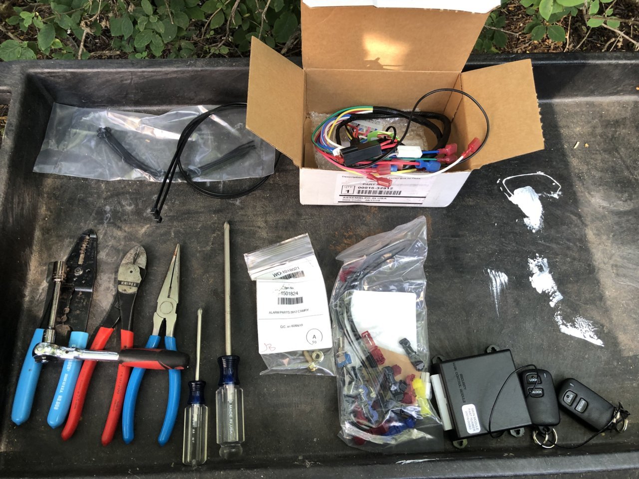

    I got to modding the truck right away. First order of business was adding keyless entry. I was not going to deal with unlocking the doors with the key all the time.
    I made I decent thread about the install process if anyone needs to reference it:
    https://www.tacomaworld.com/threads/installing-oem-keyless-entry.619447/

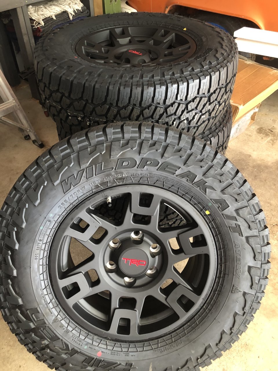

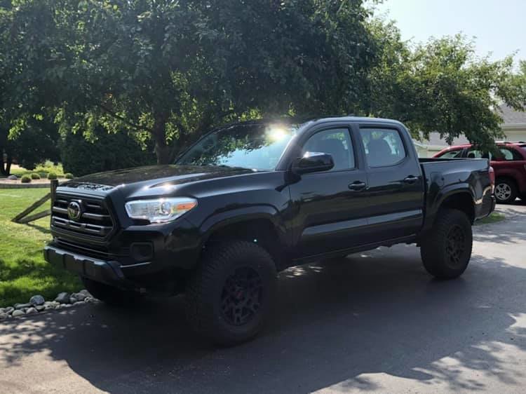

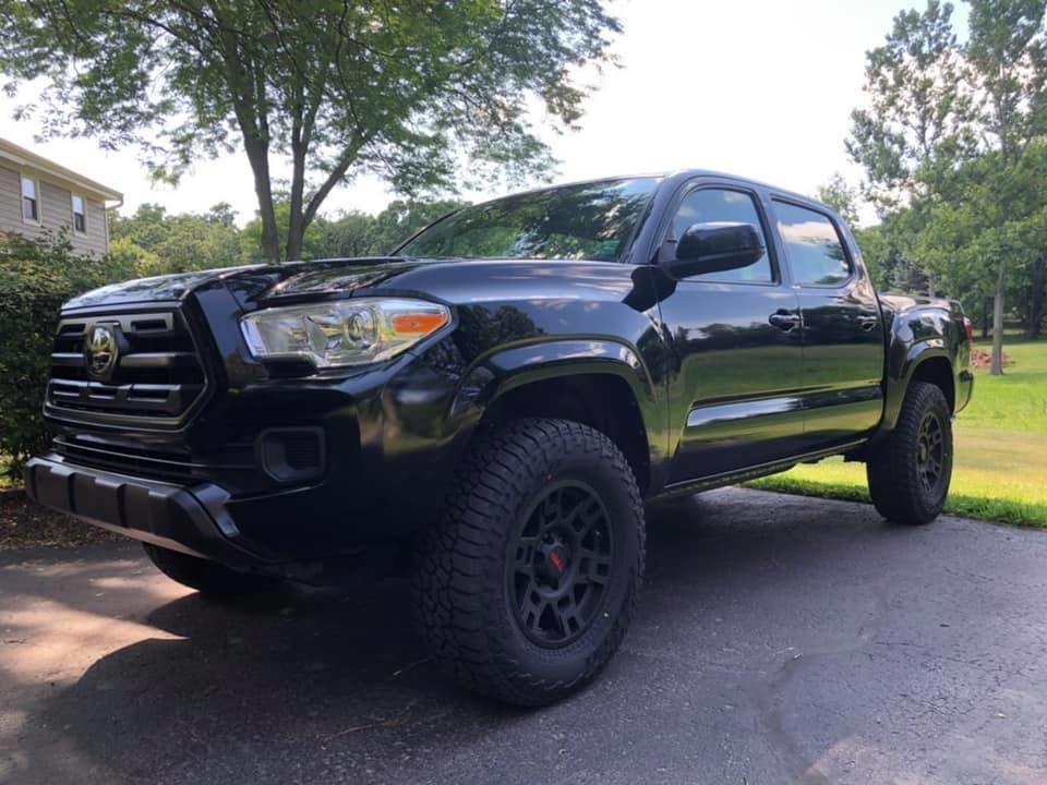

    Installed some TRD Pro wheels with 265/70/17 Falken Wildpeaks....how original of me I know...but it's hard to beat how great these wheels look for the price. I pulled the chinstrap off too.

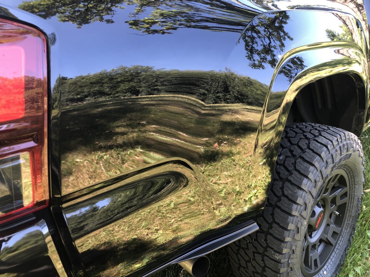

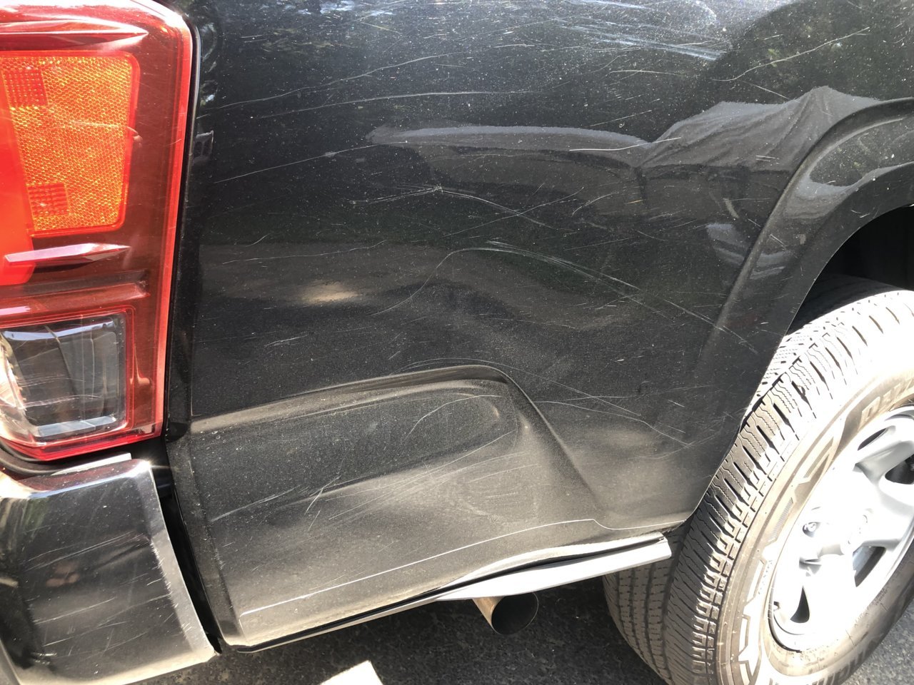

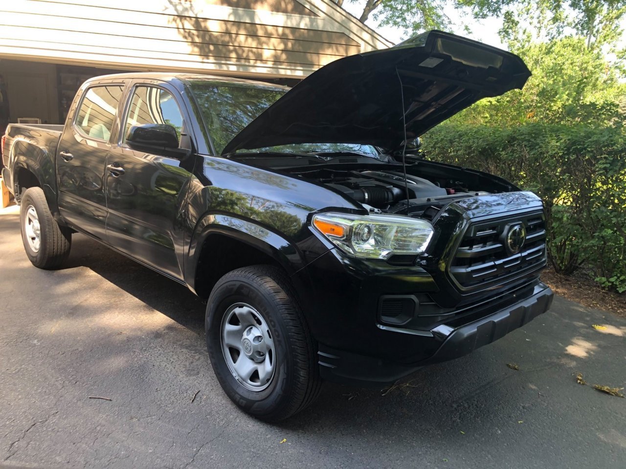

    After the wheels and tires were on I decided to give the truck a much needed detail. Inside and out and top to bottom. 3 stage paint correction and polish and a full interior detail including shampooing the seats, carpet and spot cleaning the headliner.
    Before:
    After:

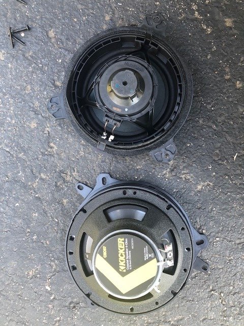

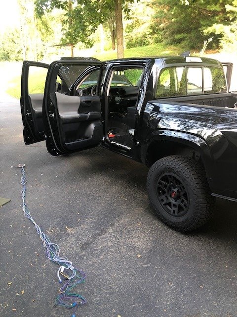

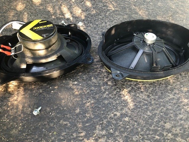

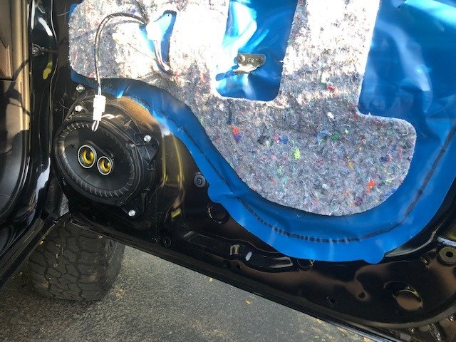

    Once I had that squared away I decided to upgrade the stock speakers and add a sub. I'm an adult but I always like a little extra bass and some decent door speakers in my vehicles.
    72761186_10158916721064418_7387851843751_7aee3db51fc57ce6783cdf6f2c6f2826c46293a5.jpg 73087552_10158916721379418_2181417441576_862a69fd9d05d898003a1e8cae564ee767526075.jpg
    72983162_10158916720634418_1045384869363_eb17040ee1ad7aedf9cb88edcbfeac2706d86572.jpg
    72332544_10158916720584418_7684983015637_2d653f2d95b14ac942c27dd4f675510da406888f.jpg
    72843600_10158916720639418_6108665795359_29b2e9efe2a2b6156cba1d6d1d99d49b3d72e01b.jpg

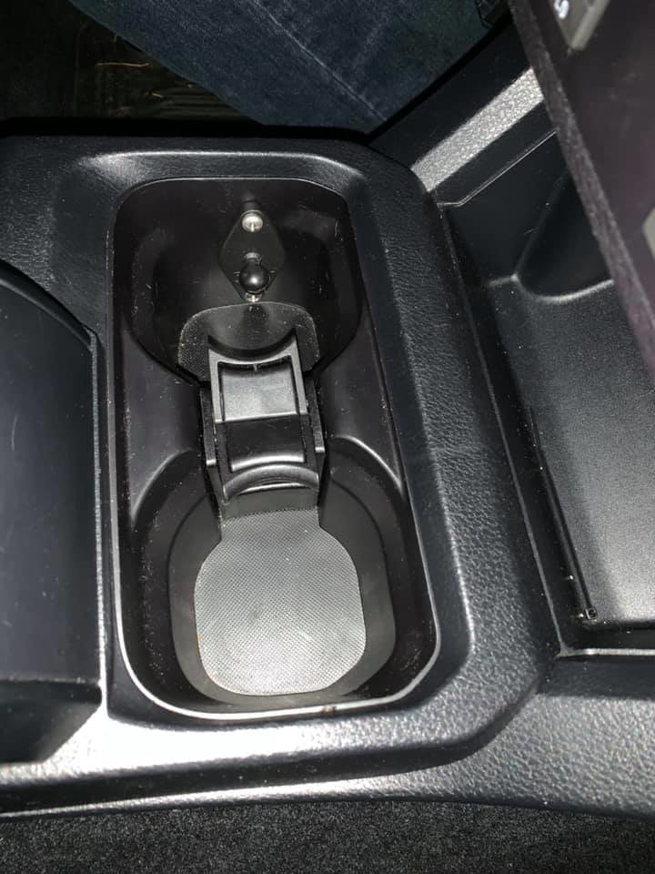

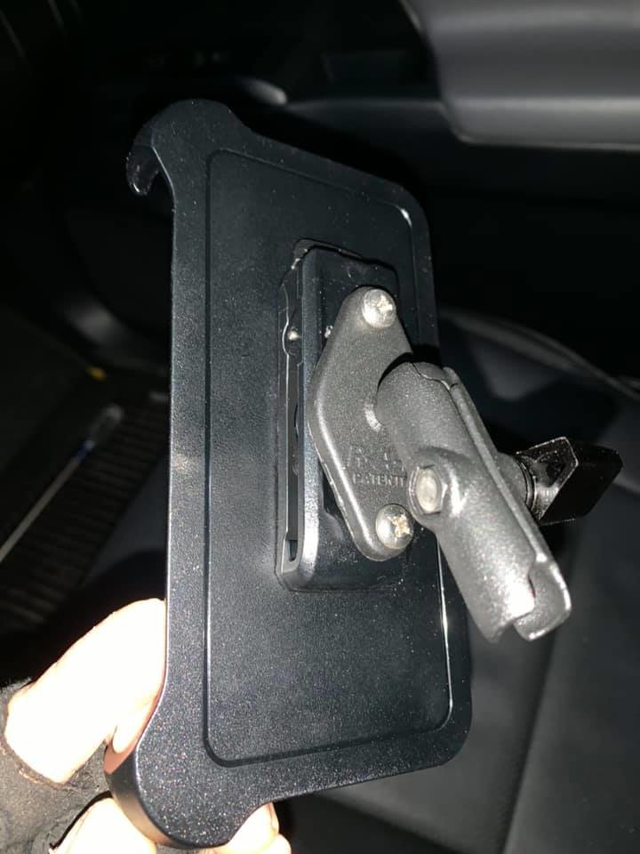

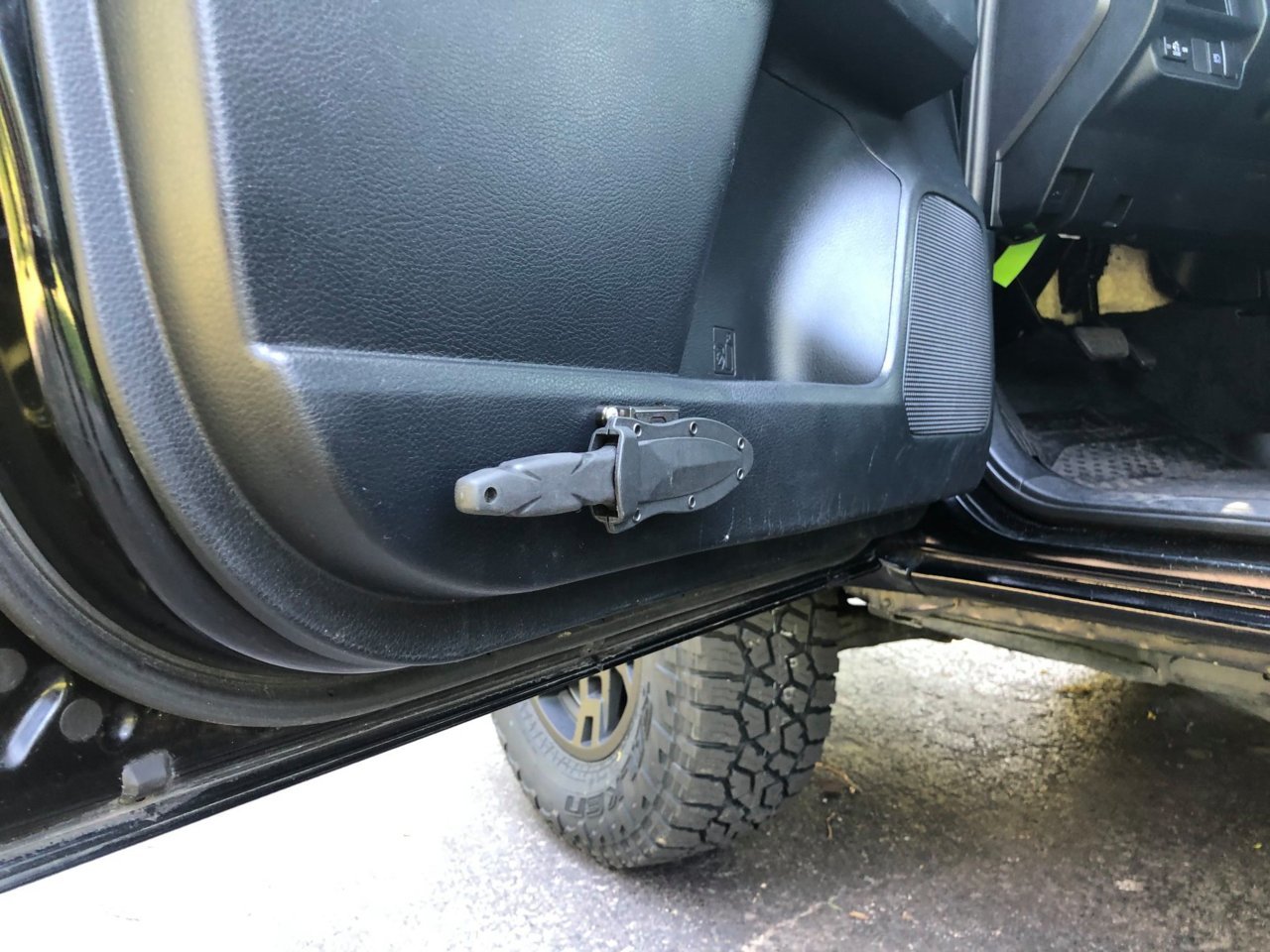

    Also added this little guy to the door and a holster clip to the console along with some OEM floormats (the truck didn't have floor mats so this was a nice upgrade):

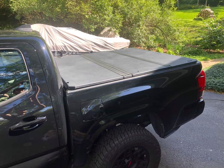

    Somewhere along the way I picked up a used OEM tonneau cover from a fellow Tacoma owner locally. I really wanted a Diamondback but I couldn't justify the additional $1300 over what I paid for this OEM one. So this will do just fine for now...or forever.
    74235584_10158916741704418_7385307011203_b5329f10914ca17bb62547a9e968ce37316d9b27.jpg
    Saving the money on the tonneau allowed me to justify getting the windows tinted and a roof rack (which I was going to do anyway). I ended up going with the Victory 4x4 rack with a light bar cutout.

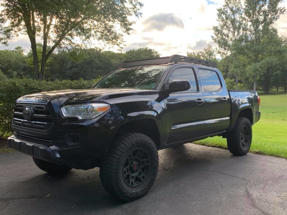

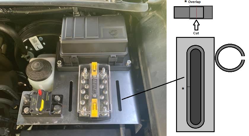

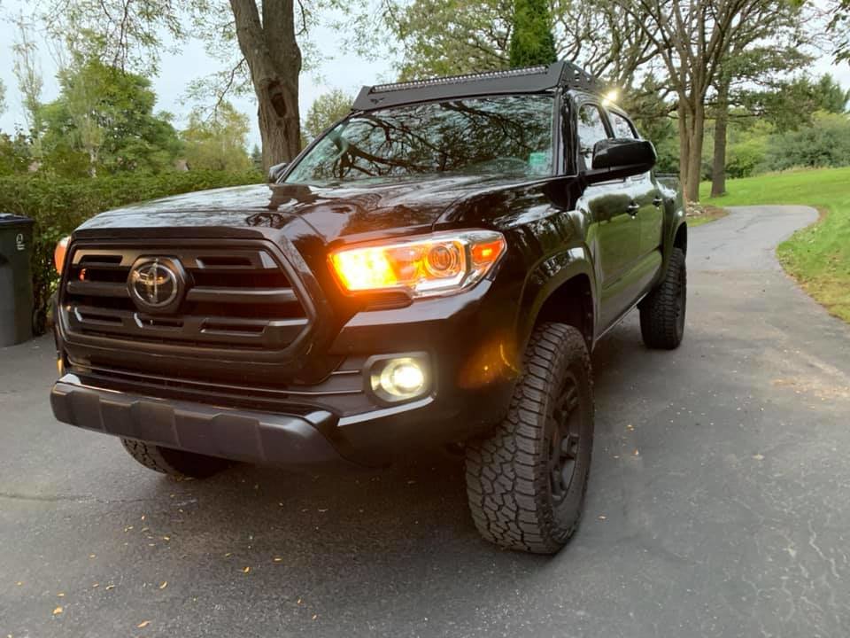

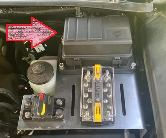

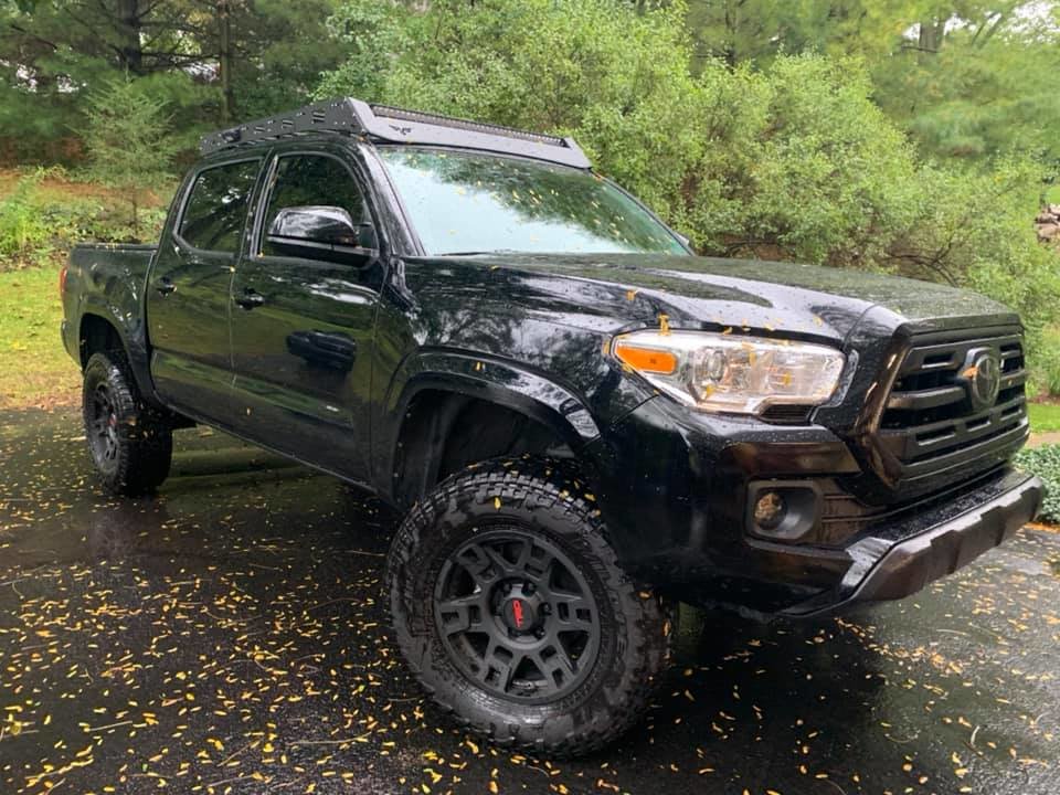

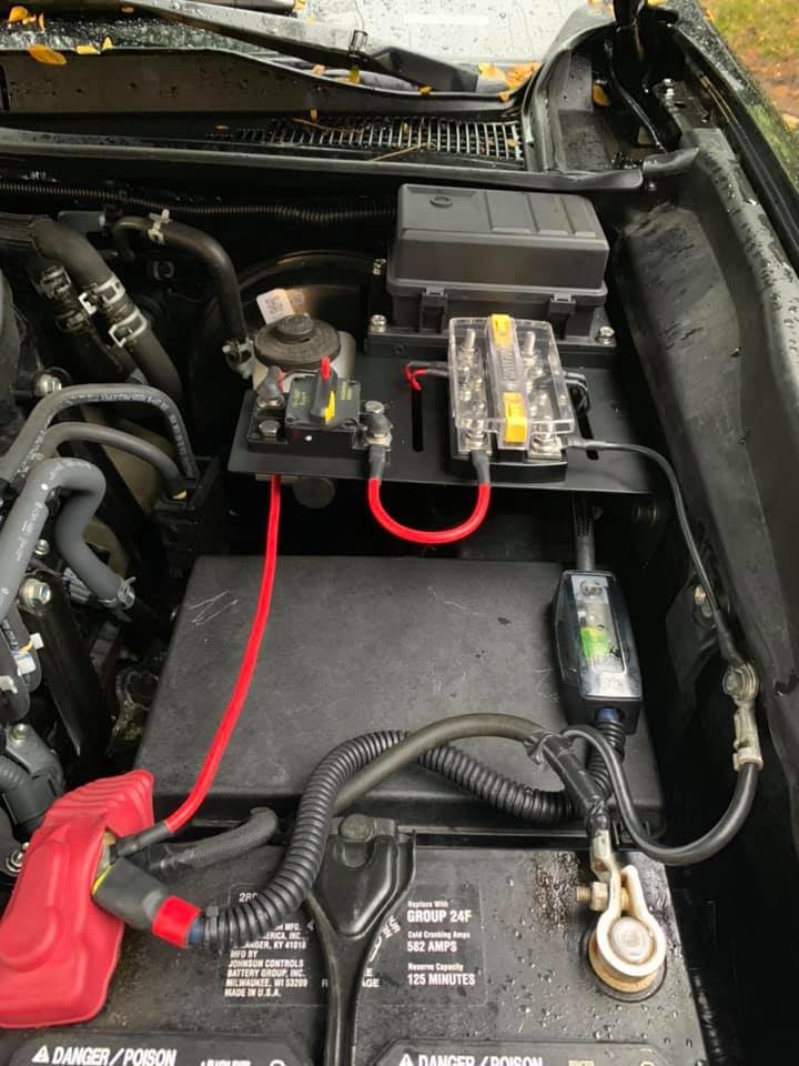

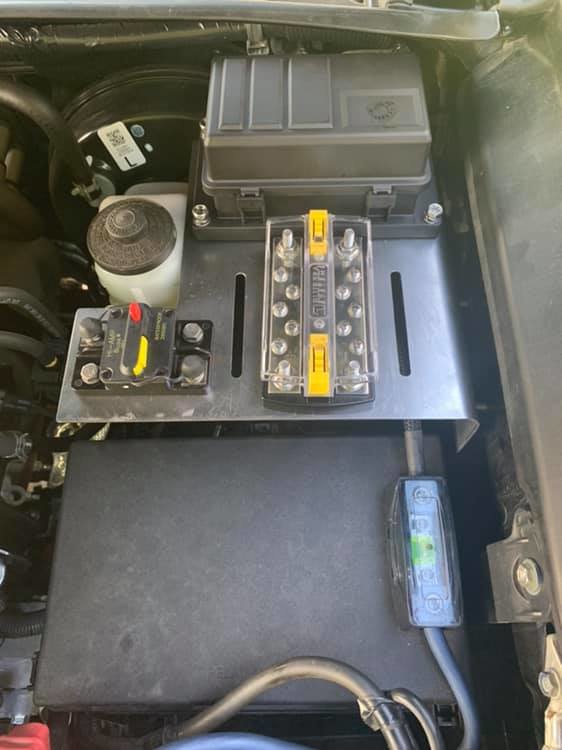

    I wanted to add some scene lights and a light bar to the roof rack and I didn't want a bunch of random relays and strange wires everywhere. I also wanted to avoid fuse taps. Not that there's anything wrong with em I just prefer as clean an install as possible. With that I made myself an auxiliary fuse / relay panel.
    I cut some 16 gauge steel to size and milled out the necessary holes and bent it for mounting to the inner fender using the existing 8mm threaded holes. Then I test fitted it with the components mounted to it:
    73546215_10158916774399418_1070617664788_db0e2ada304c681004d7fac73d41193d3bb160dd.jpg
    Once I had everything where I wanted it I primed and painted the plate and got the components wired up. The relay box holds up to 6 standard automotive relays. For now I added a circuit for a light bar and a circuit for the scene lights. The scene lights will be tied into the cargo light circuit / switch and the light bar will have a Cali Raised switch.
    72135468_10158902582009418_8330107839599_d34f59110134c759ec457d59ec222745c1bb8e26.jpg

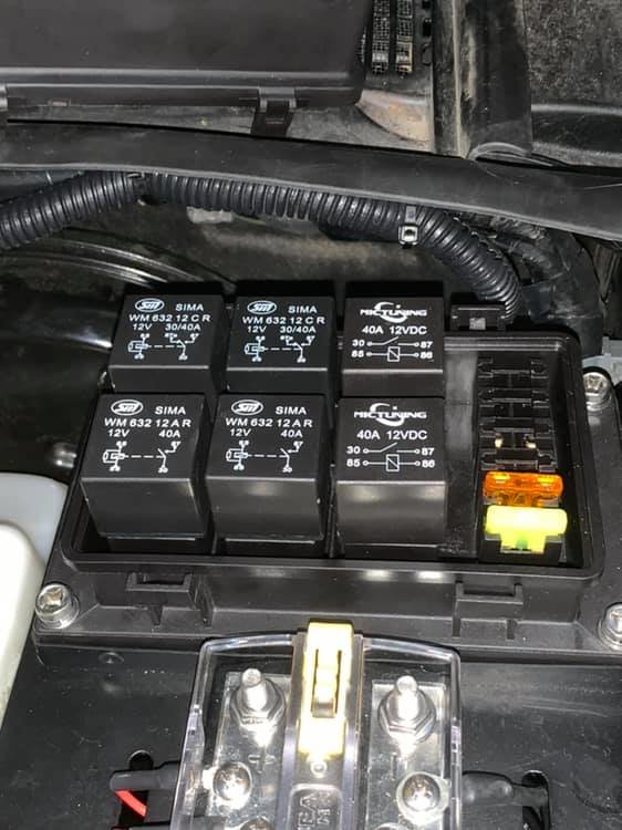

    I'm not loving the power supply wire running straight over the factory fuse panel the way it is but I can live with it until I come up with something better. I'd like to change out the battery terminals to some that have a cleaner accessory mounting post.
    Some pics of the lighting that was added to the rack..as you might notice I also installed fog lights using @Nitori's install thread. I used the OEM LED fogs. Another shout out goes to @caribe makaira for their help with tapping into the cargo circuit for the scene lights:
    72595849_10158902582234418_7061678407951_e09168862a0b0108cff8debb399579c068982548.jpg
    72472149_10158902582169418_4936783247091_3fce489fbe610355b63797871e6a17e5f086fd97.jpg
    72625283_10158902582564418_6025617667774_1f927b8cea7ff36ffd45b4d9e713d585b7deee8e.jpg
    72045994_10158902582579418_3444663199884_a34ba2f4005c2f437166c2258237e671f7df60f4.jpg

  8. Oct 17, 2019 at 8:52 AM
    11,817
    Whatcha going on here?
  9. Oct 17, 2019 at 8:55 AM
    Brofessor
    Brofessor Well-Known Member
    Oct 4, 2019
    #307105
    1,068
    Nice truck.
    motofish84[OP] likes this.
  10. Oct 17, 2019 at 9:44 AM
    motofish84
    motofish84 [OP] Well-Known Member
    Jun 26, 2019
    #297482
    145
    Tyler
    That’s the relay / fuse box I added to house the relays and fuses for the lighting and make room for future accessory circuits. I don’t have any pics of it with the top off or wiring on my phone but I’ll grab one later and post it.
    Here’s an affiliate link for the one I used:https://www.amazon.com/ONLINE-LED-STORE-Waterproof-Automotive/dp/B07MR64XK1/ref=as_sl_pc_tf_til
  11. Oct 17, 2019 at 9:54 AM
    11,817
    Silicon hose (for vacuum type) split lengthwise to cover slot and minimize chaffing of wires...
  12. Oct 17, 2019 at 10:19 AM
    motofish84
    Jun 26, 2019
    #297482
    145
    Tyler
    Good call. I’ll do that
    I filed the edges smooth but I know over time some rubbing could chafe through the insulation.

    Does this wheel and tire set up have a lot of poke on tacomas without fender flares or is it just the angle of this picture?

    I think it’s the angle of the picture. Also the truck was parked on a fairly steep hill and this was the high side. There’s really not that much poke.

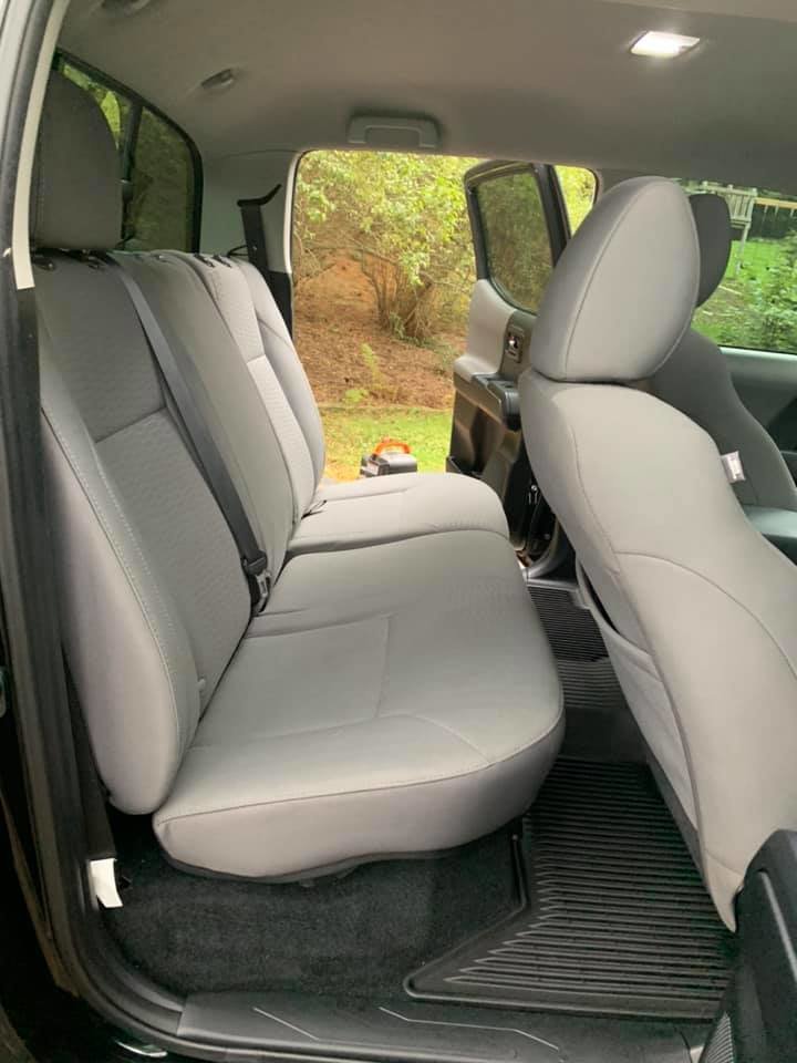

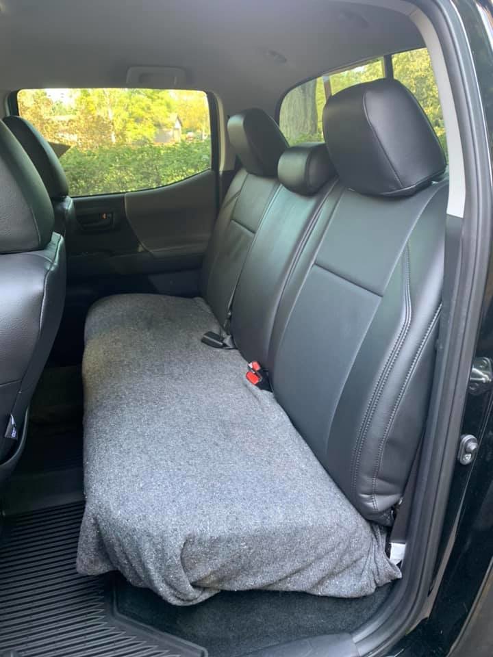

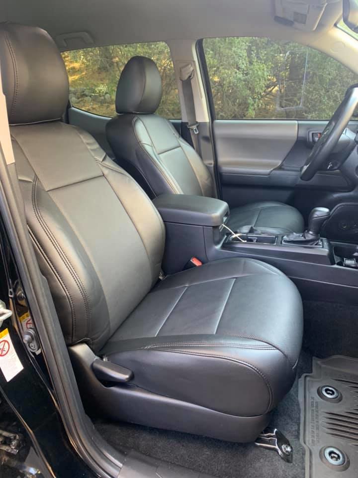

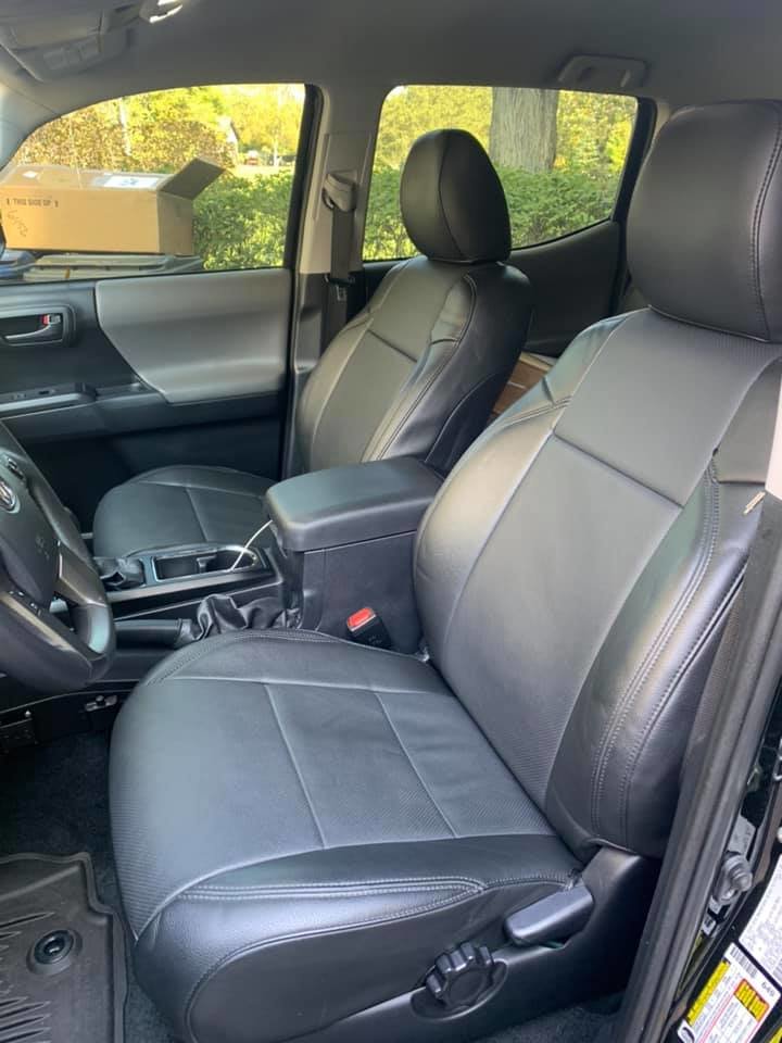

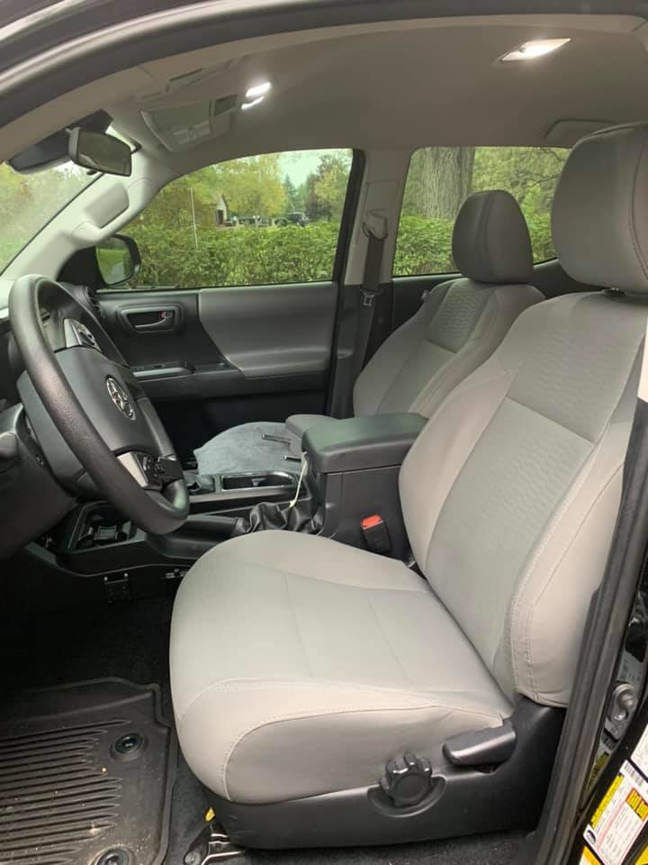

    I acquired a set of very gently used Clazzio covers from another TW member. I've wanted a set since purchasing the truck and the price was too good to pass up. Wisconsin gets pretty cold and crappy over winter so I wanted heating pads in the covers as well. I picked up a set from Amazon and installed them in the covers.
    I got going on installing them in the truck.
    Before:
    73498030_10158902582749418_1024601183316_99161ee5fcf59758821cc22c90598720610c9a70.jpg
    72130239_10158902582879418_7027486014394_a39248dd0fecb64e9dbff43156f0db54ce000ab9.jpg
    After:
    73195202_10158902582909418_3978605463880_645618ae0b2795014c89a7695672edaaf806948b.jpg
    72333008_10158902582944418_8786367399478_55aa5e38816b0416f69cd2abdf3482299c18f712.jpg
    72599810_10158902582954418_5304826304720_495843f17f9ecaefb0ab7ee2ffb018310e681a21.jpg
    Getting the seat covers installed was the easy part.

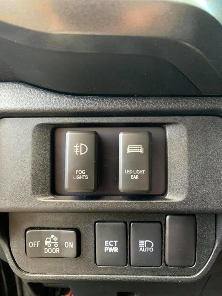

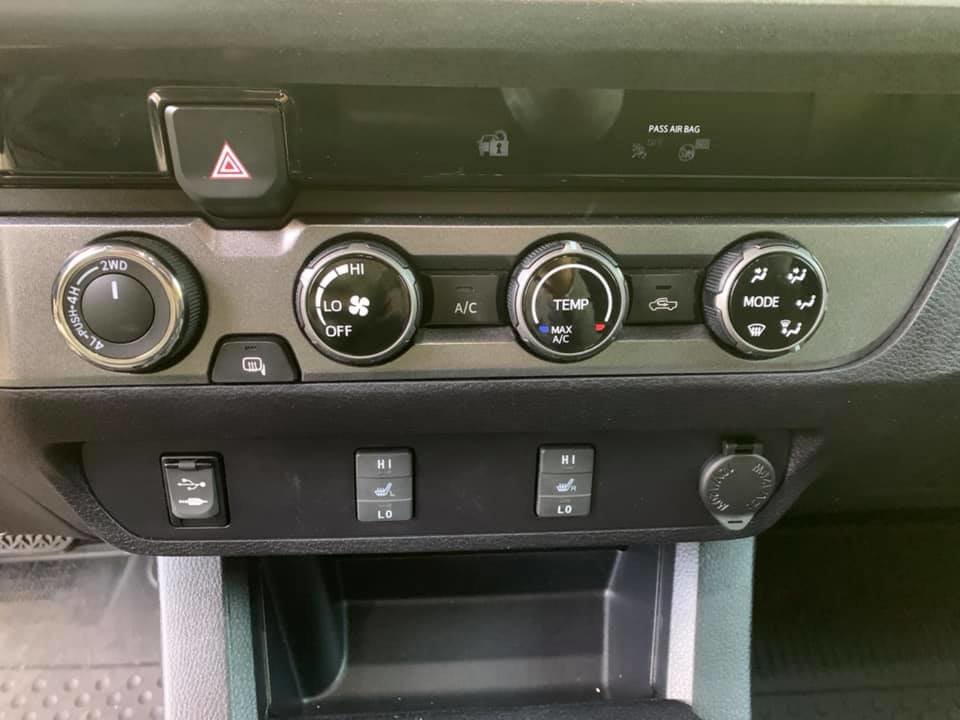

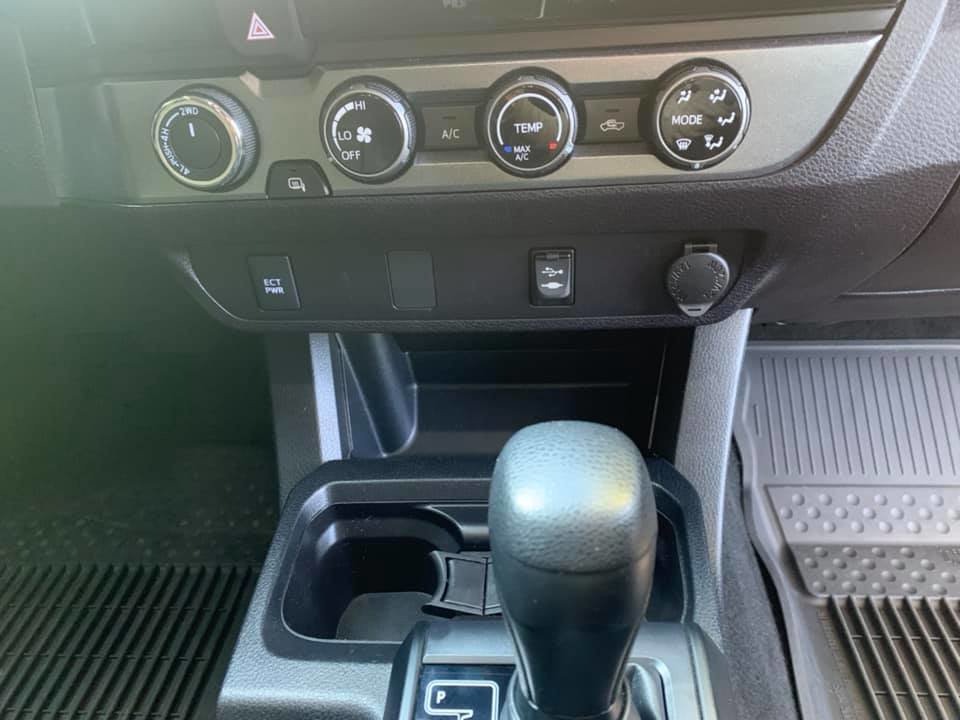

    I wanted the switches centered in the lower dash switch panel. The existing lower dash switch panel of an SR looks like this (pretty basic compared to the upper trim levels):
    72631218_10158902583024418_7770200406650_6862755154a60af939de1f21b54653ce5e3f96af.jpg

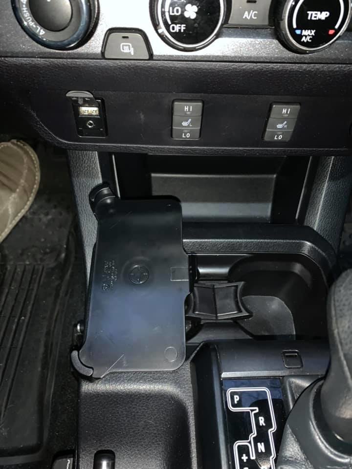

    I wanted the heated seat switches in the two center slots. That meant one of the existing items had to go. I decided I didn't really like where the ECT power button was and splicing wires in for the USB / Aux was too difficult. So I made an extension harness for the ECT button and moved it to the panel at the left of the wheel. I really like where it's located now.
    72758592_10158916704549418_9285518203583_23afdc682043d5bb85d2b49d9ce65722633b6ca6.jpg
    Now that the ECT was out of the way, I moved the USB / Aux to its position and installed the heated seat switches in the center like I wanted. I also really prefer the USB / Aux in its new location. I added a ram mount phone holder to the cup holder that I made by modifying the belt holster that came with my Otterbox case and it reduced the mess of a phone charge cord from going across the console.
    72459344_10158916704584418_3526755748786_d3a64fa28c065f119304eb3c0950bf42ac98c0d8.jpg
    72651092_10158977102569418_7269152167599_06600906ae82fc0bc6e44842278658dff9c9795c.jpg
    74304247_10158977102519418_7664982714444_94eca345fb4a8ed6ecb9c1ca46c1296f846c2f20.jpg
    73357290_10158977102494418_6313311611100_a46c3809fe7b3c55d00a4bf0e41a85f4f19bc39c.jpg

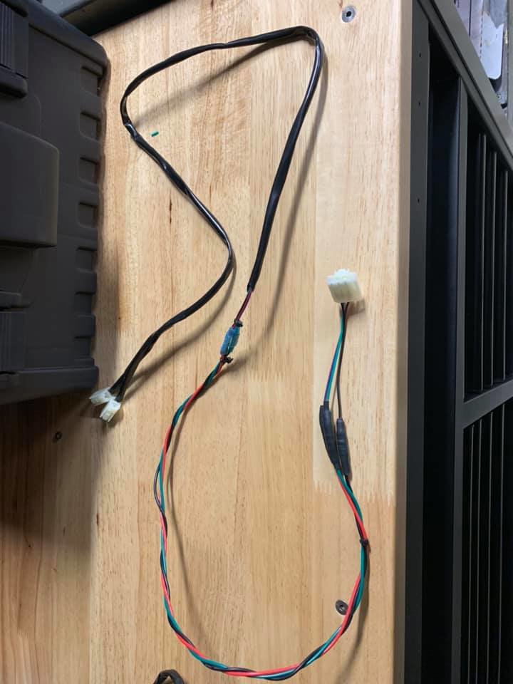

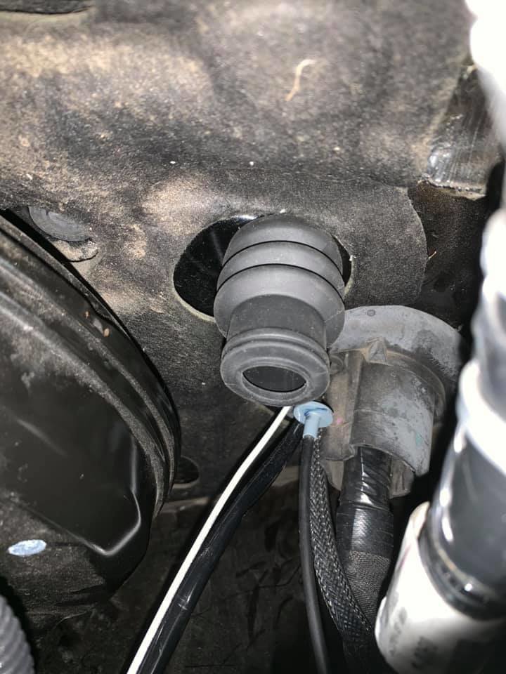

    Now that everything was where I wanted it I had to wire the heated seats. I wanted the 4 relays that came with the kit in the aux relay panel that I made. I have power coming off of the bus, through a 20A fuse for each seat (not pictured) and going to the relay. The switch wire is then fuse tapped through an ACC/IGN fuse under the dash. So the heaters will only be able to be turned on when the ignition is on. The wiring had to be cut and new terminals added to get the relays in place but I got it:
    73472783_10158931049359418_3323044152857_81a39bd8b02e0be1f8780b3005d95925c7095657.jpg
    The existing hole in the firewall was pretty crowded so I had to cut another hole to get all the wires through. I popped a hole using a step bit and added a grommet:
    72893698_10158931049399418_3767054693642_5f190bb03598420e1642d0a70bec05434e5c7f9f.jpg
    All of the wire sets were too short to go from the engine bay to their respective area (switch or seat). I had to cut and splice in wiring to extend all of the harnesses. Here's a pic of one of them:
    72709409_10158931049454418_5535577928118_1059ad64f3364ed85c8fa02d85f57e6774eccfb8.jpg
    All installed and heated seats are working perfectly. Just in time for some early snow in WI.

    Can you elaborate a little more on the ect switch move?
  19. Jan 15, 2020 at 3:37 AM
    motofish84
    Jun 26, 2019
    #297482
    145
    Tyler
    Yann, it's pretty straightforward and took about 1.5 hours at most. I like to take my time with these things as to not booger anything up.
    You do have to remove some of the dash components. I removed the heater control head to gain access to the switch and wires. Once I was able to access I moved the USB. It has just enough slack to make it over to the position closest to the driver. Then I cut the wires for the ECT button, leaving enough (~ 6") on the connector end for later, and spliced in about 30" of wire for each wire. If I remember correctly its a 3 wire set up. Then I routed the wires under the dash securing them in areas to keep them out of the way of anything. Then I pulled the other end through the switch plate on the left of the steering wheel. Once I had them there I spliced the wires to the 6" tail I had off the original connector end. The dash switches all have locating tabs on them that only allow them to fit in specific positions on the dash. This means you have to file the slot in the dash a little to accept a different switch. It sounds a lot harder than it is. You never see any of this on the finished product because its all behind the switch. I had to do this for both the ECT button and the USB.
    Sorry I don't have a write up on this. I didn't think anyone would really care so I didn't bother.

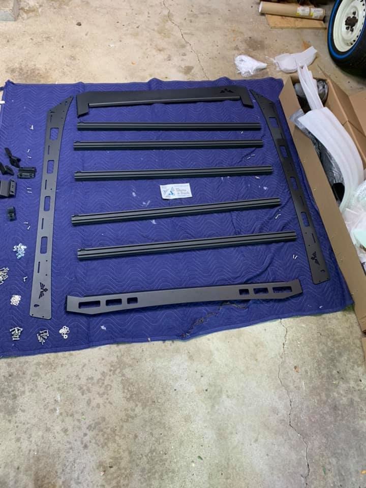

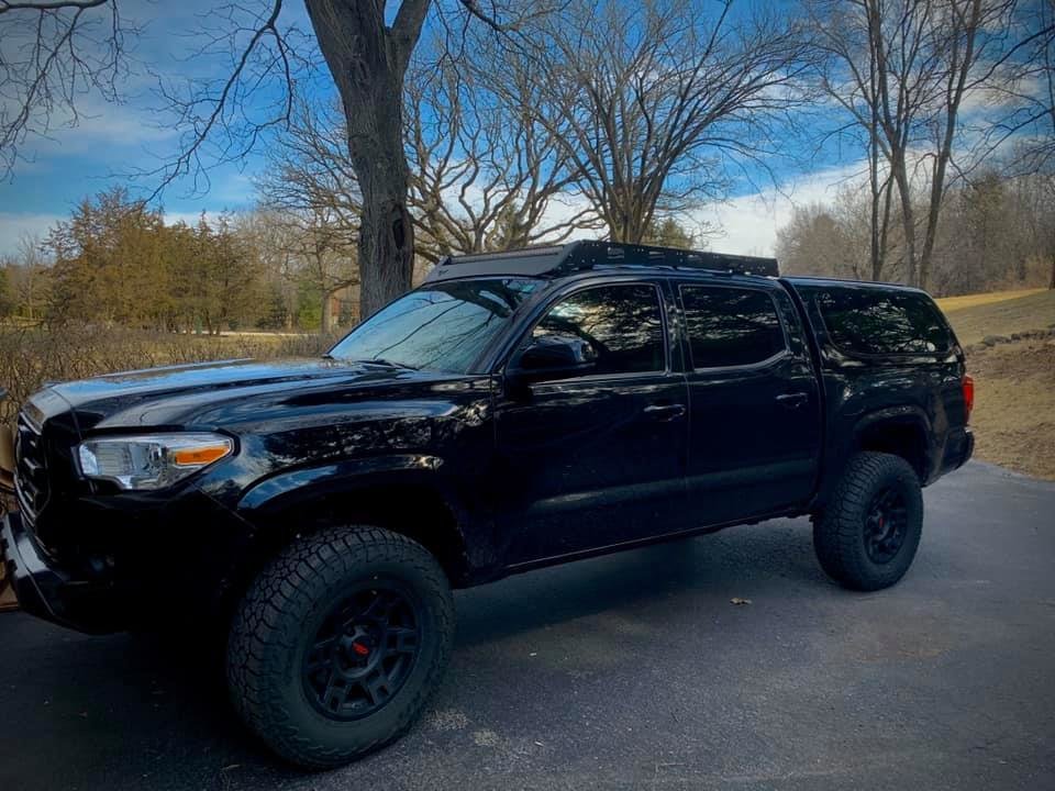

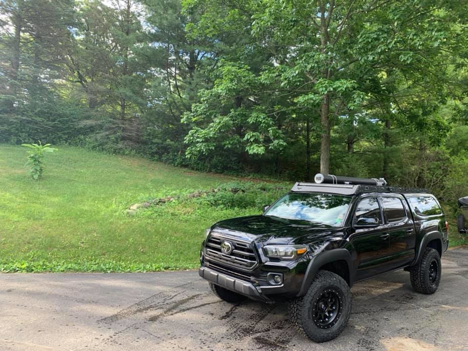

    Added a Leer 100XQ the other day. I'll be adding a @victory4x4 topper rack as soon as I fabricate my own mounts as their mounts restrict you to tracks that are something like 42.75" apart. I assumed that was sort of a standard spread on the tracks but I found out that was not true the hard way. I ordered the Leer with tracks installed which is a $230 option. Then, I went to install my assembled rack and scratched the shit out of my brand new $2800 topper.....Lovely. My tracks are 39.75" apart. Shame on me, I should have measured prior to trying to install as that's one of the first notes in the instructions. As I understand now, the Victory mounts are designed so that the load on the rack is distributed evenly whereas other company's support only two of the crossbars. I understand that thinking because a lot of folks want to put an RTT on it. Honestly, the Victory cab rack has been really nice and sturdy and I think it's the nicest looking rack in that style. They've also been pretty fair up to this point. That said, I wouldn't know that if I hadn't run into issues with their products. There are a few things that I keep going back to that are a little annoying. The quality of finish leaves a little to be desired as there were multiple people including me that got parts that had spotty powder coating and burring on edges and cutouts of the racks. Their transparency in correcting the previously mentioned issues was a little strange. The price of the topper rack is more than the roof rack (even with a substantial discount) and uses far less metal with less features / bends etc. Maybe it's a supply and demand thing? And finally, this bracket issue....I contacted Victory and suggested 3 options, one of which they agreed was probably the way to go and have done in the past which was use 4 of their RTT mounts to mount the rack but they wanted another $70 for them even after I offered to send the mounts back that came with the rack. Additionally, I don't even know that they would have worked because they are only 7/8" tall which would make the topper rack lower than the cab rack. Maybe I'm being unreasonable but I don't think so.
    In the end, I decided to make my own mounts based on something I saw another member do. I'll post more about the mounts later when I install the rack. For now...here's a shot of the Leer 100XQ on the truck..sorry its a bit dark. Again, I'll post more pics of it with the rack once installed as well as the DIY bed lights I rigged up.
    91033129_10159513041829418_5838306305680_1ba3c1a694b38d7efdd5a3d85ce1f1c9c422aafb.jpg
    As for the topper, I am really happy with the look. I will say the hinge design on the back window is the only thing I don't like. It seems basic and flimsy. I much prefer the ARE style hinge. But I don't think there is a better looking topper than the Leer 100XQ for the 3RD gen Tacoma. I know a lot of people prefer "Windoors" on the side but the windows on the XQ just look so damn good to me.
