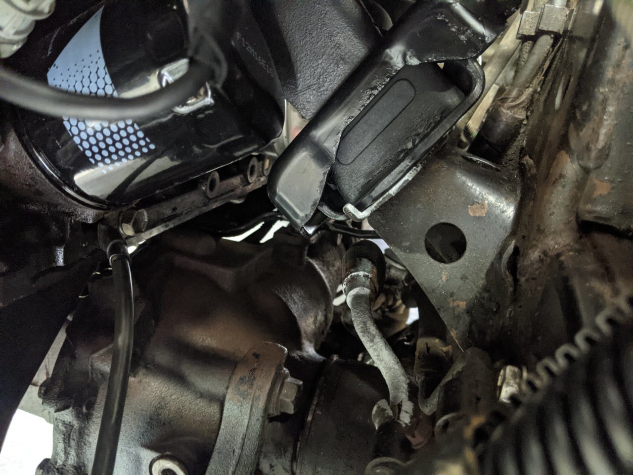

    so see how the rubber (actual replacement mount) is curved. I am wondering if it should of curved in the other direction when i put it on

    Looks like there in right, are they left and right, different part numbers?
    I’d try taking some weight off them and use a short punch in one bolt hole to see if you can line up another hole and work your way around, if there aftermarket mounts they aren’t always exact match’s and can be a be a bitch sometimes.

    yeah so I had to lift just one side of the engine and smash the side down. driver side are both on. managed to realign one of the pass side bolts by jacking up the transmission a little. The bolt by the ac comp is off about half way I think I am just going to let it settle and let the mounts squish a bit (since im not going hunting or camping until cooler months) and hopefully it naturally begins to line up a little better.
