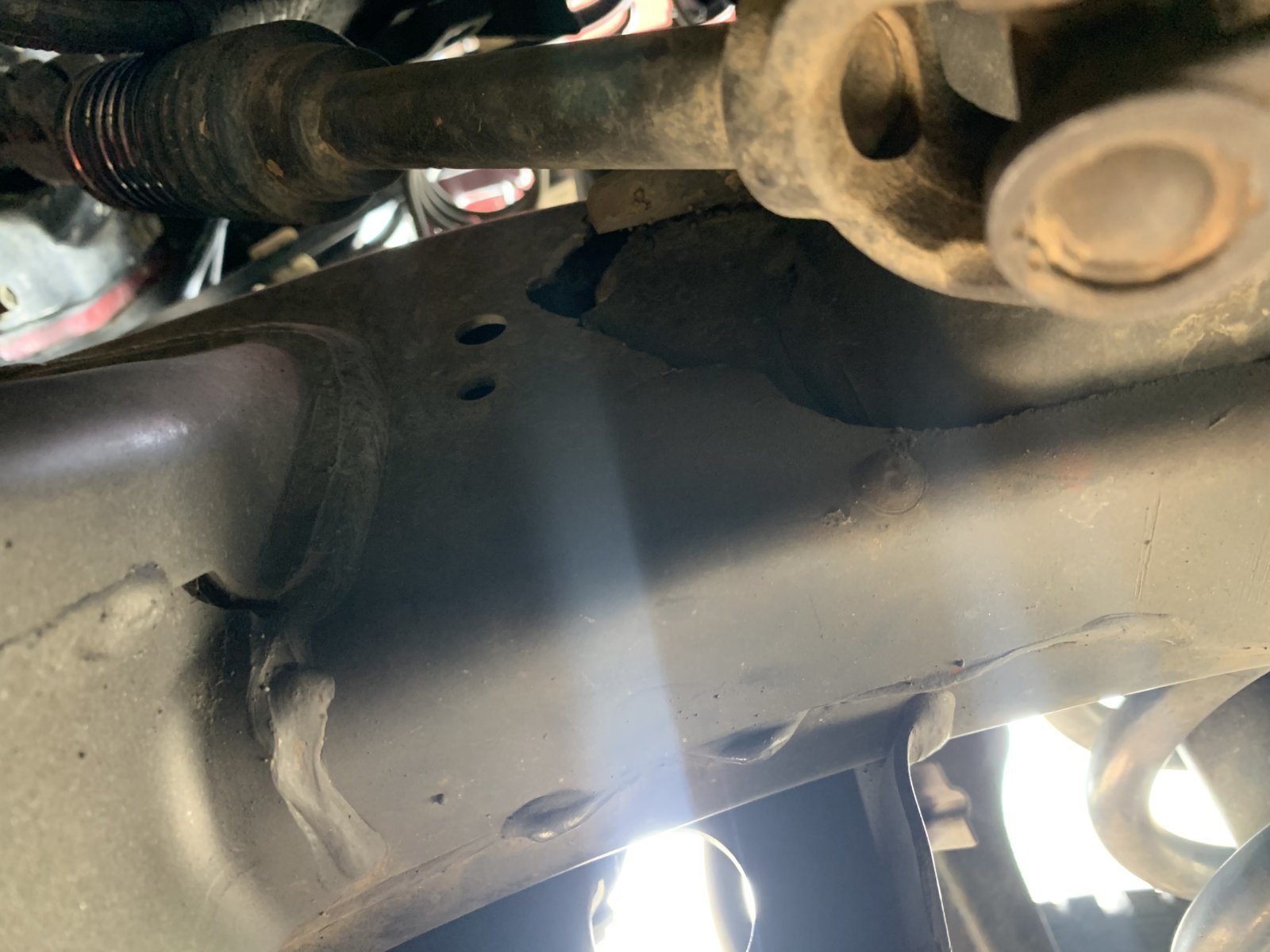

    Figure out my frame broke but I wonder why? Will I need to weld it or what can someone help me!

    Was that replaced or original? Sure looks clean..

    Early years are said to do that
    People have fixed it, idk how. If they welded. Or put reinforcement plates also welded.
    one reason why I got Solid Offroad mounts that don’t bounce around like my old stock mounts to hopefully prevent this
    I came from the Audi world that had a ton of options and was surprised to see the Tacoma did not.
    For example say you have a B6 A4. Well, you’ve got to pick from better mounts:
    -febi bilstein b5 s4
    -various solid mounts
    -034 track density
    -034 street density
    Etc
    as opposed to stock crap
