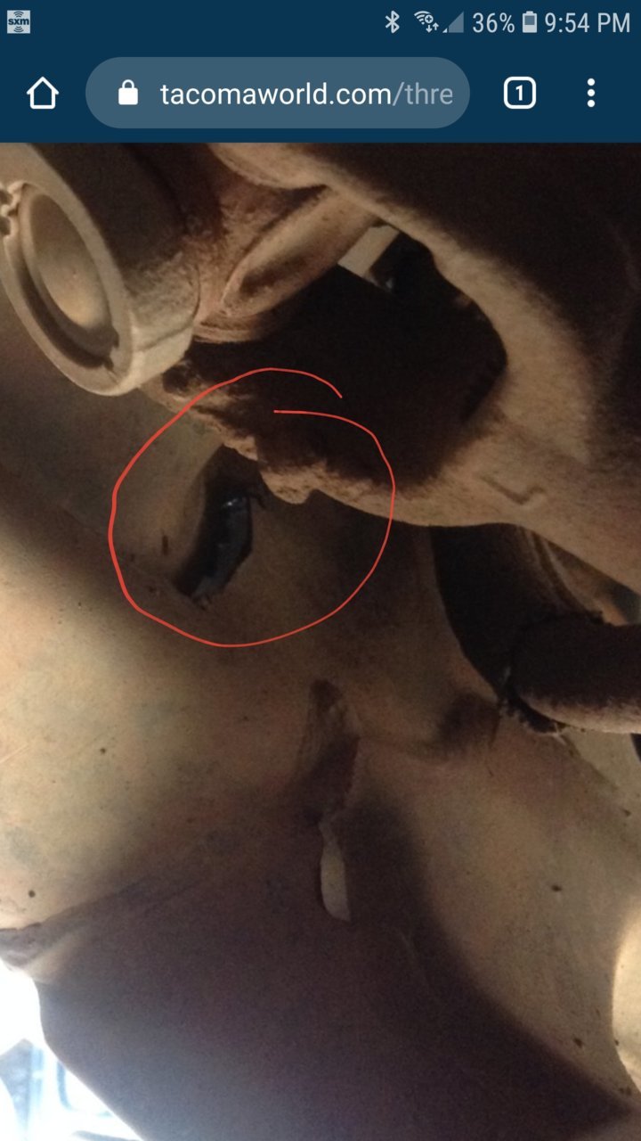

    So this happened, make sure to reinforce motor mounts if you wheel, or if you have an 05/06 at all
    Frame shop is going to fix it soon, will post costs and other info once job is done

    Damn that's not good! I think those of us that have updated replacement frames are in the good but still not a bad idea.

    5 lug? Wow. I've only heard of that happening to V6's that are pushed hard.
    But yeah, well established issue for 05/06, and POSITIVELY fixed from half way through 06 and newer.

    5lug thing is a joke, it's a v6

    I'm going to get That once I can afford to have it installed, as well as all the other frame reinforcement pieces

    I tried to get it replaced through Toyota but there's no rust and it has "too many miles"

    So are we looking at this ^
    This passenger or drivers side?
    I'm not sure, sorry?
    Because I want to go look in the morning

    Drivers side. If you really have a 2011, you don’t have to worry. The problem only existed on ‘05- mid model ‘06 year.

    Yes, drivers side
