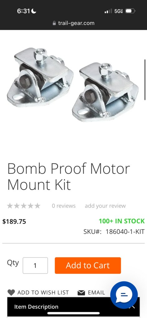

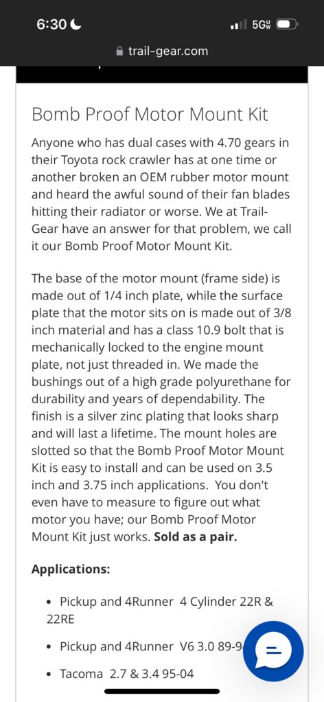

    Offroad solid motor mount designed has no pin, just saying…
