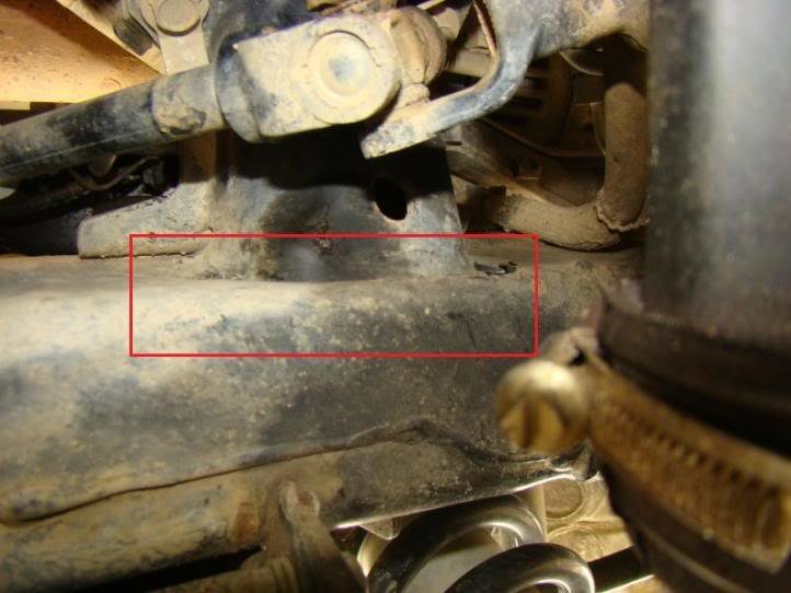

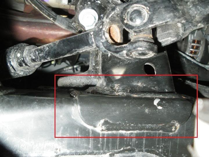

    Here’s a side by side pic. First one is an 05 and the second 06+. Toyota noticed the problem and silently fixed it. It’s a somewhat common problem.
    R0dzilla75, DoorDing, lo2hi and 3 others like this.

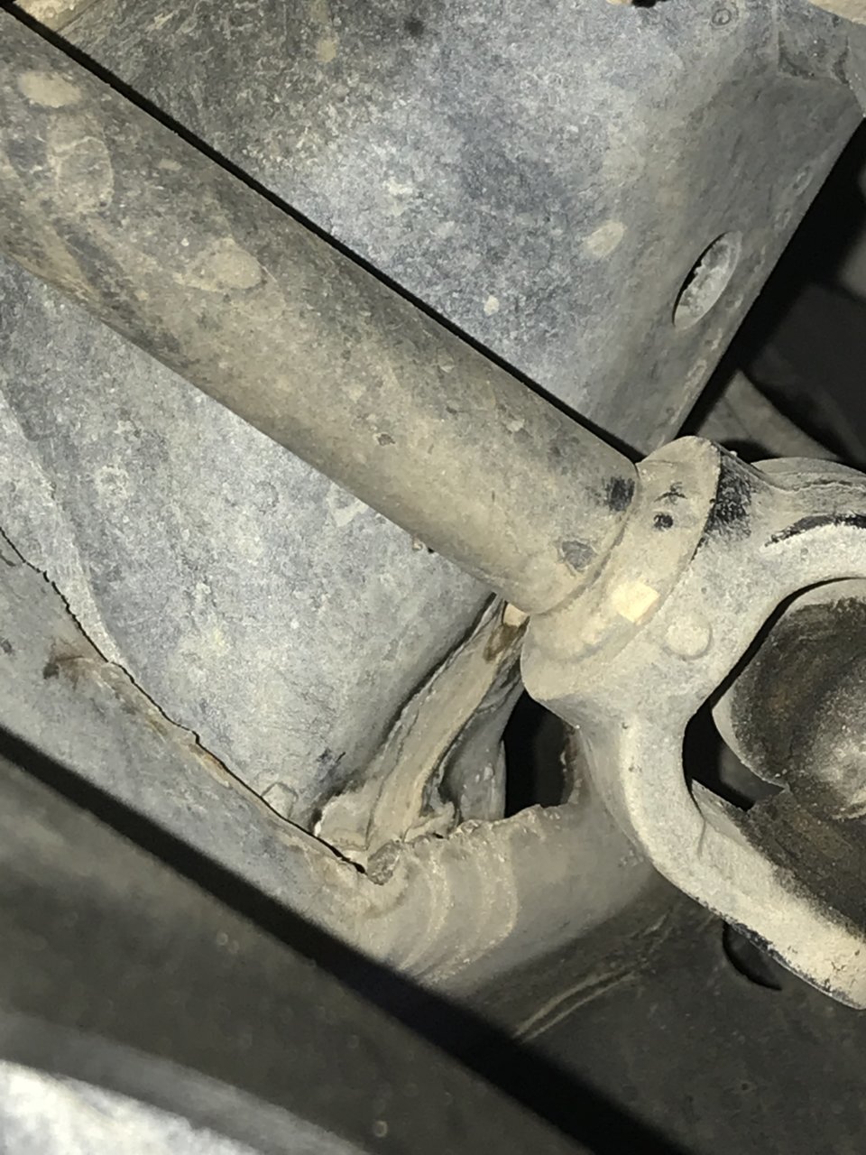

    #16
    Ceddingermtb
    Ceddingermtb [OP] Well-Known Member
    Feb 17, 2017
    #210817
    437
    Caleb
    Lake Arrowhead CA
    05 trd off-road dscsb
    Here’s a pic of mine, the whole thing is totally f**ked4957EF7D-CD15-4834-A811-710AE323A55F.jpg
